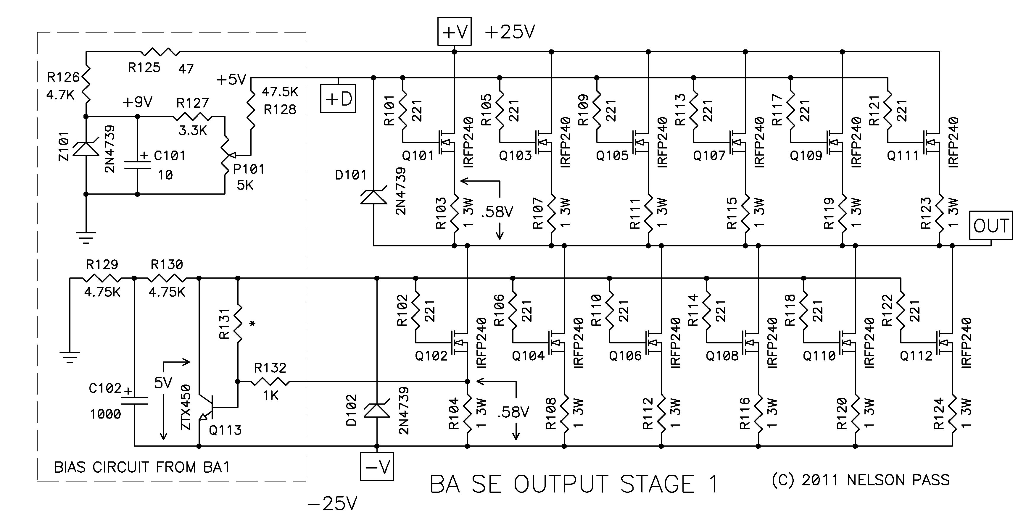

So first, some housekeeping. The official BA-1 and 2 front end now looks like this:

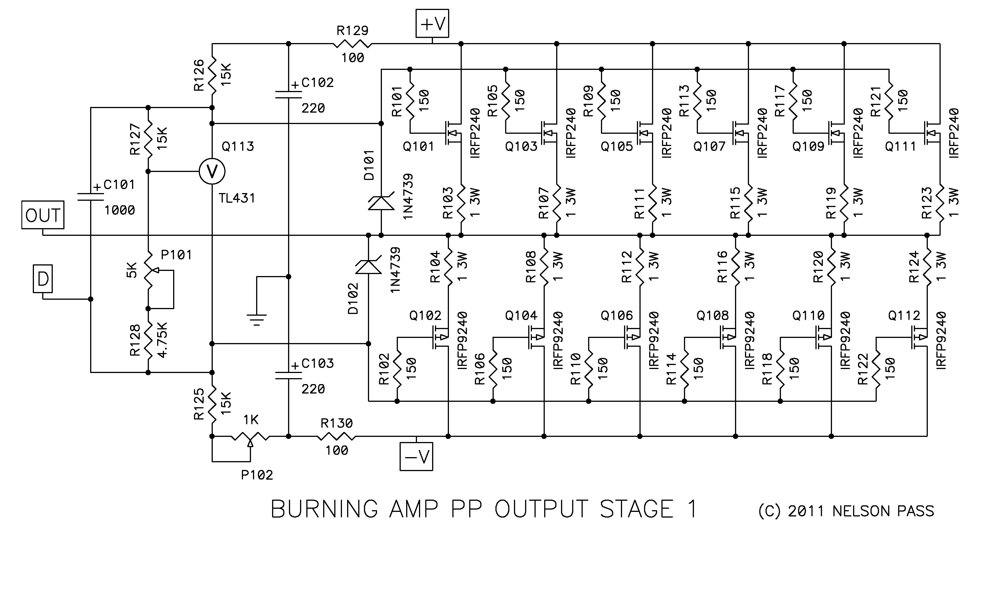

The official BA #1 single-ended output stage now looks like this:
And the official BA #2 push-pull output stage looks like this:
Both of these circuits now include the necessary components to bias the output stages.

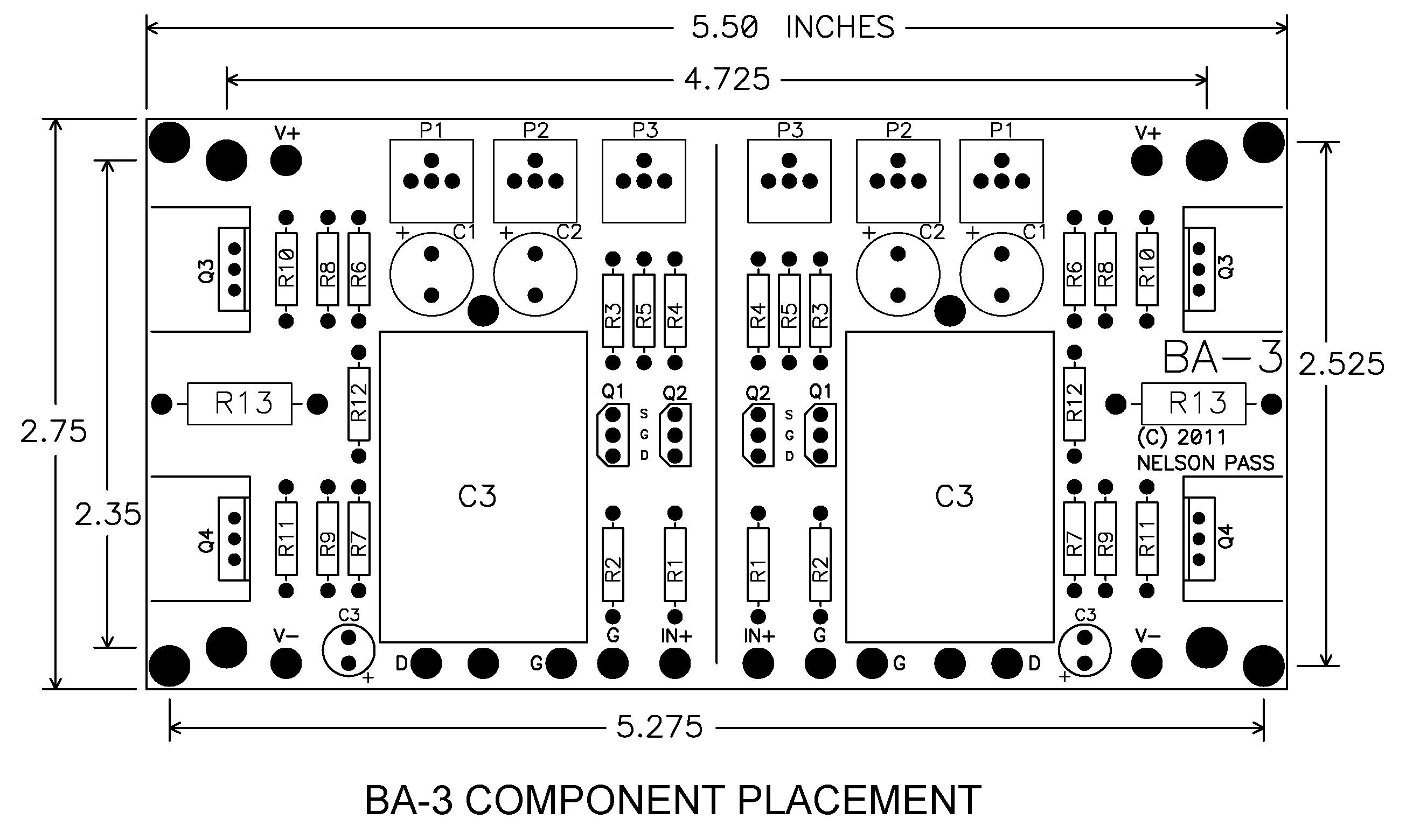

DIYAudio.com will be offering the authorized printed circuit board for sale. Anyone is welcome to cobble together their own for non-commercial purposes, that is to say not for sale.
Here is the trace diagram of this board:
Here is the component placement:

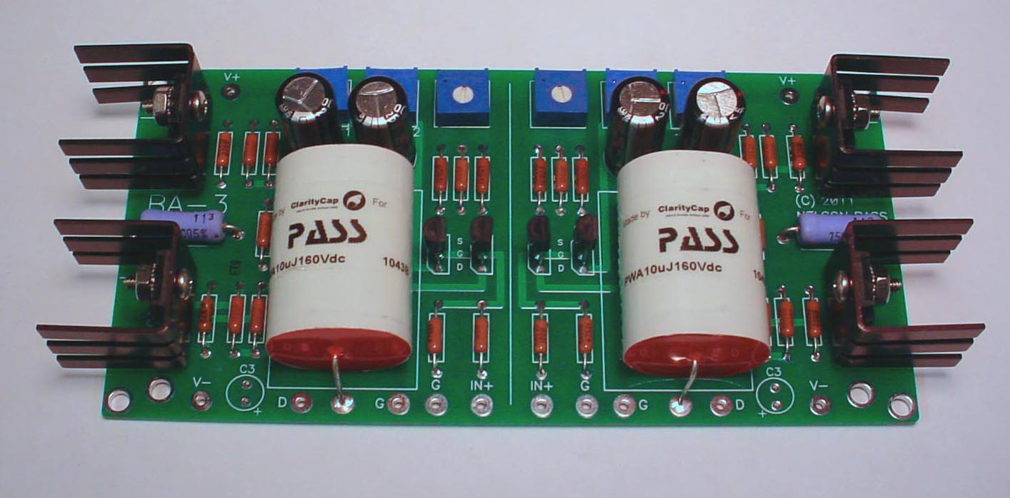

Here is a nice photo of the board which I assembled all by myself:
You may note a few items. I have made an allowance for two different C3's on each channel, one the polypropylene capacitors in white and another an electrolytic which you don't see stuffed. You may use either or both.

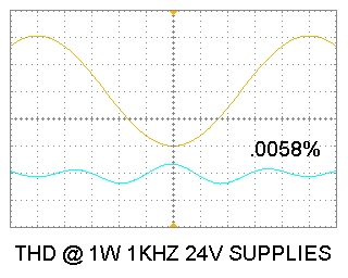

The data following are for a circuit with the parts and bias as shown and with P3 set for minimum distortion. Here's the distortion curve of the BA-3 front end vs output watts (as if it is driving a perfect follower output stage)
With the second harmonic largely nulled by P3, we see the following distortion waveforms for the circuit at 2.8 volts output without a load (although you will note that the circuit already has its own 332 ohm load to ground). Here it is with +/-32 volts rails:
And below is the same, but with +/-24V rails:
You can clearly see that the distortion in this case is mostly third harmonic. Adjustment of P3 will bring the second harmonic out, and as you turn the wiper toward the Source of Q1 you favor the positive going waveform. When you turn the wiper toward the Source of Q2 you favor the negative going waveform. Favoring the positive going waveform is possibly preferred – with proper speaker polarity, this mimics the acoustic character of air.

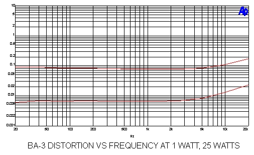

Here's the distortion vs frequency at 2.8V.
Not much to say here. This was taken with a 600 ohm source. It gets a little better with a 25 ohm source, but that's not to say it sounds better.

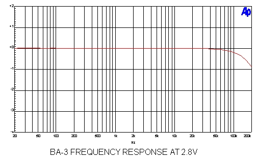

Here's the frequency response curve at 2.8V, also with a 600 ohm source:

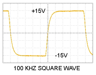

Here's the square wave response at 15 volts output:
