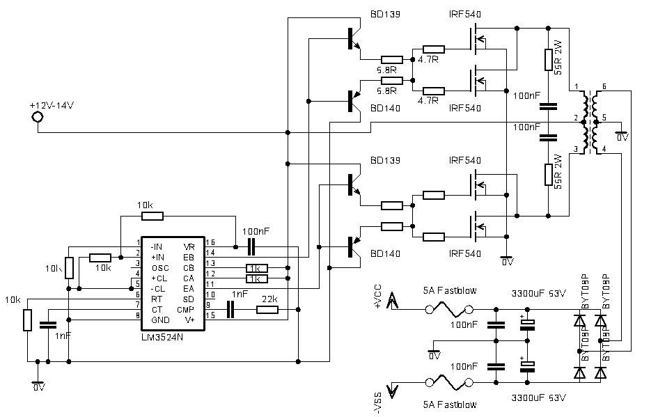

Hi there
Quick question. I have breadboarded a smps I have designed by picking bits up here and there. It is unregulated, but I'm not too worried because it's for car use. I plan to build two of these smps's and use them to drive a leach amp each, which I have already built (I can't praise this amp enough).
The problem is, I get an acceptable waveform from the push-pull stages, and the FETs switch, but they get so hot I could fry an egg on them. I tried increasing dead-time by increasing the timing cap like it says in the app notes of the sg3524, but still nothing. Have I wound the transformer wrong?
My osc runs at 50KHz btw. The outputs overlap at ground (or near ground) potential, but there is a fair amount of deadtime between the high states of each output. I've used the core from the current choke on the +5v line in a PC smps as my transformer core.
I have wound 5+5 turns on the primary and 10+10 on the secondary in the opposite direction. I know this will give me the wrong output voltage for leach amps, but this is just testing atm, not the "real deal". Can anyone help?
Thanks in advance.
Gareth

core saturation would be my guess as well
I would agree that core saturation is very likely the culprit. With a push-pull converter, the transformer core is being subjected to a volt-second (flux) ramp in both directions. If the two FETs possess unequal on resistance, or slightly differing pulse widths due to delays in the PWM controller, the volt-seconds in one direction will be unequal to that in the other direction. The core magnetic flux will creep positively or negatively into saturation. One method to prevent this is to use a series blocking cap. Better yet, a current-mode controller would sense and limit both volt-seconds and amperes, preventing saturation. Unfortunately, the LM3524 is a voltage-mode controller. Also, if the core is from a power inductor, designed to carry dc, it more than likely has a gapped core. This is not desirable in a transformer because the magnetizing current increases as a result, increasing conduction losses. Also, power is lost due to the gap. The right core geometry should be used (low leakage inductance), and the right material should be selected (ferrite, or at 50 kHz, a low frequency for an SMPS, maybe tape-wound nickel-iron is suitable), and no gap should be used (other than the small incidental gap which is inevitable when mating two halves of core material). The windings should be constructed for minimum leakage inductance, and low skin effect. Also, the full bridge rectifier is not used in the push-pull, but rather, the full wave center-tapped, followed by a power inductor, followed by the filter cap, for each output. App notes cover this. I hope this helps. Best regards.

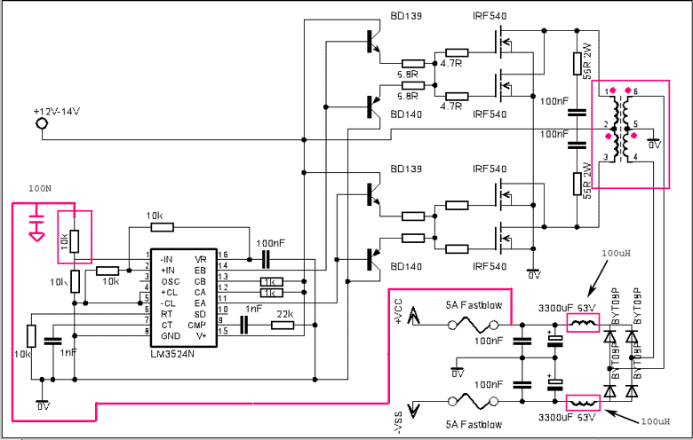

I drew in the error amp circuitry. if you make the drawn in resistor adjustable you can adjust the duty cycle of the LM3524.
I guess I have the inductors where Claude wants them.
3300uF is probably overboard -- I suppose that since you haven't used the "regulator"portion of the LM3524 there may be a reason for this. at any rate, such a high capacitance value just swamps the ability of the error amp to resond to changes in line voltage, etc.
i should have specified that the resistive voltage divider going from V+ to the LM3524's error pin should provide enough voltage for the duty cycle you want. I use these chips for driving a bigger H-Bridge for DC motors so use an adjustable pot in this position.

I think you're right about the core saturating. That would explain why the fets are dissipating so much. I tried turning down the dut cycle, that worked a bit, purely becuase the fets were turning on less often. This doesn't help me though..
I'm going to get a small toroidal core in the next few days which should work if that is ideed the problem. btw, for reference, what exactly do you mean by transformer orientation? Do you mean i must use the correct wires to energise the correct windings? fair enuogh.

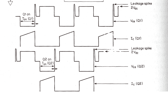

Here's a graph snipped from Pressman's book ("Switched Power Supply Design") on the inductance leakage spikes:
The core used in coupled inductors in AT and ATX power supplies are made of iron powder
They have very low permeability and are intended to make power-storage inductors to be used in buck or boost regulators [or in the secondary side of the transformer if you want regulated output]
These cores are not suitable to be used as transformers in simple magnetic coupling circuits, for that purpose you must use a ferrite core
MOSFETs heat a lot simply because they are conducting lots of current due to low core inductance but very little power is drawn from the 12V supply as current is cycled in both directions from/to core and supply capacitors
Simple magnetic-copupling SMPS need no inductors in the secondary side, both sides are simply coupled like primary and secondary in a 120V or 230V AC transformer with its output rectified
Altough inductors are necesary only if supply has to be regulated, a pi filter is recommended to filter the ripple caused by diode switching and capacitor discharge during deadtime on the output
The core is saturating. If you are using a iron powder core for the transformer, you are definitely using the wrong material. When you design the transformer follow faraday's law. You must know the DC input voltage that you are switching, the operating frequency, the cross sectional area of the core, and from that you will calculate the number of turns and choose the operating flux. At 50kHz operating frequency and some sort of push-pull topology, you should design the operating flux to be around 800-1000Gauss so that the core losses are minimized. It is also possible even with a soundly designed core to saturate it over time. By using a topology that traverses the core's B-H curve in the first and third quadrants, the core can "walk" up the curve if each half cycle is not an equal and opposite Volt-second product. You can get in touch with me if you want help in designing the transformer. I also have some ferrite toroids that I could sell to parties interested in the USA.
