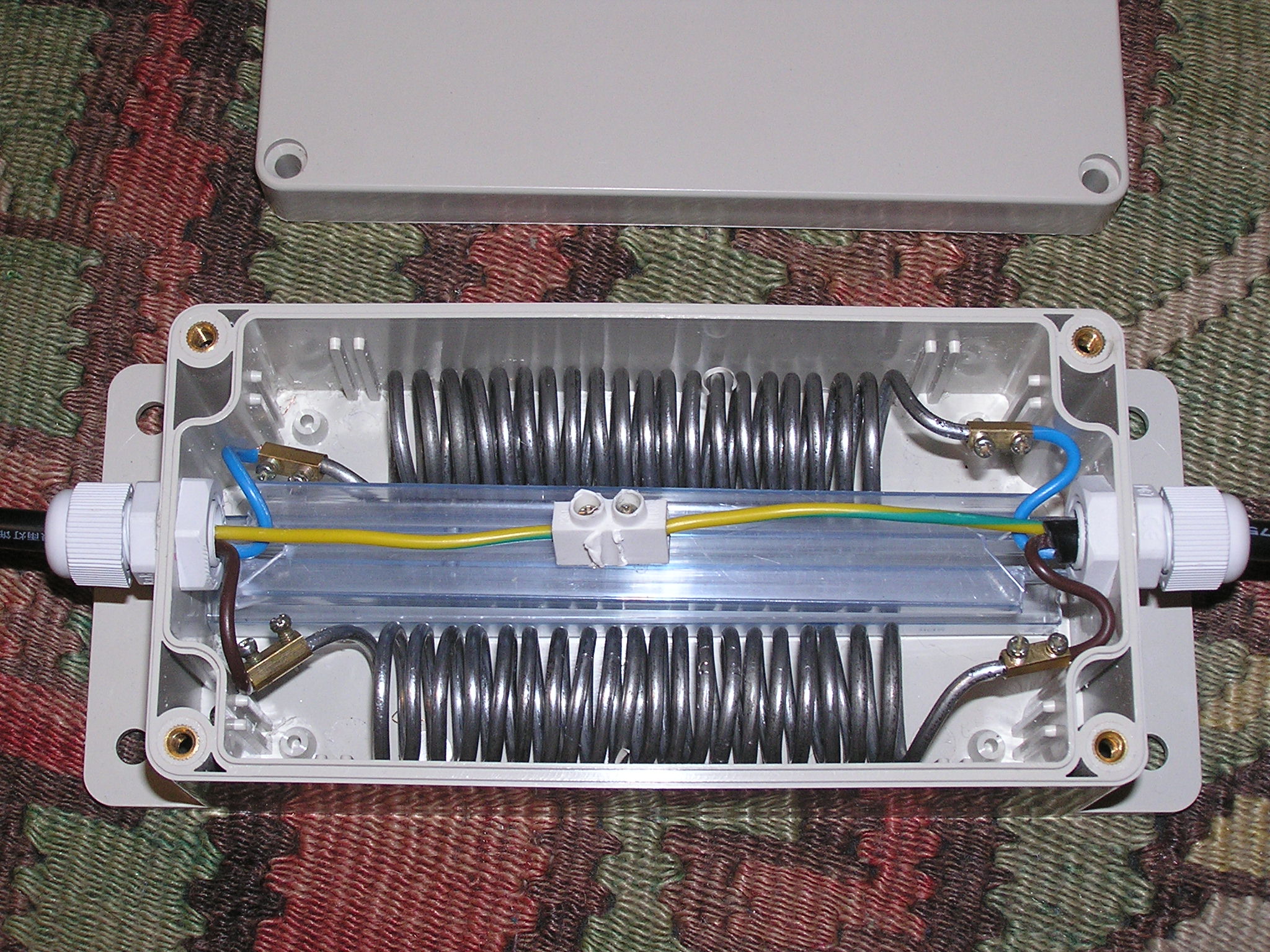

So, in the meantime I've been experimenting with wire I have been able to get hold of, which is shiny steel. It turns out that only 30 paces from my home is a hardware store which sells it - so I've tried winding chokes with it, just to see what happens. I've also acquired an LCR meter to see what kinds of values I'm getting at different measuring frequencies.
The first pair of chokes I wound with some really thick stuff - 2.8mm. Having aimed for 20 turns...
