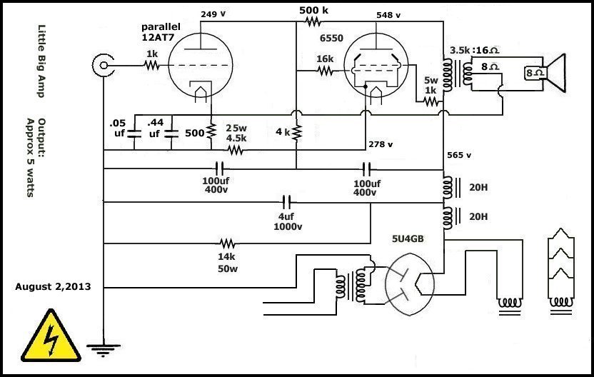

I read a paper by Hawksford and Mills concerning current drive for loudspeakers and they found a feedback scheme from the secondary of the output transformer raised the output impedance (which is what I was hoping for) but was dependent on frequency.
As far as I could understand this scheme gives a boost to the low frequencies but then gives continually lower output as the frequency increases. This is exactly what I found with my feedback scheme using one of the taps of the output transformer secondary as a speaker center tap and then sending that to the cathode of V1 here:
![Click the image to open in full size.](https://www.diyaudio.com/forums/blogs/homeskillet/attachments/1118d1375684747-little-big-amp-page-2-little-big-amp-aug.-4-2013.jpg)
I included the small value bypass caps to the cathode resistor of V1 to offset this and bring the high frequencies up. The response is not "ruler flat" with the addition of the caps but it doesn't seem to vary much and then starts to dip past 20kHz to 40kHz.

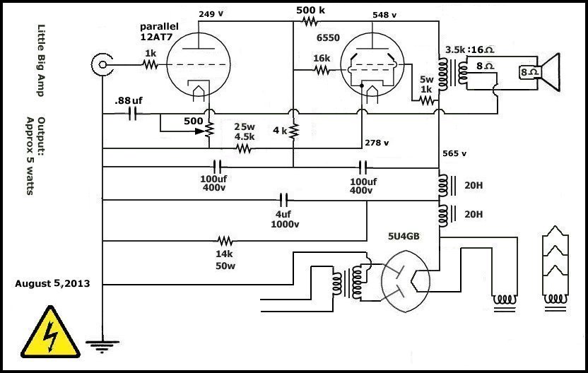

Mills and Hawksford found this to be less than optimal but then I saw an opportunity for a tone control. Since I had a pot serving as the cathode resistor of V1, I connected the bypass caps and the feedback return to the swiper and used the full 500 ohms as the cathode resistor which I was anyway.
This works quite nicely and doesn't sound too bad. I found I enjoy being able to set it where it "seems best".
I keep wanting to put this circuit away but it keeps drawing me back in.
Here it is with the new fangled "Variable Output Impedance Tone Control".
![Click the image to open in full size.](https://www.diyaudio.com/forums/blogs/homeskillet/attachments/1119d1375764061-variable-output-impedance-tone-control-little-big-amp-aug.-4-2013.jpg)
