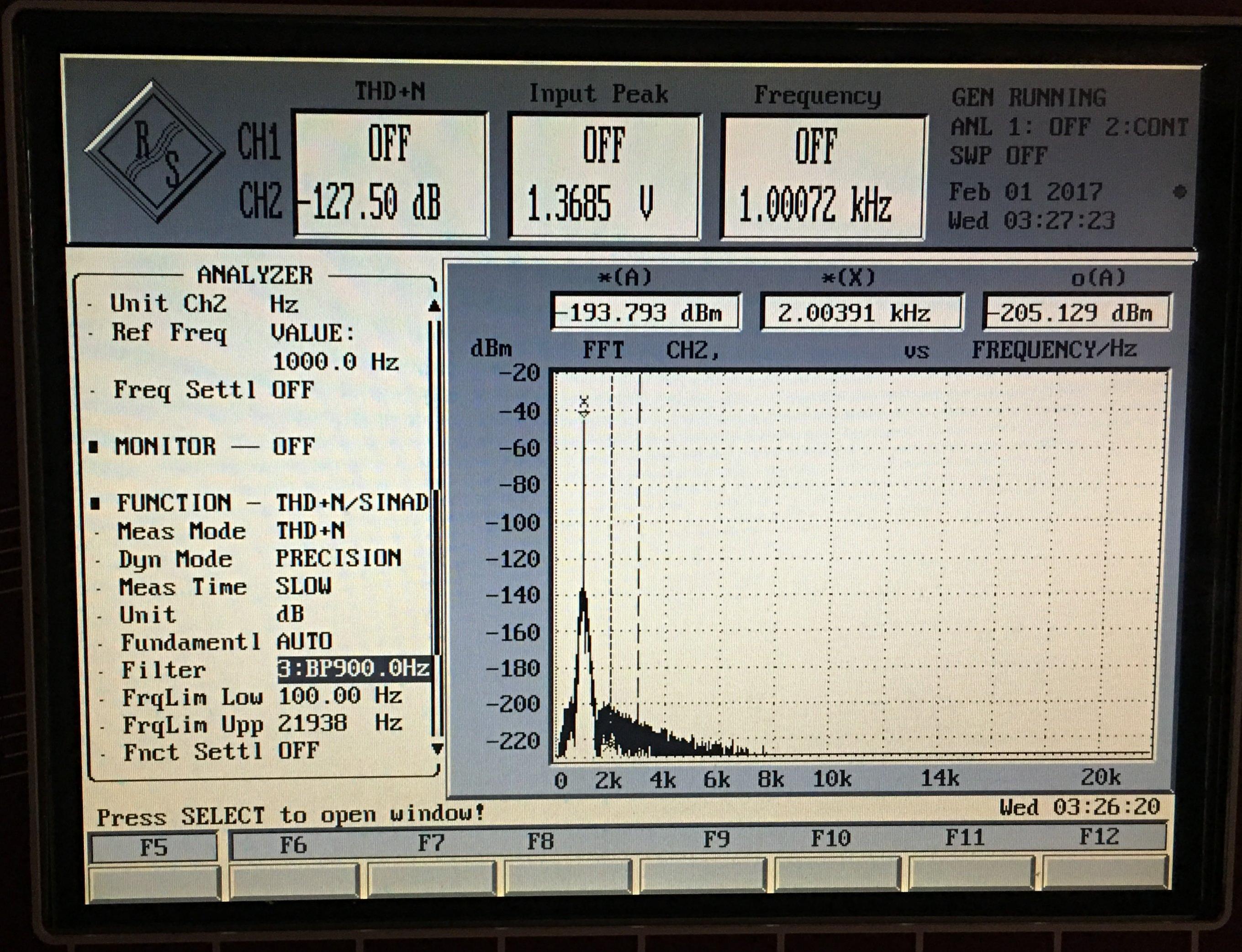

Over in the Low-distrotion, Audio-range,
Oscillator thread (LINK) some posts
about getting lower distortion before taking
the measurement of a DUT (Device Under Test).
Our own RNMarsh posted some good results
running his Panasonic through a miniDSP
box configured as a Low Pass Filter.
He had good results. So I thought and told him
so, and suggested he might get better results doing a band pass filter.
So instead of doing my diode homework for
my Solid State Devices class, I thought I'd
better check, that is put up for shut up.
So, I did and here is what I discovered:
Before filtering:
![Click the image to open in full size.](https://www.diyaudio.com/forums/attachments/equipment-tools/596075d1485936387-low-distortion-audio-range-oscillator-01.01-fft-no-filter-baseline.jpg)
https://www.diyaudio.com/forums/attac...r-baseline.jpg
Then here is using a 900Hz bandpass filter:
![Click the image to open in full size.](https://www.diyaudio.com/forums/attachments/equipment-tools/596094d1485940231-low-distortion-audio-range-oscillator-01.02-fft-900hz-bandpass.jpg)
https://www.diyaudio.com/forums/attac...z-bandpass.jpg
Yep, not bad and that is better than what I expected.
