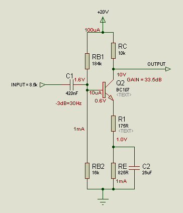

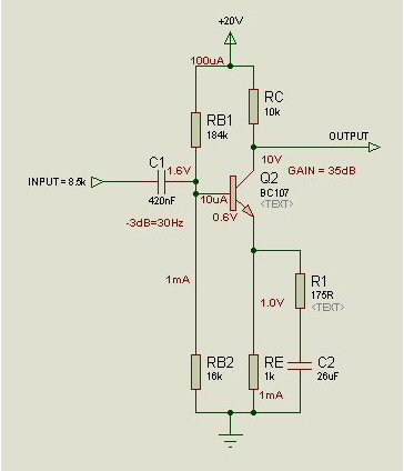

In the earlier post, basic common emitter amplifier design, I made reference to increasing the gain of the amplifier by bypassing the emitter resistor R[SIZE="1"]E[/SIZE].
In this case the gain referred to is the AC gain, which is the signal gain, and which is the gain we are primarily interested in with regard to audio amplifiers. The gain previously calculated was the DC gain, which was numerically identical to the AC gain, but since the amplifier was decoupled from the preceding stage with a capacitor, there was no DC applied to the transistor other than that provided by the bias network, which set the standing current to 1mA and the output voltage to 10V. DC gain and offset is important, because a decoupling cap can be avoided in some cases, but not here.
In the earlier post the gain was stated to be –R[SIZE="1"]C[/SIZE]/R[SIZE="1"]E[/SIZE]. This was a simplification, and, more strictly the gain is –R[SIZE="1"]C[/SIZE]/(R[SIZE="1"]E[/SIZE]...
