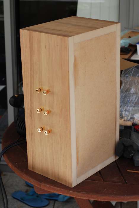

Some small problems can be seen on the veneer on the bottom cabinet, this is not an issue though as they will be chamfered. This was an oversight when first building the cabinets. I assumed (never assume) that my 25mm mdf was actually 25mm thick... it was actually 25.5mm... long story but detailed in the thread![Wink](https://origin.dastatic.com/forums/images/smilies/wink.gif)

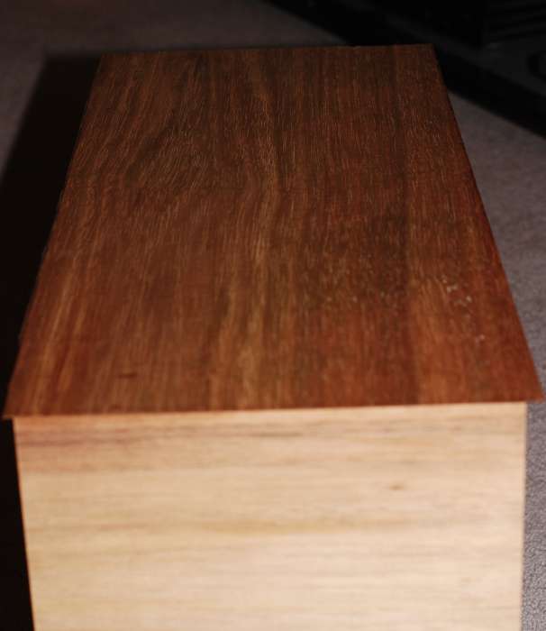

Update 24-10-2009. Well the veneer on the back of the second cabinet has been trimmed, and the holes for the speaker terminals re-drilled... I put the veneer for the tops in for flattening today... Next weekend I'll be away so it will be another two weeks before any more progress I suspect. I decided to do the tops next and the sides last. I also tried some bees wax on some trimmed veneer, didn't really care for it. Went to bunnings today to look for alternatives, but just got confused with the selection.... Saw some "brown" carnubua wax it might be the go, I think that the bees wax resulted in to light a finish for my taste.
Update 08-11-2009. I was planning to veneer the tops of both cabinets this weekend and get the veneer for the sides of one of the boxes flattened, but only managed to do one box. This is the first panel that actually matters. I changed my technique slightly with the last back, I decided to dribble the pva directly onto the mdf, and roll it on. No watering down. I did the same again today. I might do the other top during the week if I get a chance. I think then it should only be two more weekends (time permitting) before I can get the sides done too.

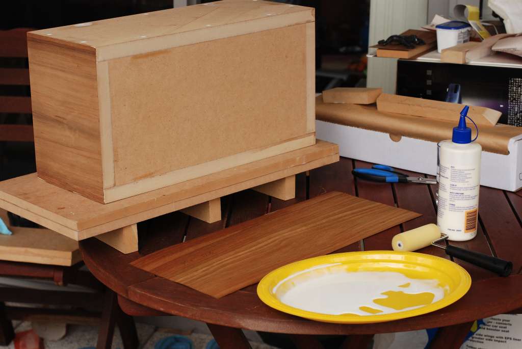

Well I finally made some more progress today.. first day in ages that wasn't either wet, or blowing a gale! I glued the veeneer on the back of the second box... decided to do it a little differently, I didn't water down the pva this time, poured it directly on the back and then rolled with the roller.. seems to have worked ok. Also decided to spray the non glue side with mist before clamping. Will trim it in a few days.. next comes the flattening of the veneer for the sides! first critical veneer...
Tony.Posted 18th October 2009 at 10:49 AM by wintermute
