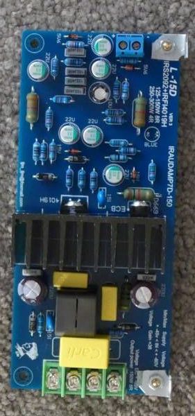

09 - IRS2092 L15D module assembled - top
Previous image   Next image
Photo Details
serafis
diyAudio Member
Registered: June 2008
Posts: 28
users gallery
One of the L15 boards assembled - it's an easy kit to build with all component positions marked.
Later on, I replaced the buffer caps with Rubycon 820uF 63V caps for improved bass, and all of the 22/33 uF aluminium caps with Elna Silmic II 22uF/25V caps for smoother response- I probably only needed to replace th einput coupling cap, but had 100 caps left over from another project so decide to replace them all.
