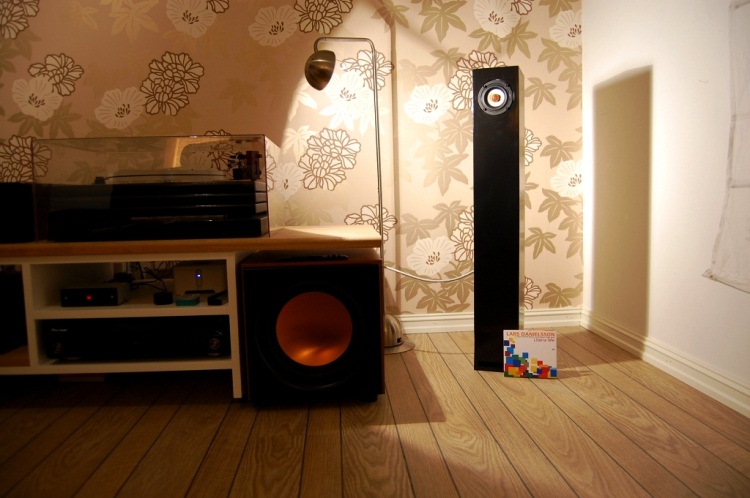

This is a standard TABAQ. The driver is mounted higher. The cabinet is stuffet in the upper 50%. BSC filter as described in the original TABAQ plans. This Tang Band driver have very good bass, you must hear it to beleive it. A micro floorstander high end loudspeaker.
