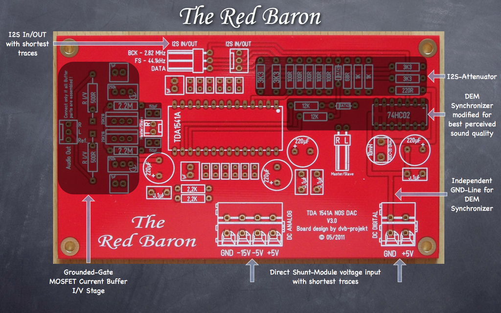

The Red Baron - aka TDA1541A DAC V3.0 module

The evolution changes:
- Direct shunt voltage inputs with shortest onboard traces
- I2S In-/Outputs with shortest onboard traces
- Upgrades DEM Synchronizer
- Onboard Grounded-Gate MOSFET Current Buffer I/V Stage
(-ecdesigns- MK7 version)
- Compacter design
Still on the module
- Separate GND-Trace for DEM-Synchroinizer
- Master/Slave connectors for parallel DAC module usage
and external I/V Buffer stages e.g.
Tube-I-zator & DDNF Stage
- Groundplane
- no SMD Design
