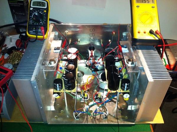

1.55v across 1 ohm resistor. Takes lots of turn.
Was a little freaked out when the initial voltage was 0.0 and 4.5v at the output, but when the pot is tuned CCW a few times, the voltage began to increase slowly. It's very stable for such a simple amp.
