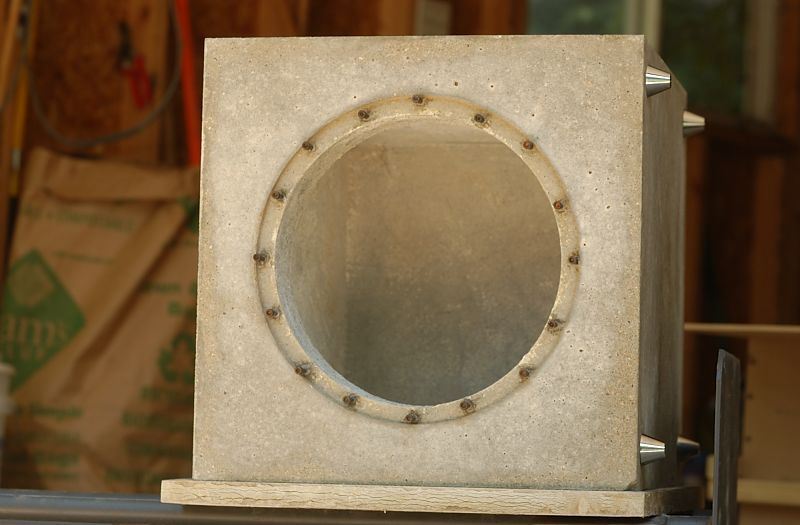

Concrete Cabinet
Previous image   Next image
Photo Details
spiner
diyAudio Member
Registered: September 2008
Location: Iowa
users gallery
Mounting holes for either Peerless XLS830500 or SLS830669 12 inch subs.
Tymphany pdf for XLS830500 sealed enclosure volume recommends 30L=1.0594ft³ and 10dB boost at 25 Hz. The cavity is 1 cubic foot no damping material.
The SLS830669 requires wool for a larger cabinet volume.
