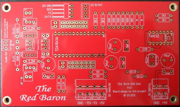

The new Red Baron - aka TDA1541A DAC V4.0 module

The evolution brings the following changes
- Separate I2S-GND route to Digital-GND
- Separate Analog Output GND route
- Separate GND route for active divider decoupling caps to Analog-GND
- Modified active divider decoupling pads for better SMD 1210 caps soldering
- Onboard SOT353 footprint for fastest DEM-Synchronizer IC´s
- Un-interrupted ground plane
- MOSFET Source/Drain failure corrected
Still on the module
- Direct shunt voltage inputs with shortest onboard traces
- I2S In-/Outputs with shortest onboard traces
- I2S Attenuator and DEM Synchronizer
(by -ecdesigns-)
- Onboard Grounded-Gate MOSFET Current Buffer I/V Stage
(-ecdesigns- MK7 version)
- Separate GND-Trace for DEM-Synchroinizer
- Master/Slave connectors for parallel DAC module usage
and external I/V Buffer stages e.g.
Tube-I-zator & DDNF Stage
- no SMD Design
