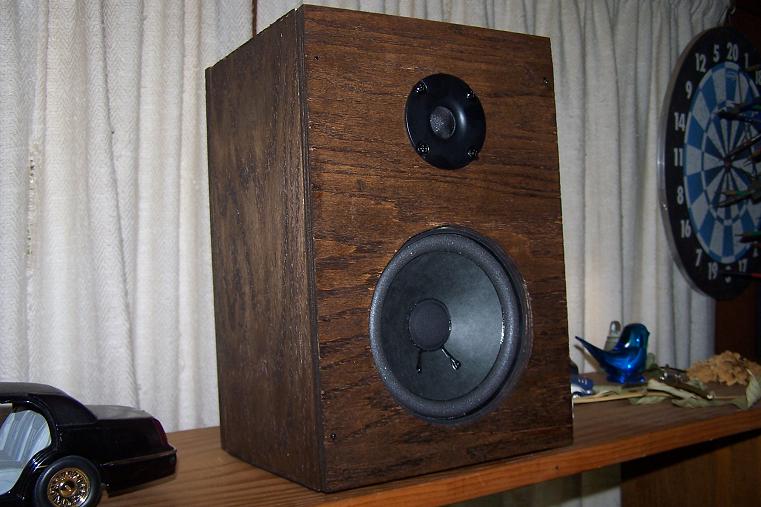

Features an Aurasound NS525-255-8A 5.5" inch woofer and an Audax TM020J3 tweeter with a poly cap.
Box is made from .5" oak veneer plywood , and is .261 ft3 . This pair are a little softer than my left and right fronts; it adds a nice touch of bass with a quality sound to round out my setup. If you wonder about the finish,
it's Minwax Dark Walnut - two coats. I like the flat looking finish over oak wood grains, but not too close up! The box is about 1/4 full of polyfill, and has a standard spring terminal for wiring.
