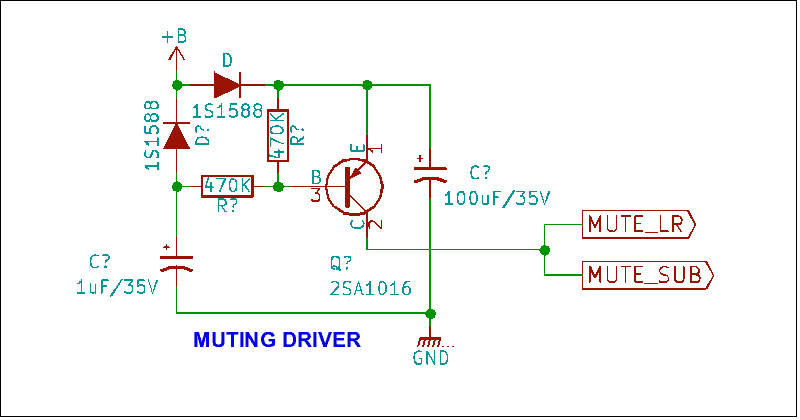

Power On/Off Pop
Quote:
A switch between pin2 SDZ and gnd seems easiest way to avoid any pop, it puts the tpa3116chip in standby/off position. There are some boards doing that, those are even more quiet then the mute pin controlled on/off. Then there are boards doing both, I think the purple heatsink without remote does for example, the remote/display version just uses SDZ and is completely quiet, not a little crack, never... |
CyberPit's Circuits
A BJT-based one:
This circuit is diverted the audio-line pop noise muting transistor driver circuit. (Of course, You can use this for its intended purpose)
https://cyberpithilo.web.fc2.com/aud...ng_circuit.png
![](https://cyberpithilo.web.fc2.com/audio/tpa3116d2_amp3ch/simulated_muting_circuit.png)
It is verbosely explained at his website (use a web translation service if you don't read Japanese).
Source: #10456 / CyperPit
The same circuit, just differently drawn:
Source: #10472 / CyperPit
![](https://www.diyaudio.com/forums/attachments/class-d/693093d1532251637-tpa3116d2-amp-mutedriver-gif)
Note that this schematic misses a series resistor between the output(Collector) and the TPA3116D2's mute pin - without it, the mute pin can be pulled-up 20mA max. way above TPA3116D2's PVCC at power-off, which may damage the chip inside clamp diode . Assuming a 100k pull-down on the mute pin, the output series resistor can be 100k, too - this ensures a very small current, yet sufficient voltage. If you feel too sensitive to the voltage drops, you can add some series of diodes at the most left diode D?

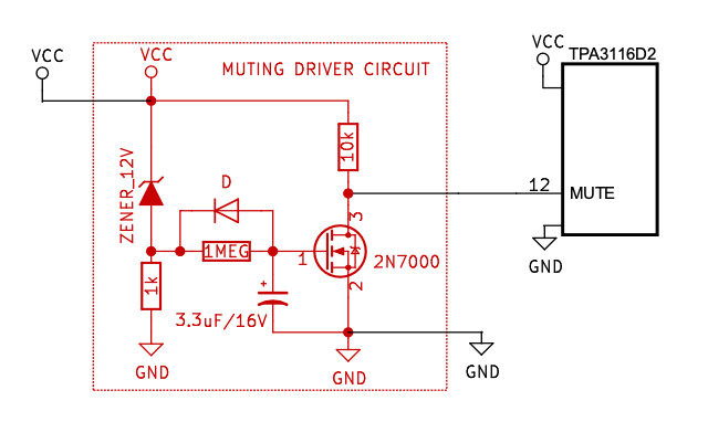

And a FET-based circuit:
Source: CyperPit (some explanations in subsequent posts)
![](https://www.diyaudio.com/forums/attachments/class-d/842509d1589076621-2x100w-tpa3116d2-2-chips-pbtl-mutingdriversch-gif)
Note: A SMD package 2N7002 is also available instead of 2N7000. Diode D should not use a Schottky, because reverse leakage current makes error on a power-up muting duration.
CyberPit recommends FET version rather than BJT-based one.
