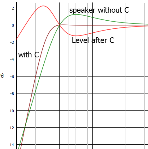

I managed to simulate the issue. The speaker can be placed in a small enclosure with Q=1.0 and fc=50Hz (green).
With the series C it is now linear until 34.4Hz (brown). It falls off with 18dB/oct.
Amazingly the capacitor increases the driving voltage above the amp output (red).
