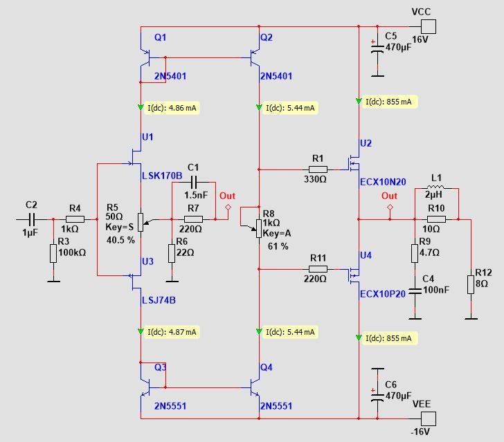

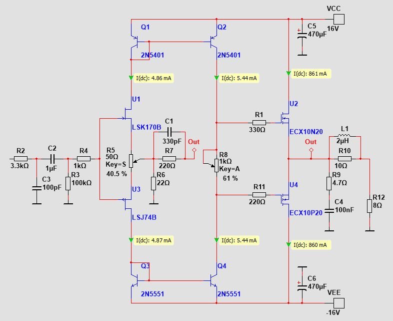

10 Watt Class A Symmetric CFA with 2nd Harmonic
Symmetric CFA with EXICON 10 Watt Class A output.
The design gives dominant 2nd harmonic.

Aside: It is common in electronics to differentiate between class A, A/B, B and whatever else. Audio relevant, I recommend distinguishing between SE, Push Pull and whatever else. When I read class A, I always have to check whether it is SE or PP to know what I can expect in terms of sound, audio.
Basically, the PP category would also have to be differentiated in order to differentiate audio in terms of: pp (non complementary transistors), complementary tppransistors (half-wave symmetrical), complementary transistors pp half-wave asymmetrical... Because this is also where the answers lie with regard to audio suitability.
My recommendation with best intentions;-)
I admire your dedication to low-complexity circuits - they are more suitable for audio than highly complex ones.!
