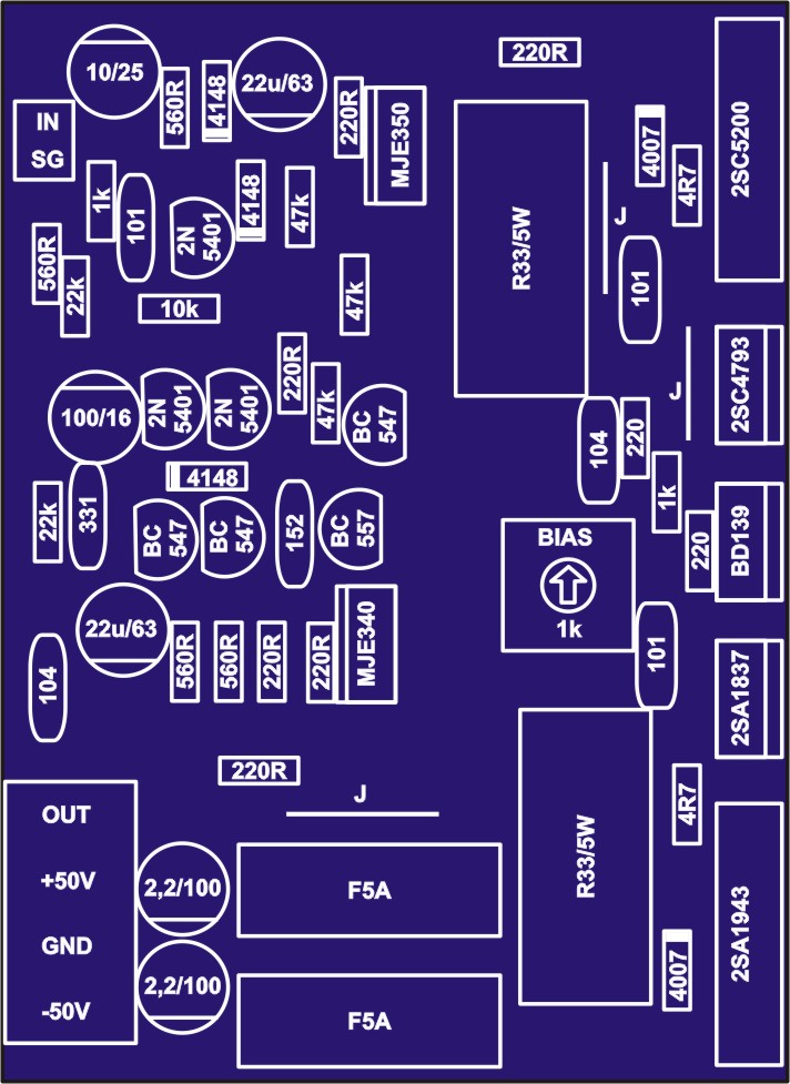

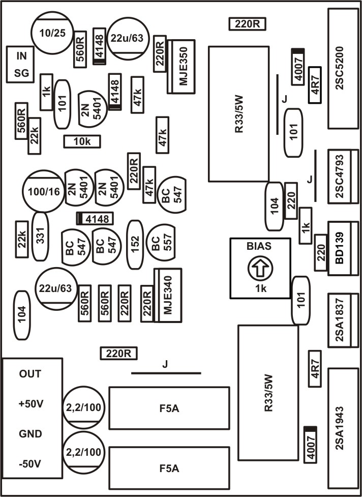

100W Ultimate Fidelity Amplifier
I made this amplifier for test my home DIY speakers (two way TL).
D4 on component layout wrong polarity, in post #253 is corect componenet layout.

R8 and R2 values are reversed..
R8 must be 560R and R2 22K...
C7 value ,is plain wrong , and should be much lower,
something between 3.3 and 18pF..
As i pointed it with many of his designs, R5 and C3
must be removed as they create a hard rail sticking when
the amp is overloaded.
There s better means to achive stability.....

Thanks Wahab,
R2 and R8 values are reversed on schematics, on PCB is OK,
C7 can be lower 47pF is minimum
C9,C10 can be lower 22pF is minimum
Rest is OK
Regards Mile
C7 330pF is maximum value for stability, but can be lower after tested.
At 330pF, it will severly affect the bandwith of the amp,
having influence below 20khz.
At 47pF , although i find the value still high, the bandwith
will be large enough, over 100khz...
