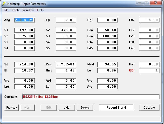

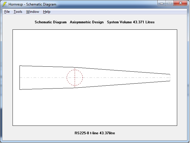

I designed a T-line in hornresp with the following
system volume 43.37 litres
total line length 159.3com
S1 = 497 cm2
S2 = 375 cm2
S3 = 39 cm2
first segment is 58.4cm (driver offset)
second is 100.9 cm long
total length is 159.3cm or 62.7 inches

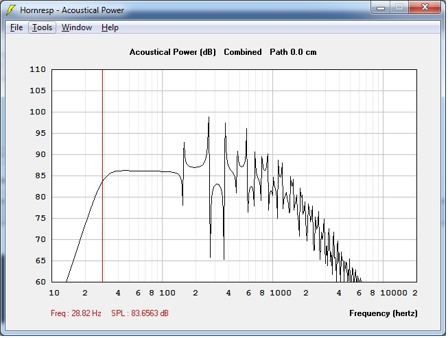

models very nicely
F3 about 28hz
I analyzed xrk's t-line posted a few pages and for me it is a bit too big
approx 229cm long or 90.1 inches
it is about 70 litres system volume (43 litres is better IMO)
F3 is about 25hz, a little more prone to excess cone movement
I have all the parts for this system but I am trying to get a little CNC done so as to have a 2.4" offset in a pretty cool fashion.
Will keep you posted once things start actually getting built.

This is what it looks like built up:
Very neat X.
Hi OntarioMax,
Can you please show your TL simulation plots? I was trying to make it smaller but it did not have the flat extension I was looking for. A 43L version would be a good large standmount / or a floorstander with legs to get it up higher at ear level. How did you eventually fold it and where does the vent come out?
X
X
