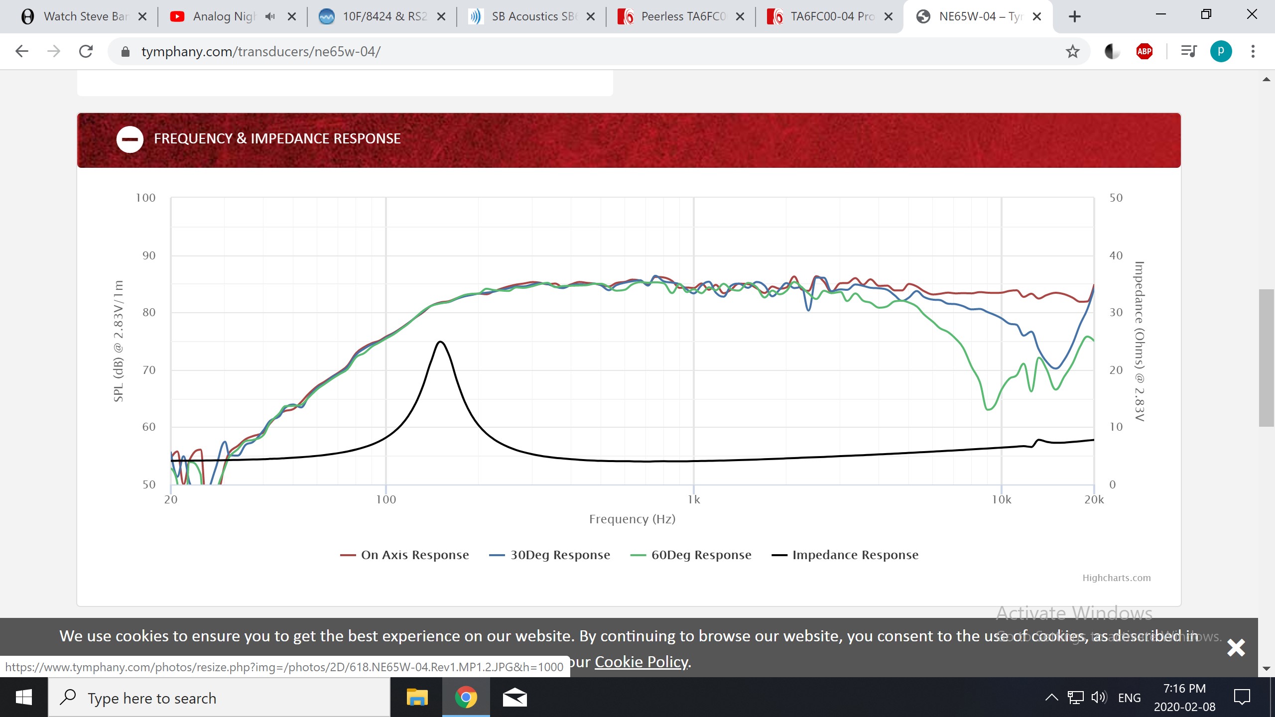

Speaking about small drivers...i'm very curious about the ne65w-04 big button small woofer. i had good experience with Peerless products so far...

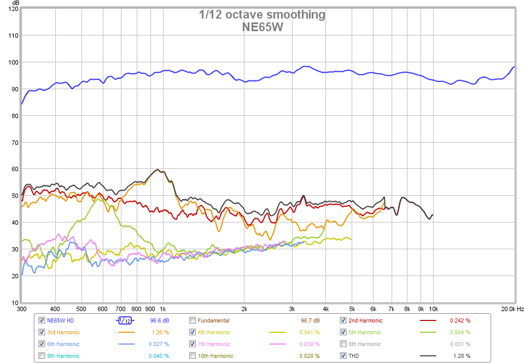

On this site, the ne65w measures like a very good big tweeter, compared to other drivers he tested, if we suppose all drivers were measured the same way.
TYMPHANY - VIFA NE65W-04 (Extended-range 2", 4 Ohm, 50 Wmax)
note: i see that this driver was discontinued on manufacturer site, but i see some retailers still have a supply.
attached is XRK measurements
nothing exceptional in this driver,it seems, but power rating is good.

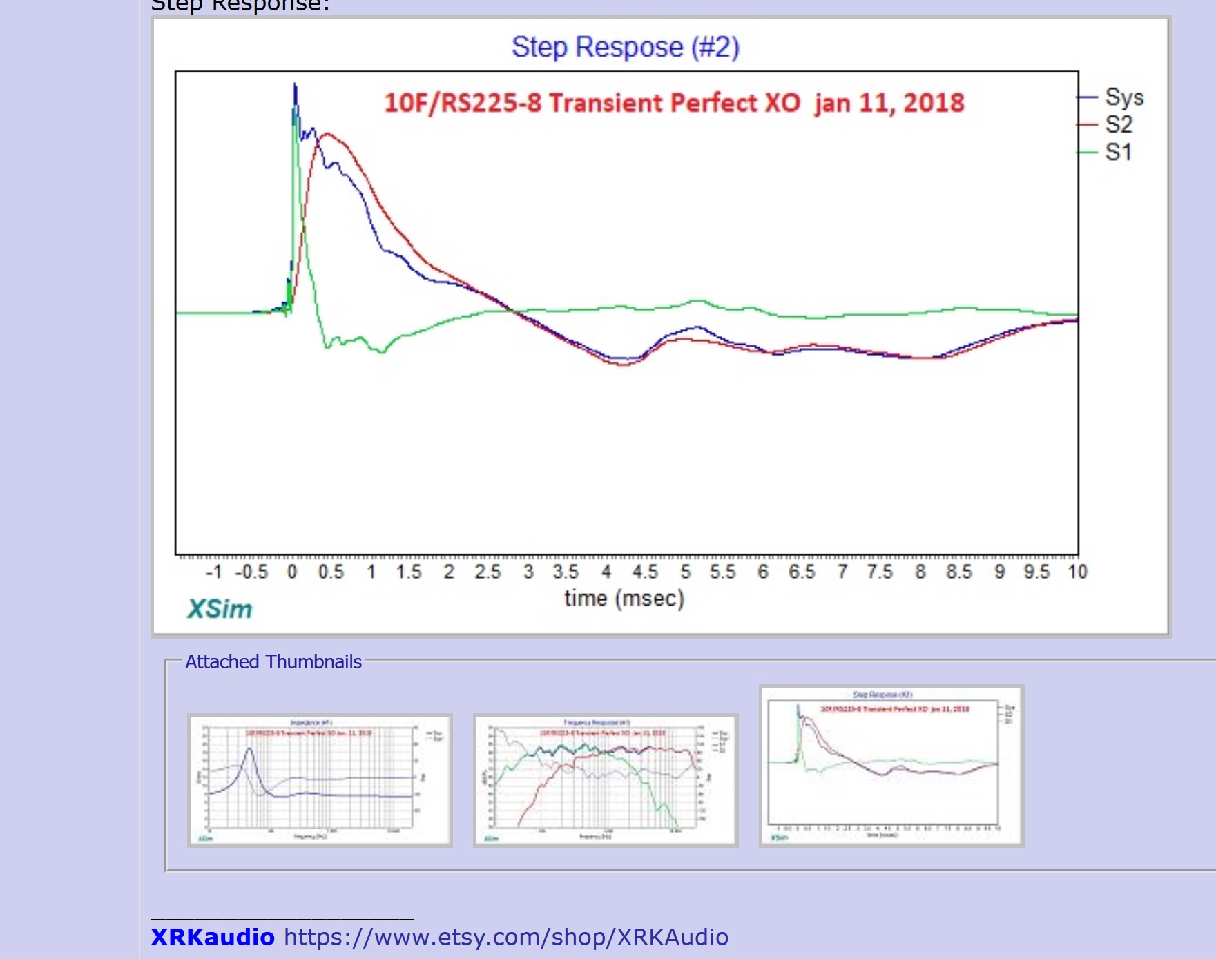

The speaker already sounds kind of coherent/ smooth without the offset, already without the offset it is a good speaker to my ears. But when I read that XRK mentioned, that there should be about 3in delay to the Scan Speak - correctly speaking - , I thought I really have to do that and try it out. Outdoors without any (almost any) reflections you really kind of dramatically hear the difference. Without offset there is a smearing and limit of transparency, with the offset it sounds on the spot, perfect like 3D of the recorded space (classical music and Jazz). I had one friend who described it as "the overtones gear into each other/ intertwine". I like that expression, I imagine that the two drivers really go hand in hand over the more the less broad bandwidth they both play.
With all the reflections indoors the difference is not THAT big to hear (still big), when you go outdoors it is not very hard to find the very point/ sweet spot.
With the offset the heights more sound like a real tweeter, they are sparkling. Still I miss the tweeter, as some qualities of a tweeter still are missing (I cannot name them), but the resolution is quite impressive though. That goes hand in hand with my friend's description.
Still I am very surprised, that that what the ears tell you, does not go hand in hand with the measurements, which are worse with the offset. I am wondering if anybody could explain this to me.
I have to say, that I have an idea, and this is, that (as more energy is in the bass) - without offset the drivers are perhaps more synchronal in the bass and it therefor measures better, but the "overtones"/ heights are not coherent. With the delay the mids and heights are perfect, but the bass is not (?). Oudoors you can only judge the mids and heights, you hardly hear bass (due to the relatively small driver and the missing reflections). - I do not understand a lot of measurements and filtering/ crossovers (phase shift,...) and the knowledge one needed to explain what I have experienced, but this is a creative idea (...). Still one has to accept, that my offset measures worse.
Hi everybody,
I just came across what XRK posted in thread 1973 a couple weeks ago: In that picture you see, that the top/ highest point of the step response of the woofer is behind/ after the top of the fullrange speaker stepresponse. It seems that my offset puts both tops together, and then it is clear, that the beginning of the line is not that steep as I have shown with my measurements of the speaker with the 6,1cm offset. This explains my different measurement, and the different/ better sounding speaker. My former ideas/ trying of an explanation (above) are rubbish for sure, and I would not say any more it measures worse with the offset. - I can highly recommend to anybody to do the offset, even if it means perhaps strange optics and a different response due to the different front baffle, it is very much worth it!
