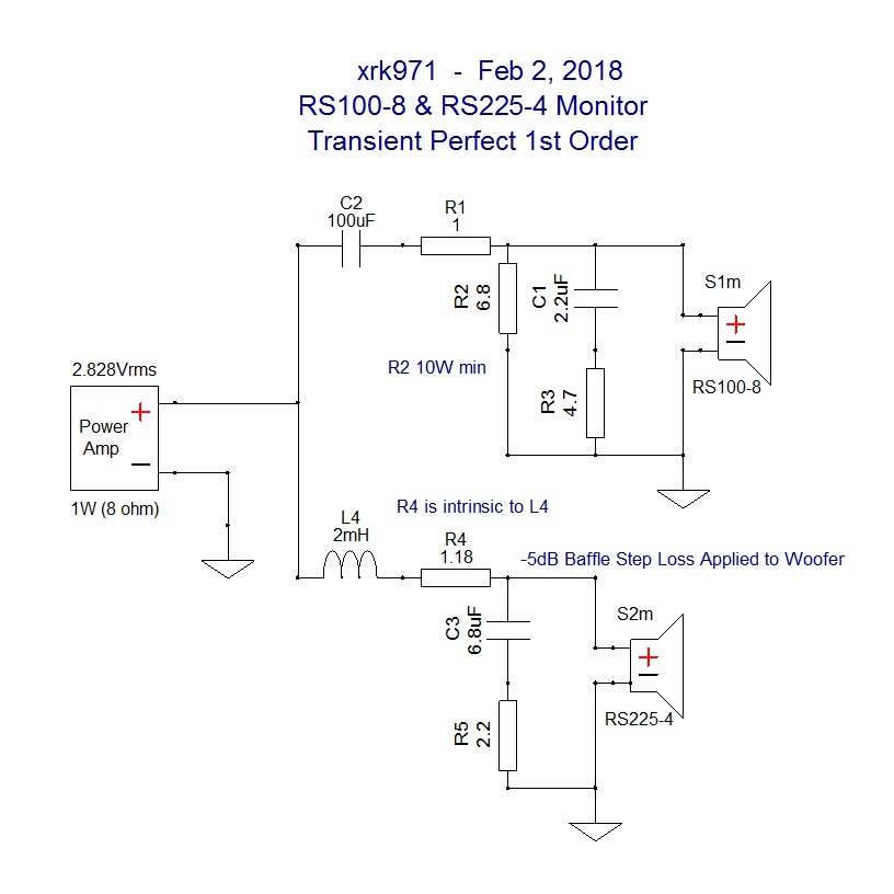

I would put the RS225-8 in parallel (4ohms) front and back in a bipole and that gets you 93dB sensitivity at 2.83v since no baffle step loss. Use a higher sensitivity full range like a 3FE22 for 91dB. The XO would have to be reworked but still first order and now 4ohms. Probably 2mH inductor for the parallel woofers. Woofers still on top.
If you made a box with fullrange in stepped baffle (3in setback) you could do WFW config. Only 88dB in this case.

To use RS225-4 in bipole, they would be wired series for 8ohm unless you had a 2ohm capable amp. Here, no boost in sensitivity but bipole eliminates 5dB baffle step and overall is 88dB. 10F would be used straight no attenuator resistor.

Initial sims of dual RS225-8 in parallel and bipole seems to show only 86.8dB at 2.83v and 1m. But this is after baffle step so still very good. Looks like the 10F sensitivity is still going to be ideal with minimal attentuation. However, there is a dip at 415Hz - probably 1/2-wave cancellation between the Rear membranes of the front and back drivers. Lots of stuffing there could reduce that in practice. But an 86.8dB sensitive speaker is very nice. I had to increase speaker internal width to 10.5in for extents baffle at 12in wide external. -3dB is at 32Hz. Great extension.
