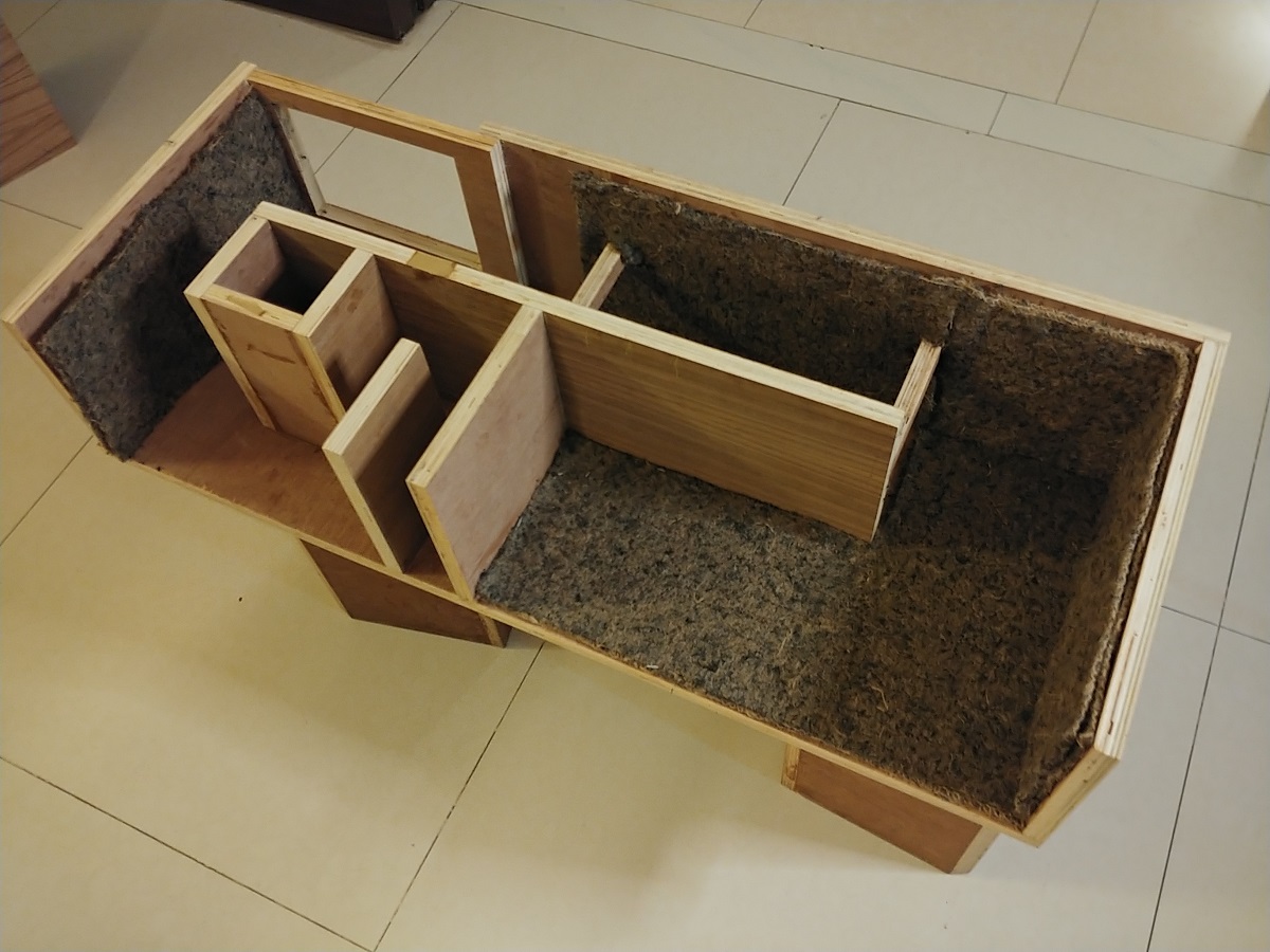

Some updates on my build.
- One of the cabinets all glued up, except for the front baffles. The front baffle will be removable for my build, in case I want to experiment with different wide-band drivers later. I am planning to start with the Vistaon B80. Need to rout the speaker mounting holes on the baffle pieces.

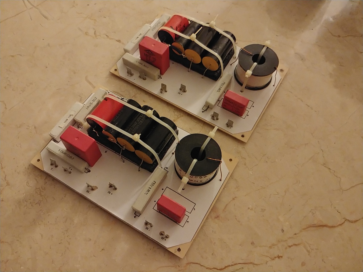

- The second cab is ready to be buttoned up - pics with areas inside the cabinet lined with natural jute felt shown below. You can also see the and cross-over placement in on the images. Please note I have made a "window" towards the bottom of the back-panel. There will be screwed-on panel here, which can be removed to take out the XO for tweaking and adjust the poly-fluff at the bottom of the speaker. There are a couple of horizontal braces between the divider and the back panel. The material is 18 mm ply for the build.
- For housing the wide-band unit in its own closed chamber, I followed xrk971 and Vunce, and chose plastic sports cones. The seller gave me multiple colors...:) I truncated the cones a bit towards the narrow end - this is little bit different from what the others did. X's cabinet maker used the full length of the cone and made a hole in the divider to accommodate the narrow top of the cone. Instead in my case, I made the cone a little bit shorter and closed the end with a piece of PVC sheet bonded with epoxy. I am also thinking about reinforcing the open end of the cone with 5-6 mm ply, will try to get that done tomorrow.
