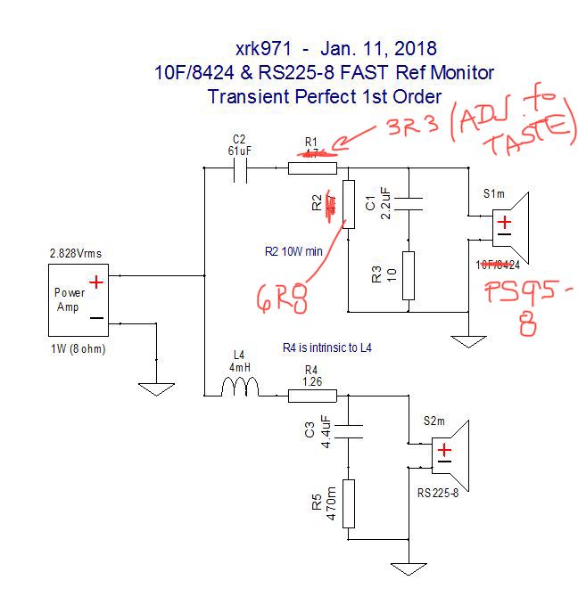

Second order, L-pad added for the sensitivity gap and a paralel notch filterIs it second order on the JBL 1" compression driver, too? I have used 3rd order at 1kHz on 1" Radian compression driver, but even then 1kHz may be stretching it a bit. I now use 1.4" compression driver.

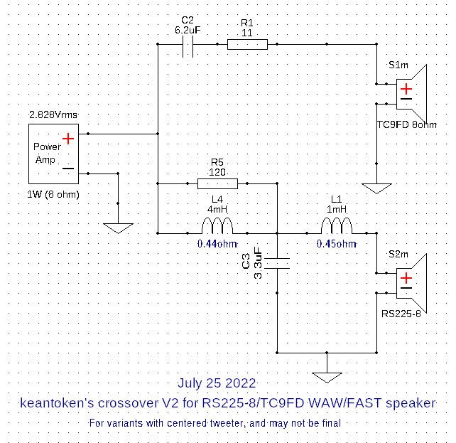

Just looking to find best sources for parts in the UK. RS225-8 are on Amazon for £80 each. The Peerless TC9FD18-0 is on Digikey for £13 so that seems like a steal, hopefully I can make up the rest of the order to avoid the £12 shipping!
Yes, but at 8X the price I didn't read anything that made me think that was money well spent... I'm on a tight budget for my first build!For the price, the TC9 is quite good, but if you can spring it, the B80 or 10F are better.
I know they are more expensive, but if you figure you will keep the speakers for more than 10 years, it's not so bad when splitting the cost over so many years.![]()

Any tips for where to go for crossover parts in the UK, without breaking the bank? I read that I can use iron core inductors. Suprised how much a coil of enammeled copper wire is when it's 'audio' grade! I could use bog standard Panasonic propylene caps too I think.
Not trying to cheap out but I have a limited budget...
Yes I think I used some Panasonic or Kemet PP caps. Nothing boutique or audiophile.! You could also get some motor run PP caps off eBay. They are physically large.
I got my coils from a UK seller on eBay whom custom winds inductors. Think they were about £30 the pair for the 4mH.
