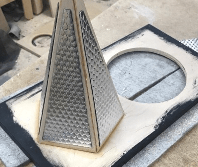

I found you mentioned that each panel should have a mitred cut of 36 degrees. And that they are 12.5” long, but nothing about base width?
You’ve given dimensions for the 3 sided dagger on page 1.

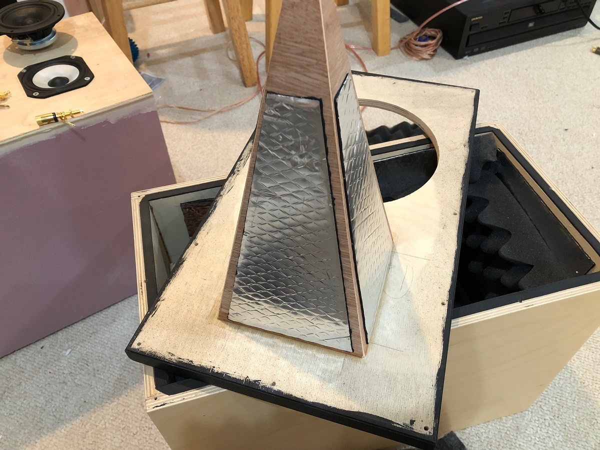

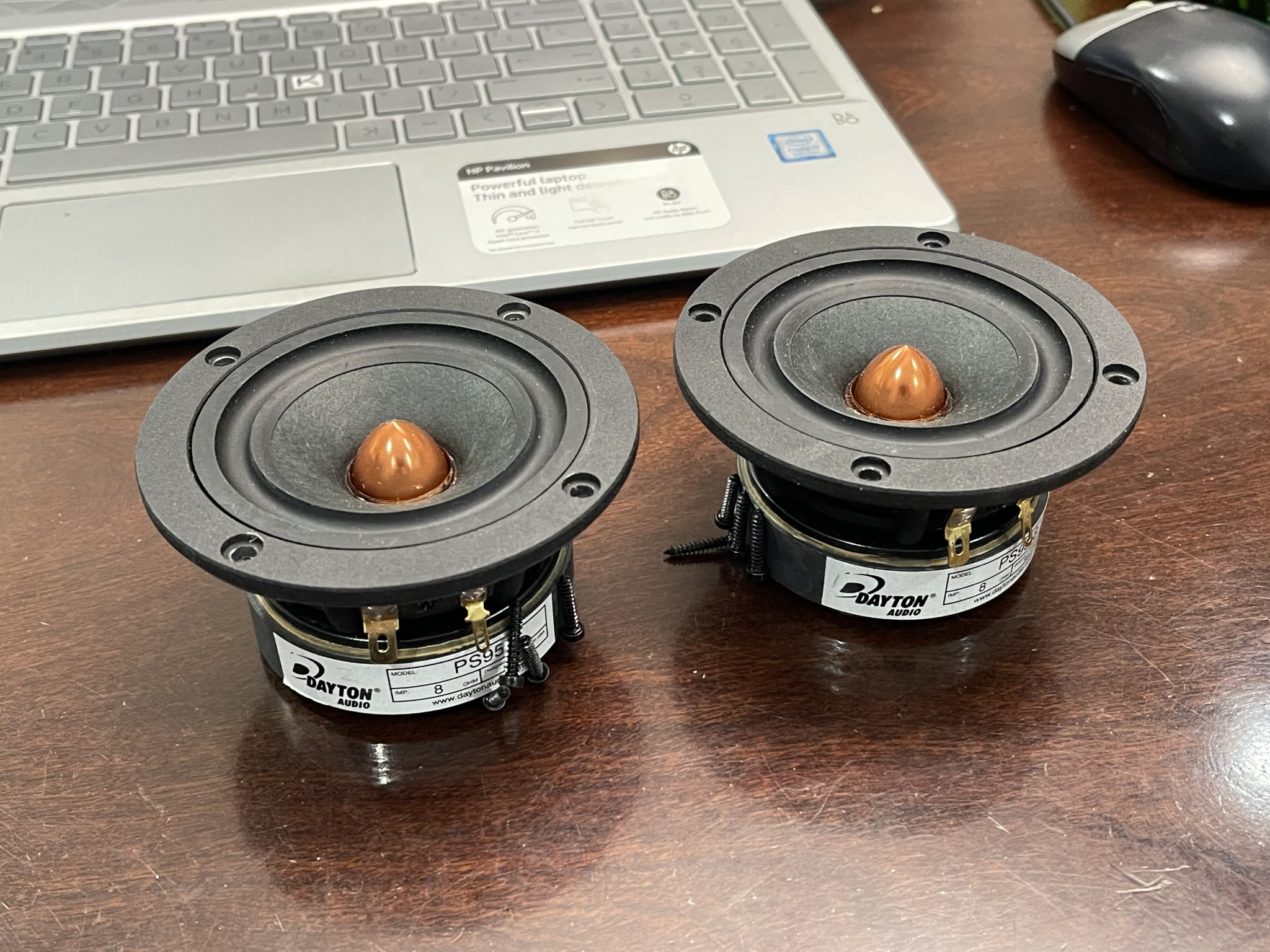

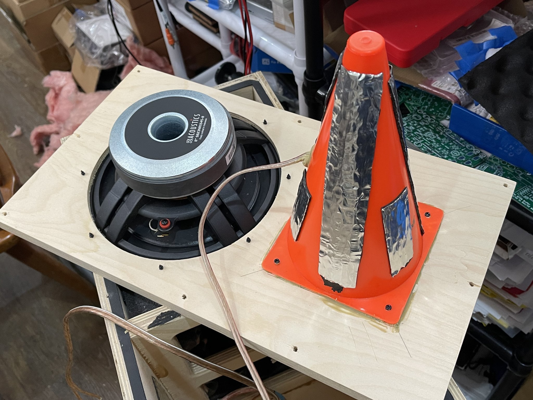

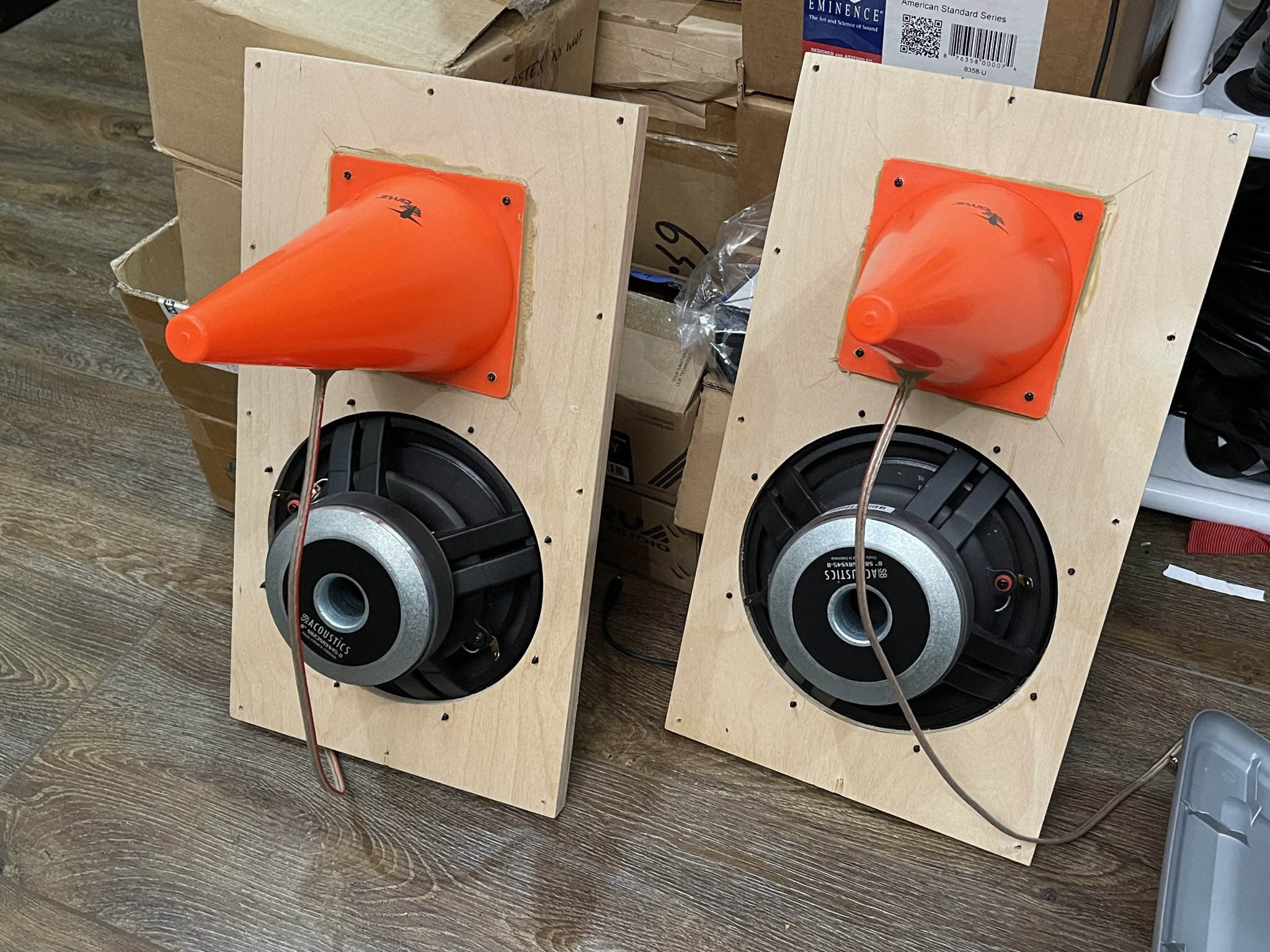

I’m going to make an SB23NRXs45-8 woofer and PS95-8 version of the FAST speaker now. I have had the baffles cut for this forever and now just getting around to installing the rear Dagger sports cone to the baffle. Ever since I heard how good the PS95-8 can sound with the appropriate filter (lots of top end like a dome tweeter), it gave me some inspiration to try this. I’m not sure if I can do a first order crossover like I did with the RS225-8 but we will see. Might have to be an asymmetric Harsch like filter. So I installed the sports cones with some (expired) Liquid Nails adhesive. It was so thick I could not dispense with the caulking gun but had to use a gloved finger to spread it. Now wait overnight for adhesive to set then install in the cabinet tomorrow. What to do to get two sets of wires out of the sealed box though to do the crossover. I might to install a second set of binding posts.

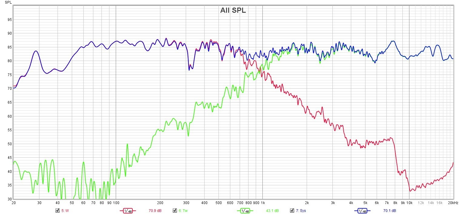

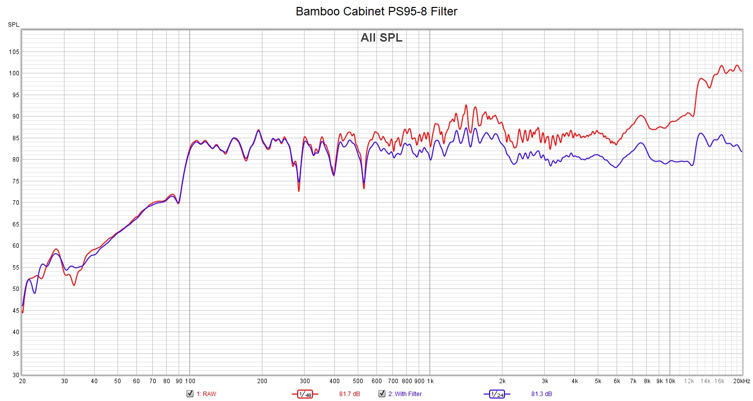

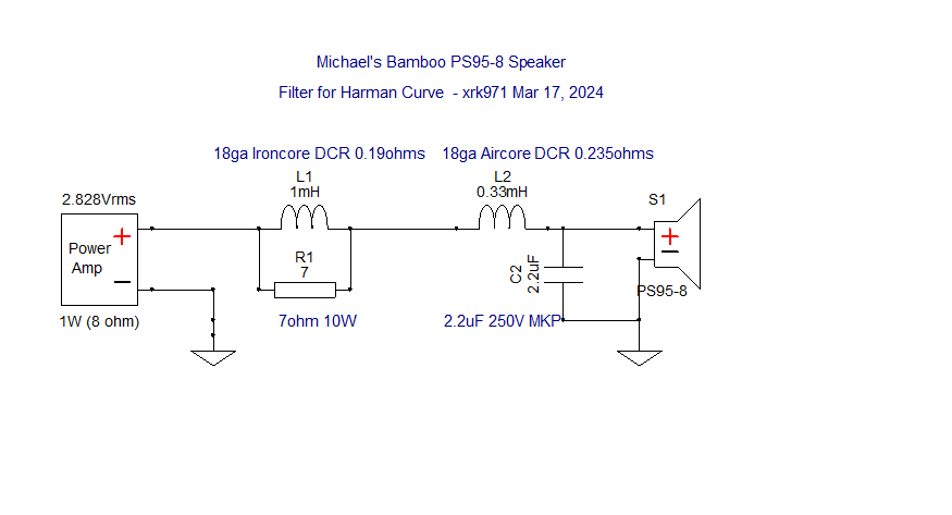

Here is PS95-8 with appropriate filter - you can see the top end extension:
Easiest thing to do is build a template with cardboard to see what size works to make a 5 sided Dagger. I didn’t build it myself as my cabinet maker did it and I recall he said he made it with thin Masonite as test case. Make the mouth large enough to fit the driver and some added padding on the side walls. About 5.5in wide at the base or thereabouts and about 11in tall.Thanks for this. I was just hoping to find the dimensions of the panels.

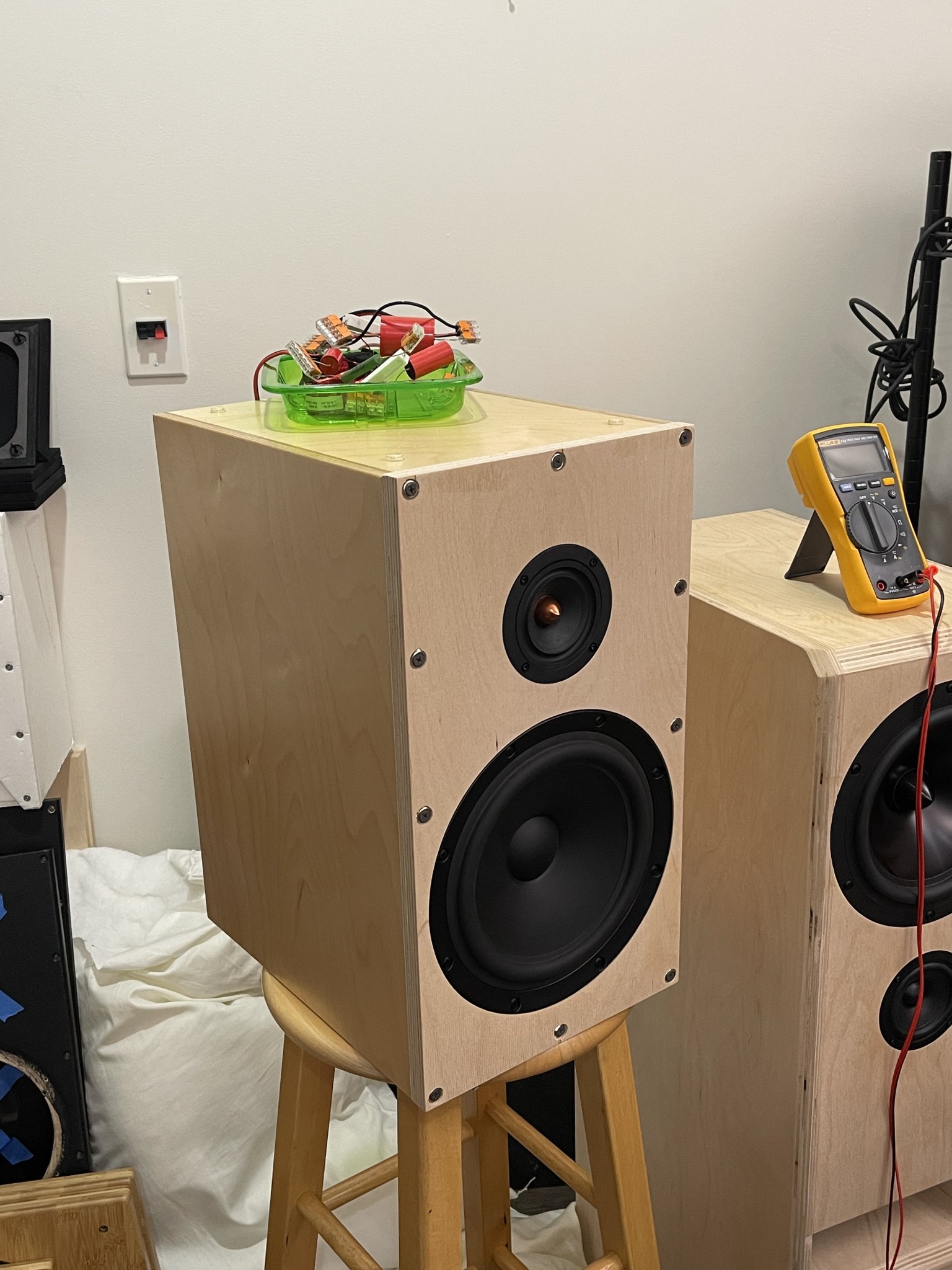

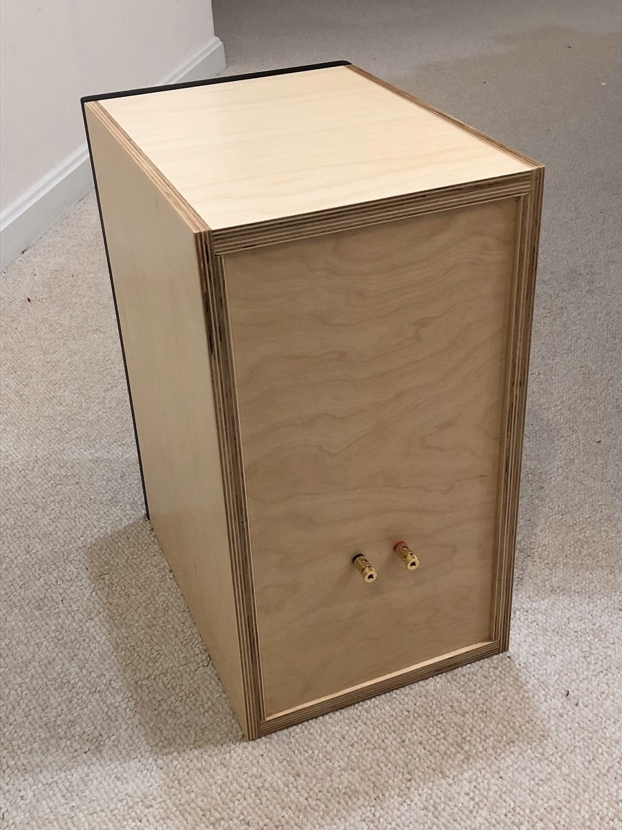

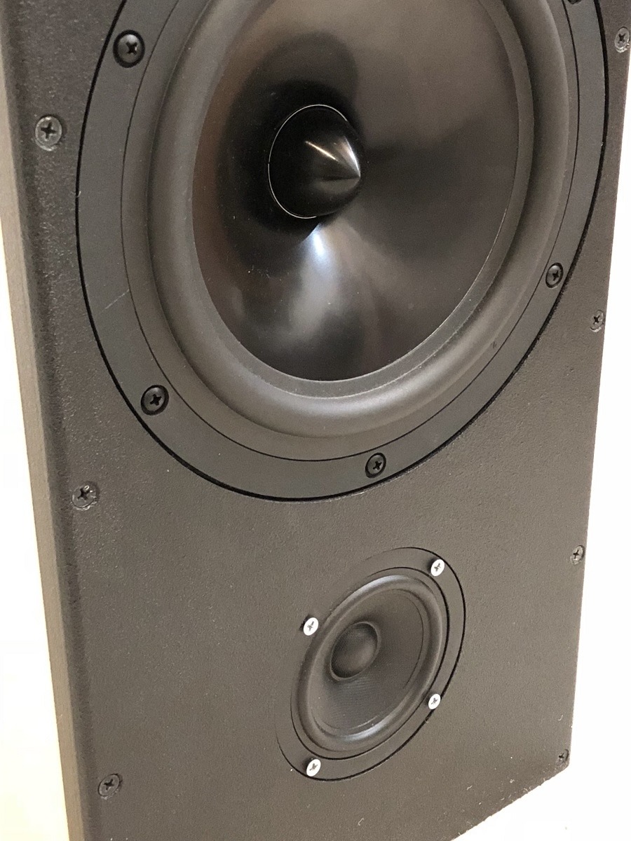

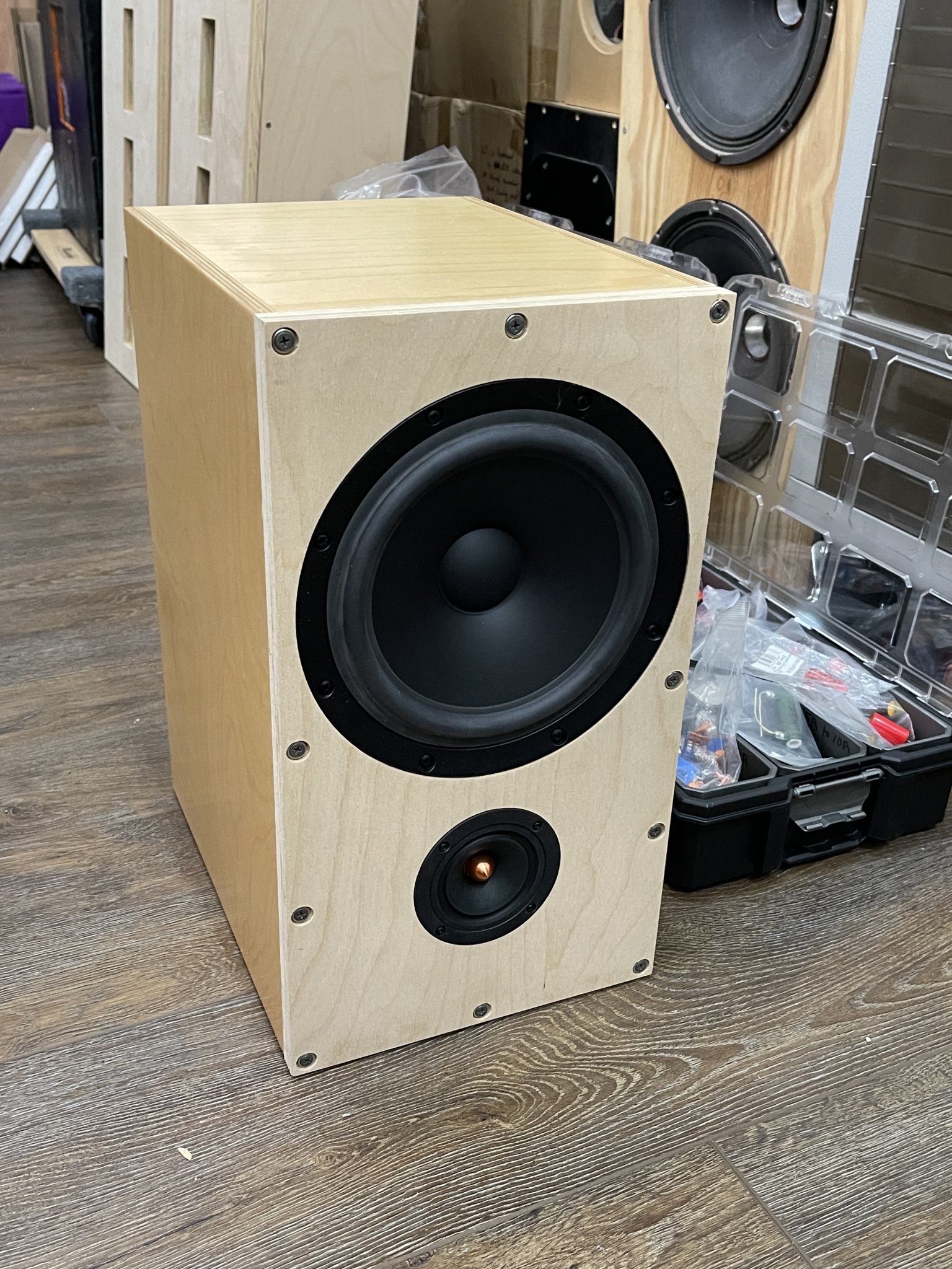

One speaker finished.

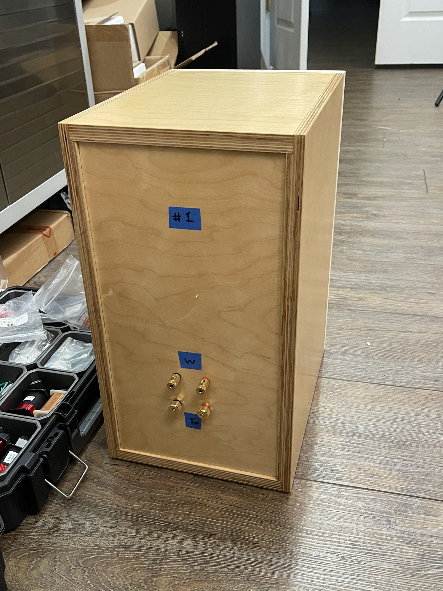

Double binding posts so I guess it can be used as an active speaker later.

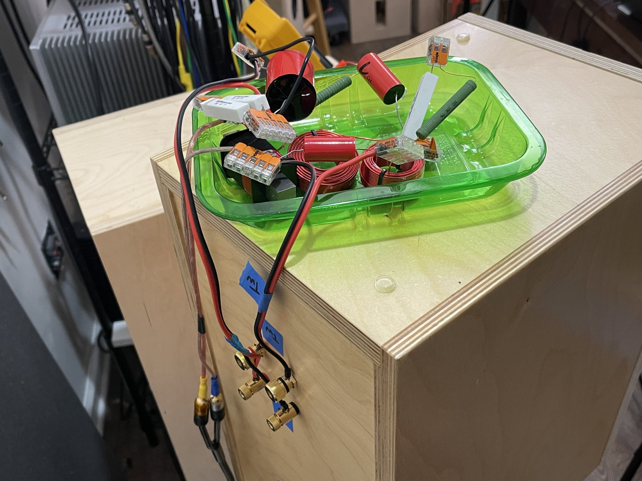

More progress and second one now done. Ready to take measurements of raw driver responses to make the crossover.
Some more progress tonight.

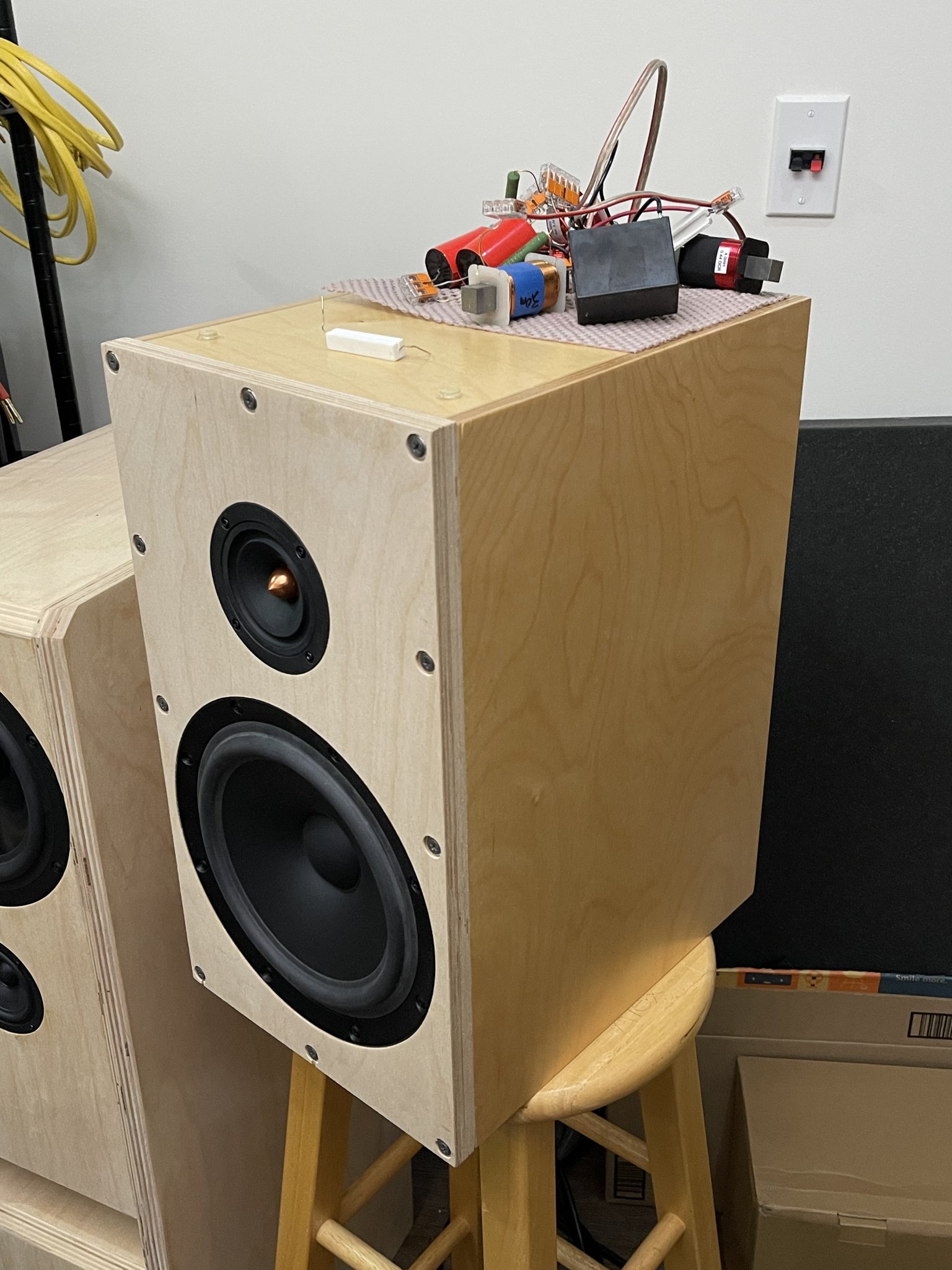

Still voicing it. Treble is a bit bright.

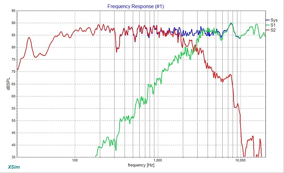

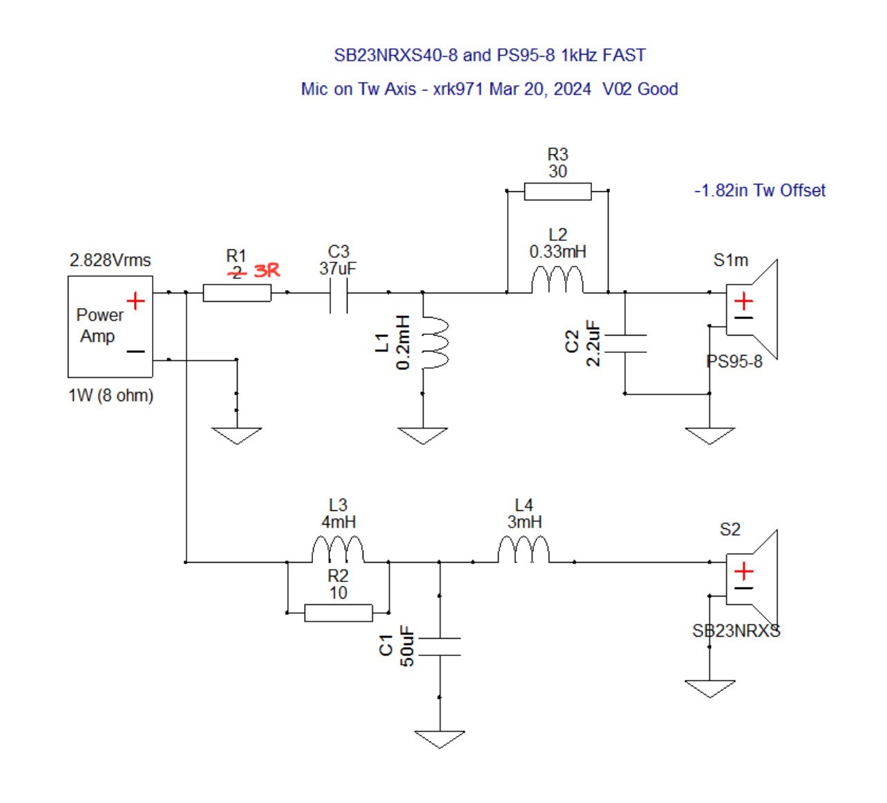

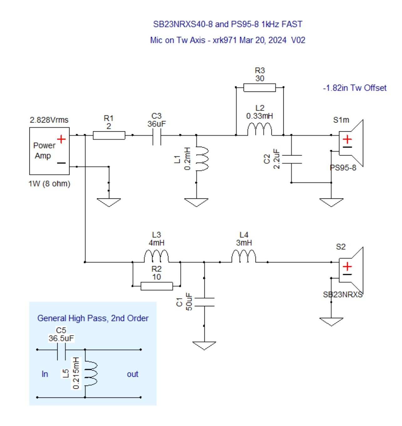

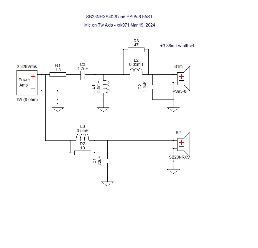

I messed up on the acoustic offset for the XO sim so things were off and never sounded right. I got that fixed and moved the XO to 1kHz so that it can be a FAST. The crossover is a bit more complex and larger parts now - so not an inexpensive XO. But well worth it since the PS95-8 has such a great top end and the SB23 gives some nice sensitivity even after baffle step. 86dB at 2.83v and -3dB is about 51Hz (sealed box alignment with 24 liter volume).
Here is the new XO at 1kHz. It’s not transient perfect but same absolute phase. I am actually using 37uF (22uF +15uF) at C3 so closer to 36.5uF suggested by the filter wizard.
Here are actual measurements of XO behavior:
Bottom line is that it sounds fantastic! Very nice and I am letting it break in now. Couple of tracks so far sound so good. Very musical and engaging and loveley sound on high hats with a lot of air. But never fatiguing.
Here’s the final crossover now properly voiced. I increased the padding on R1 a tad bit to make the 1kHz -3kHz reduced by 1.5dB for a less forward presentation and less listener fatigue. The speaker is playing in stereo and the bass is surprisingly deep.

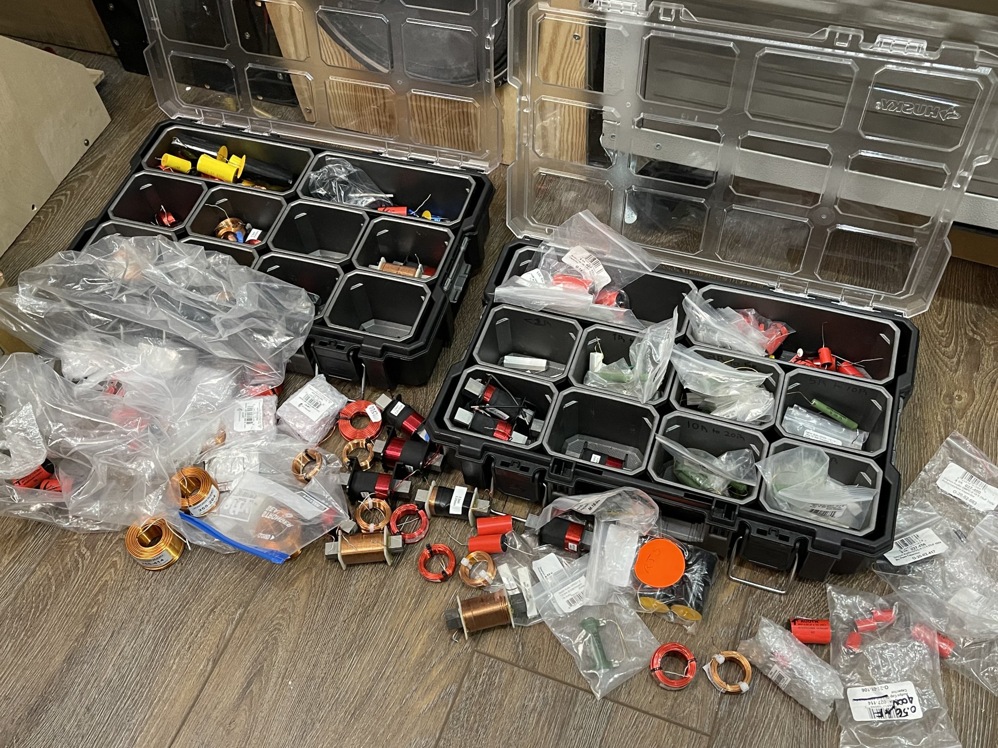

I really had to scrounge through my collection of crossover parts to find a stereo set of components for this speaker:

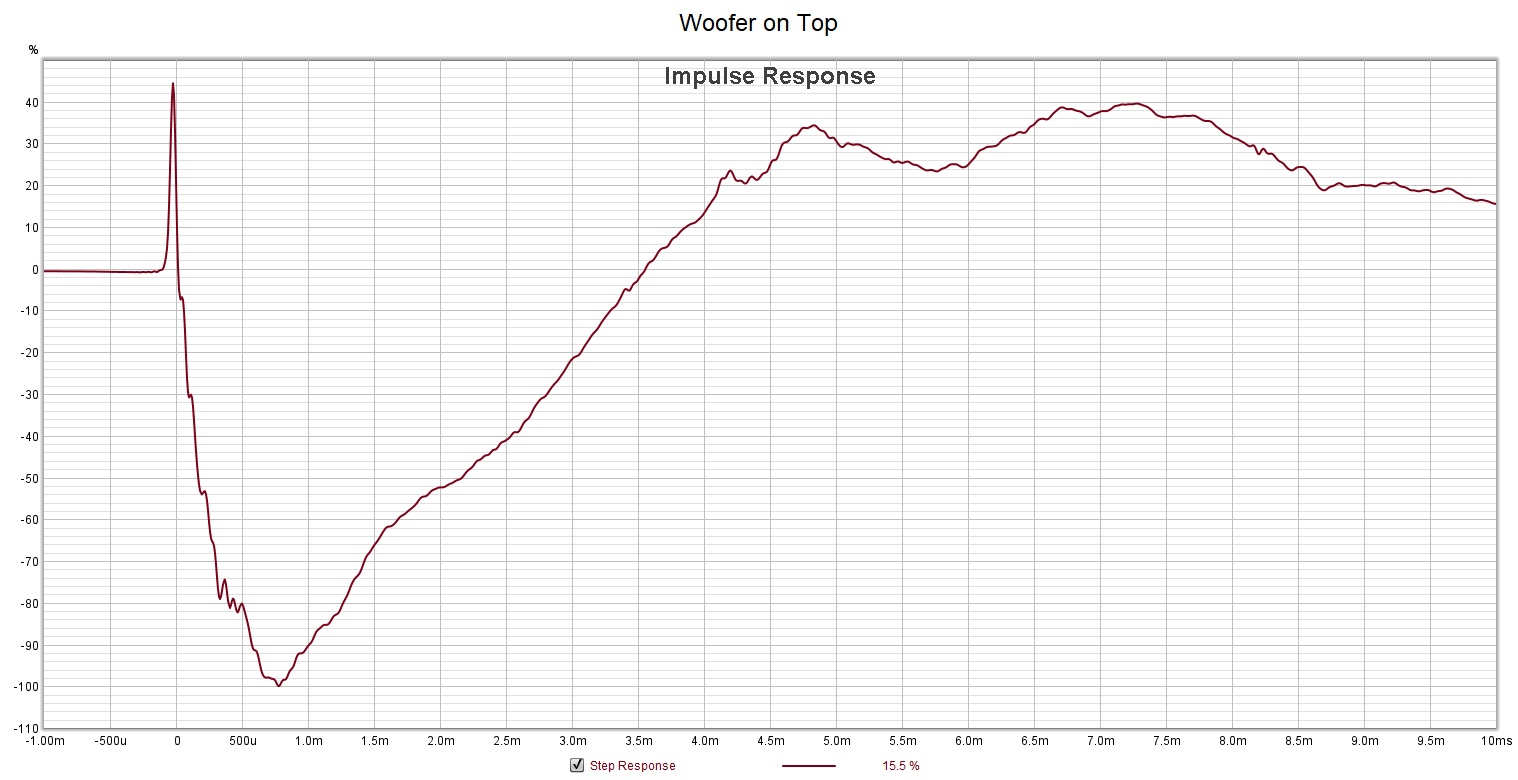

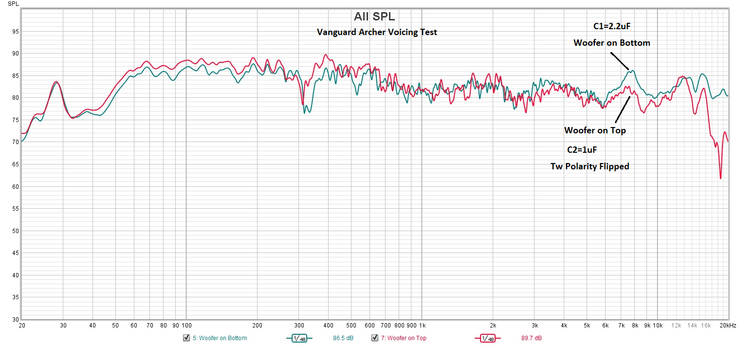

Sometimes you have to put things in their head and try it out. Given the original FAST speaker design in this thread used the woofer in top and tweeter in the bottom to improve the time alignment, I flipped the box upside down and inverted the tweeter connection to match the phase. It sounds quite nice and tames the 7.5kHz peak. The sensitivity went up 1dB and the bass extension went 2Hz lower. Now -3dB is at 49Hz and sensitivity is about 86dB at 2.84v.
Here’s the difference:
Time alignment is very good (mic is inverted so absolute phase is positive for the woofer):
The minus is that there is less output above 16kHz - however, still sounds very good with respect to air from cymbals and high hats.

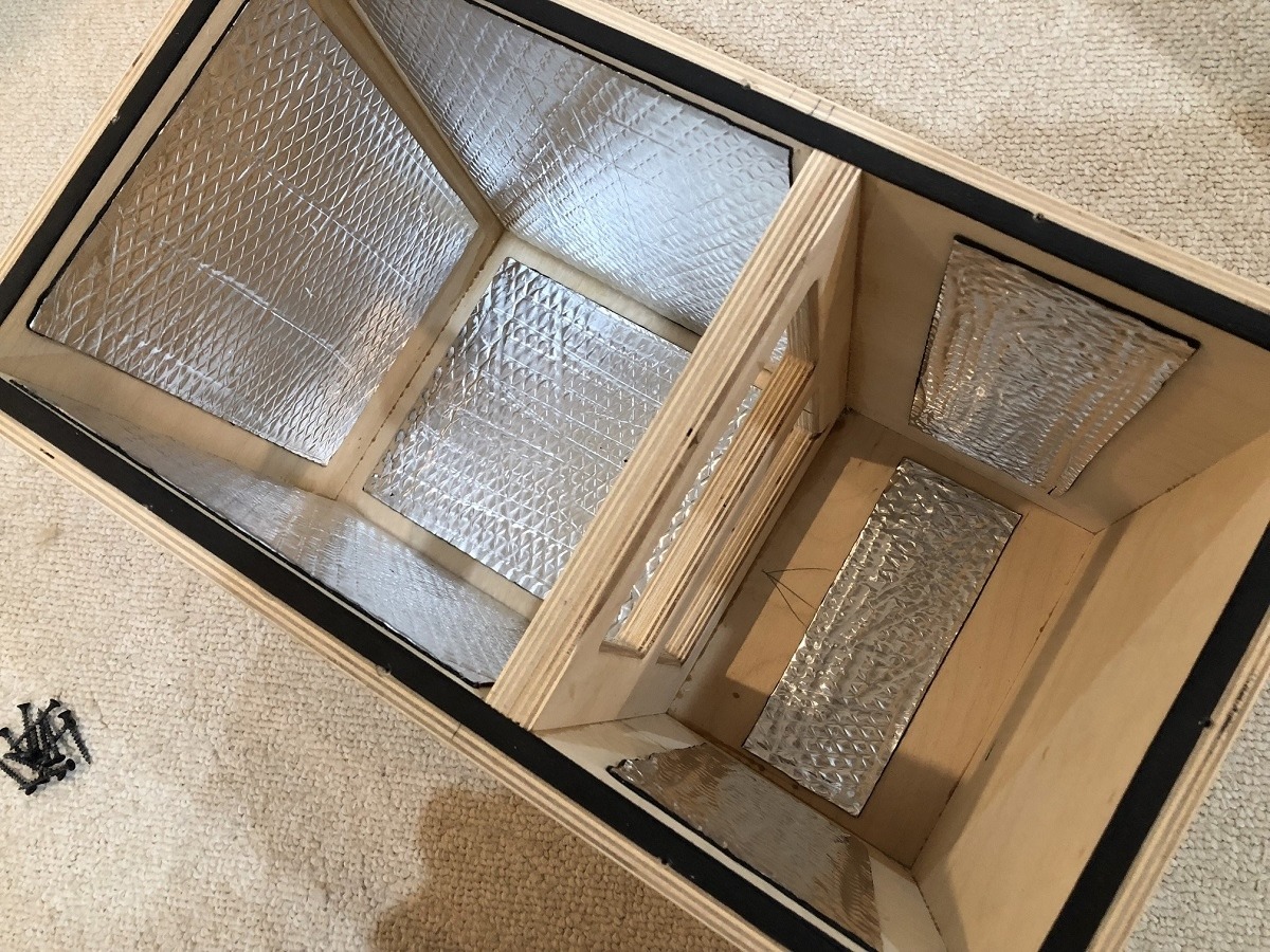

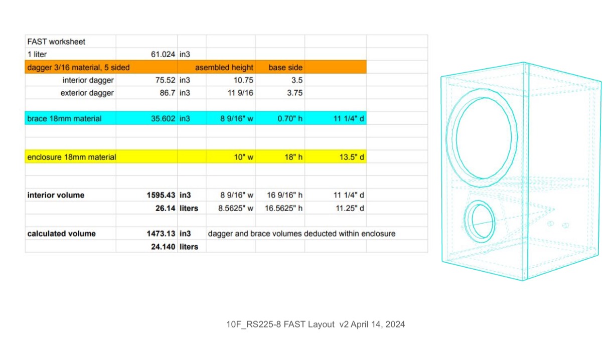

I have been getting a lot of PM’s asking for “plans” of the sealed cabinet for the 10f/RS225 FAST speaker. I never published drawings but the box is so simple you can build it based on this description…
Dimensions of sealed box version: most important is to make the width 10.0in (external) and CTC spacing between drivers 7.5in and adjust the depth and height so that you have about 24 liters volume. If you make it out of 18mm plywood it ends up about 18in H x 13.5in D. The 10F is located 4.5in top to center. You will need a rear chamber for tweeter (fullrange) so use a sports cone or wooded “Dagger” tall 4 to 5 sided pyramid. Stuff Dagger and main box with polyfill or fiberglass to taste.
These pictures should help you build it. Notice the window brace. Having a removable front baffle makes assembly and adjustment easier but is not required. I used it to allow swapping drivers by changing front baffle plates.

Exterior.
10in W x 18in H x 13.5in D
Tweeter is 4.5in from top edge.
Tweeter to woofer CTC spacing is 7.5in
Internal volume is about 24L.
Dagger volume is about 1.5 to 2L (not critical). Or sports cone.

A big thanks to @jrKC for helping with the drawing and 3D model of the sealed FAST speaker. Here are the plans in PDF and SketchUp.
Also a screenshot of the PDF for convenience.
