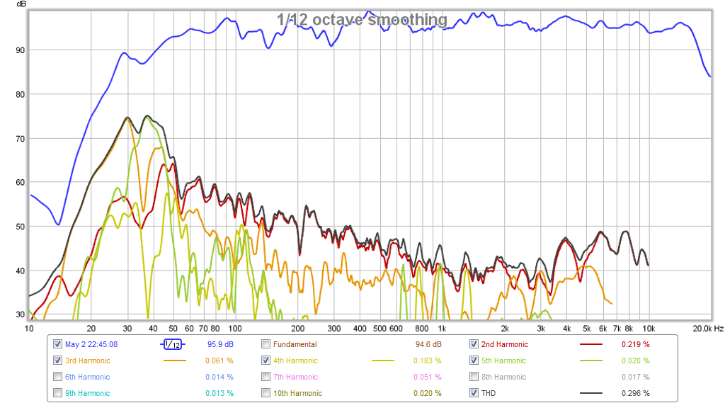

I took some new data here at 0.5m away (mic on axis of 10F) and 2.83v drive. Note that there is -6dB cut on the 10F and there is about -5dB of baffle step loss so even at 0.5m and 2.83v, the SPL is about 87dB (what it would nominally be at 1m without the padding or baffle step loss). I plotted it on a computer with a bigger screen so that the plot area is bigger and shows the HD curves more clearly. I turned the Linkwitz transform off but left a mild 5dB low-shelf from 100Hz on down.
The HD is still quite good at 0.25% at the 1.3kHz "peak" that I can see - which I think may belong to the 10F and not the RS225. Is there something else I am missing? [/IMG]
Those measurements are better, now the 4th and 5th harmonics clearly separate away from the second and third. The odd peaky nature in the higher harmonics between 600 and 1500Hz is odd and hints at a problem somewhere, any time the higher harmonics peak up like that, such as around 100Hz too, this hints at their perhaps being resonances occurring due to the less than rock solid cabinet, or possibly something in the room reverberating. HD due to cabinet issues isn't usually broadband and only occurs at specific frequency where the thing vibrates in sympathy with the driver.

Here is the distortion at 95dB, the behavior seems to be well controlled still, albeit the bass region is starting to show significant distortion at 60Hz is 1.7% and 4.1% at 50Hz. Need more cone surface area for lower distortion at lower frequencies.

I wonder if the rising HD is the foam XPS cabinet and not inherent in the driver?

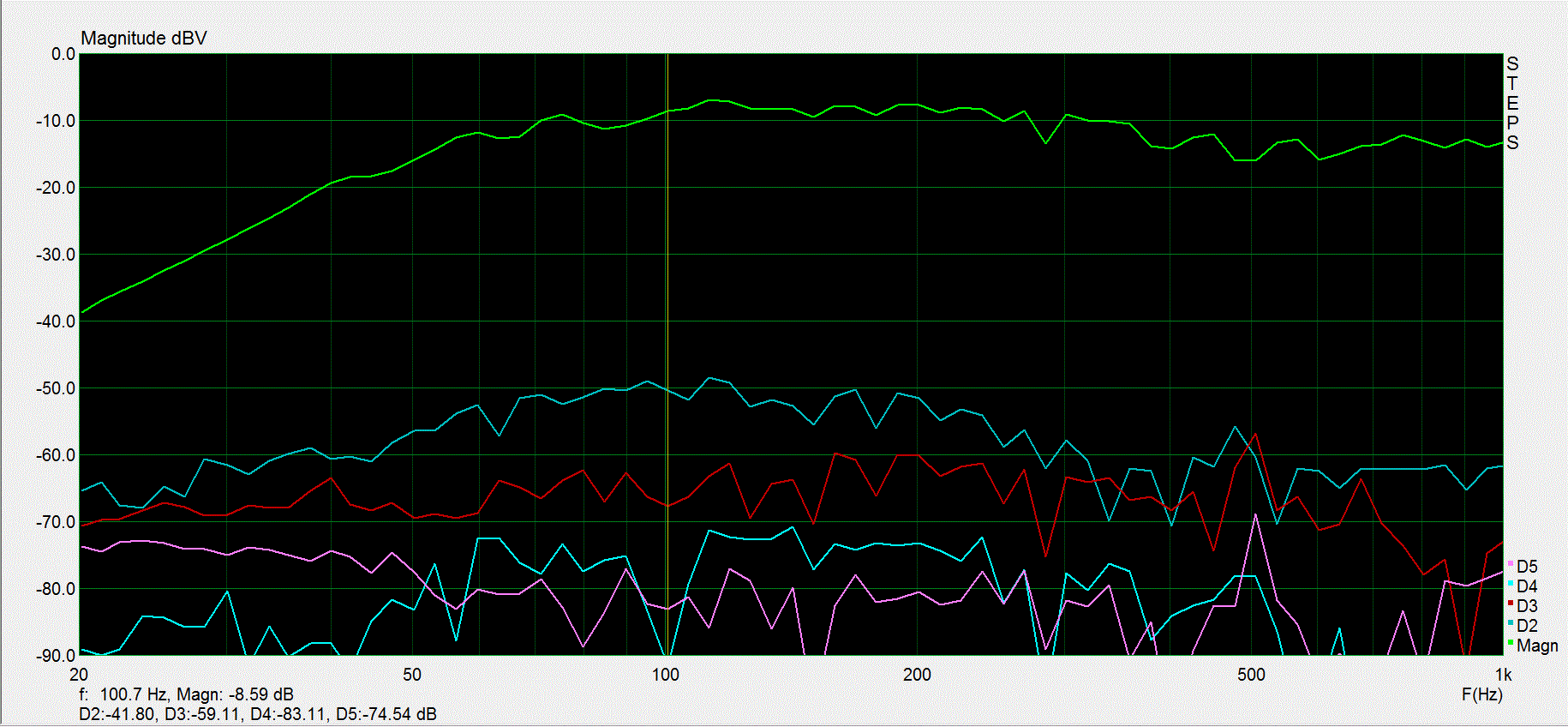

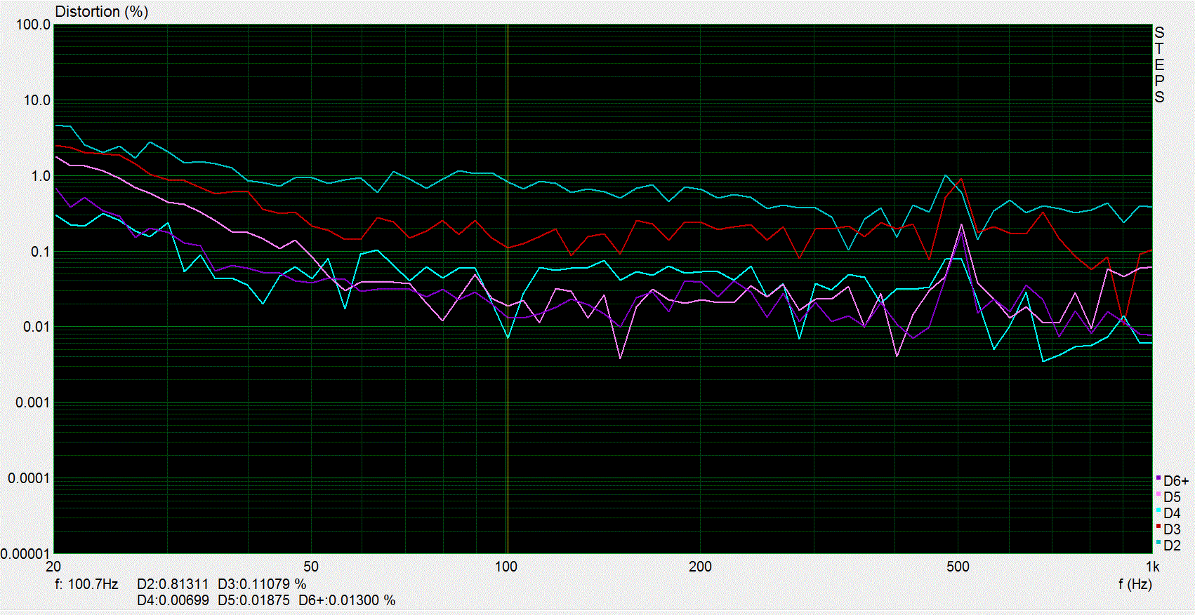

Slowly rising distortion with decreasing frequency is not unusual in bass drivers. For comparison here are my distortion measurements of an RS225 in a ~12 litre sealed cabinet at 7vRMS, which is about 8dB over standard, so pretty much 95dB nominal.
I did this sweep some time ago and as I was only interested in the lower range I stopped the measurement at 1kHz. Still as you can see things are quite a bit cleaner than with your plot.
I don't think the third order peak is presenting itself as a problem, which is nice to see. What bothers me though are the spikes of distortion at frequencies you would not expect to see it at.
The spikes centred around 1kHz are worrying as is the spike at 100Hz and then once again the large rise at 30-40Hz.
At the moment we do not know where the 1kHz spikes are coming from, with the 1st order electrical xover there is so much driver overlap that it could really be coming from anywhere. I would measure the drivers individually to see what's what.
The lower frequency spikes are most likely something vibrating, either the cabinet or something in the room. You can see a post about this here.
http://www.htguide.com/forum/showthread.php?42675-Speaker-Distortion
The peak in this case was caused by a loose driver screw. This was either causing air to chuff out through the hole, or causing the basket to vibrate. Neither are good and you can see the effects in his measurements.
Really though, small sealed cabinets with LTs applied are going to be exposed to rather large internal pressure changes, especially if you've got a bass driver with a healthy amount of xmax, like the RS225 has. If you like this approach and the RS225 then I would definitely recommend you build a nice solid box out of MDF or similar.
