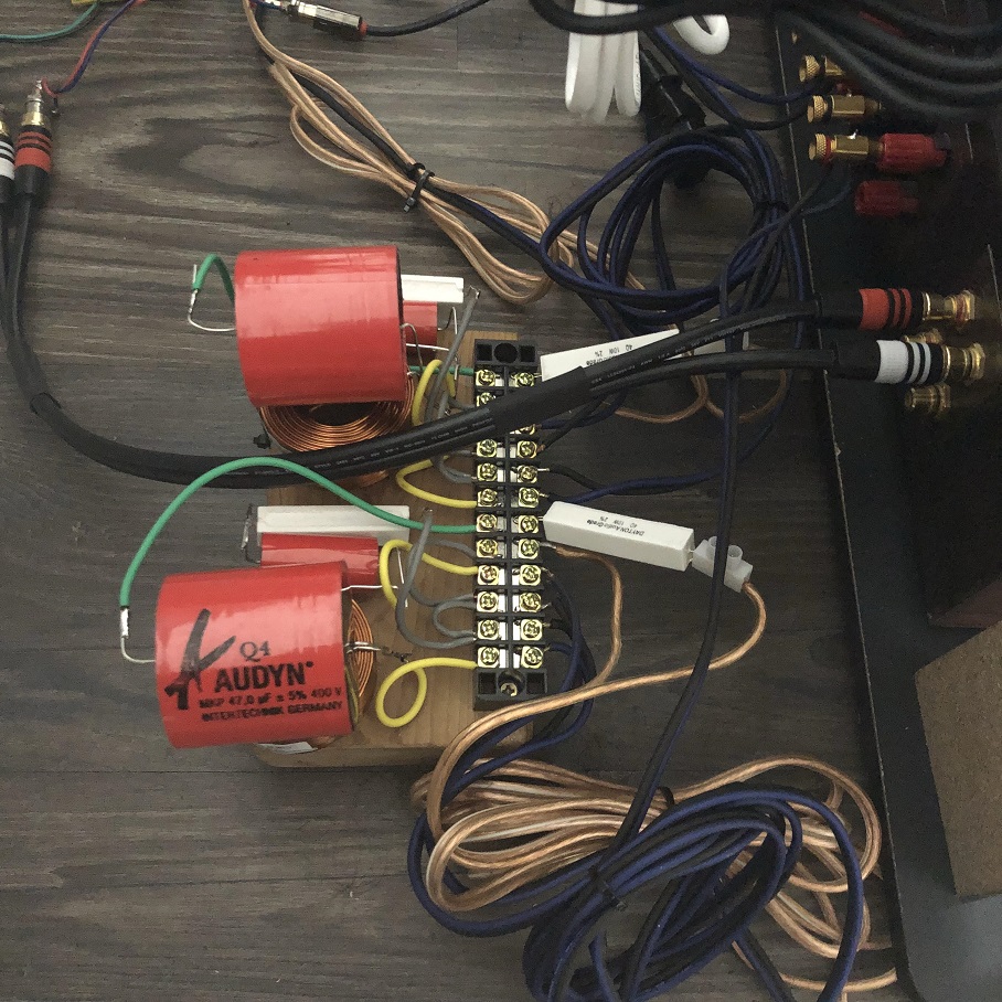

anyhow, i did a quick point to point and put the crossover together last night, i put 4.7uf and .51ohm in series and parallel with the woofer and it sounded abit bright so i added the 4 ohm padding in series w FR. didn't have time to listen to it for that long, but after a few hours here is my first impression :

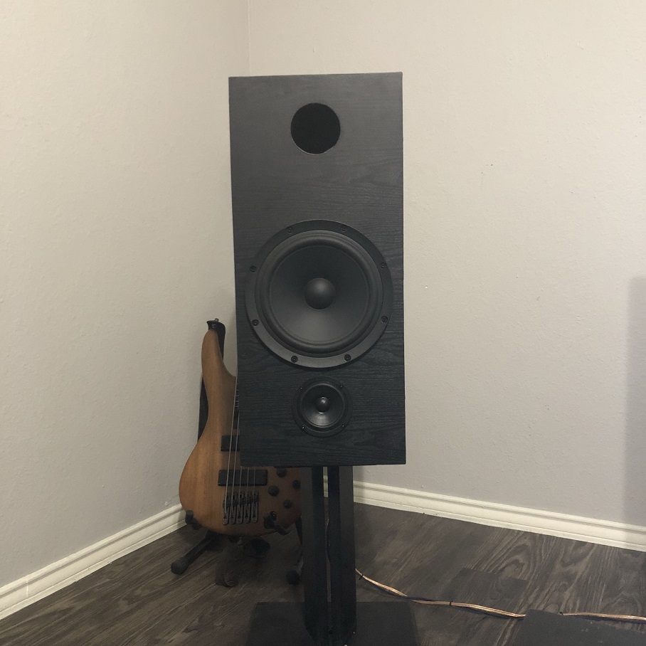

interesting, hopefully i ll get to do some measurements soon. for now i have the speakers upside down, the woofer is not high enough to be at listening position but it still sound much better, like everything is better balanced and bass is beautiful. i really like the SBAs and i m already thinking about a new set of cabinets since it looks weird upside down 😀.

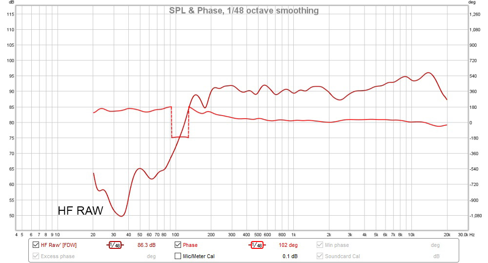

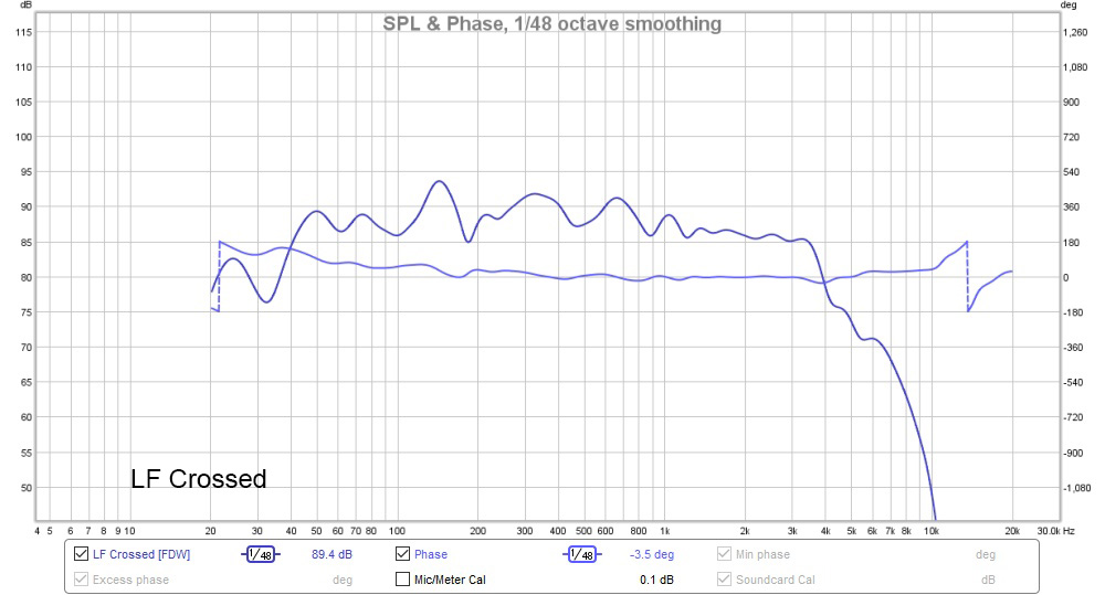

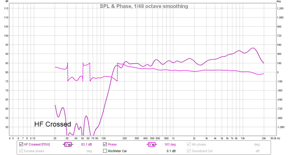

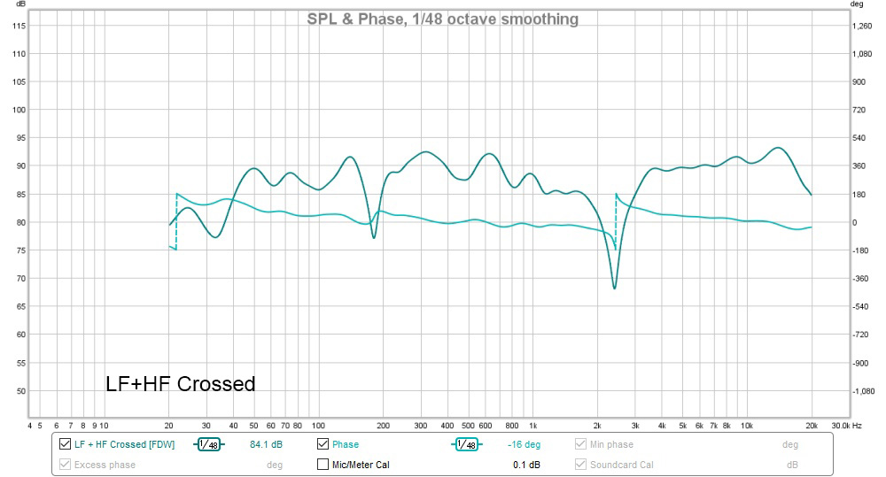

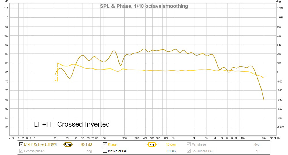

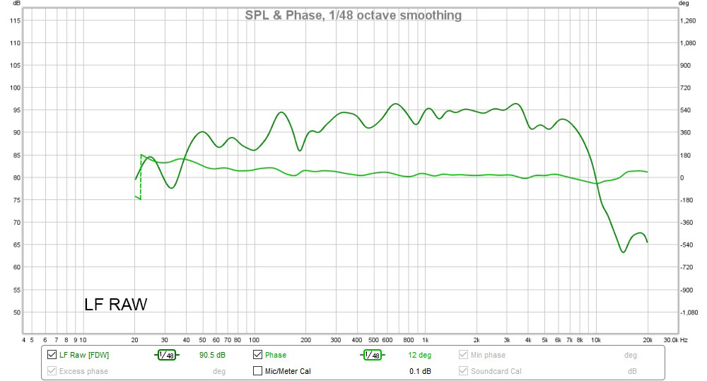

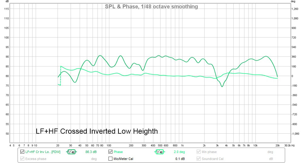

So I finally got a chance to measure the speaker w passive XO, and there s an insane DIP at 2K , at first I thought it is comb filtering but the dip is gone when i removed the crossover and measure the raw speaker in cabinet, the dip even exist when i flip the speaker, what do you think ?!

Hi Aatto if target is 1st order then slopes looks way off.
HF section comments: HF RAW plot verse HF CROSSED are looking close to each other which they should not, HF CROSSED looks ala close to a 6th order 150Hz slope, from HF RAW we can predict/set a lowest possible target to about 950Hz because 1st order is supposed to be only 20dB down a decade below XO point.
LF section comments: LF CROSSED plot looks ala close to a 3rd order 3500Hz slope so low pass point is way too high and interfere with HF section, also phase looks weird in when amplitude fall off phase should also fall off to advance direction where plot actual show it goes in lacking direction.
General comments: Maybe use a amplitude scale set to about 50dB or up to 80dB coverage, and set phase scale from -180-360º up to +180-360º. Such settings will help look for interference reflections or bad microphone position, look for wherever there is ripple in amplitude or phase there shall also be ripple in the other one else there is interference finding place, also one can look for whereever a slope falls off its phase shall turn 90º per order in lacking direction for high pass slopes and in advanced direction for low pass slopes.
