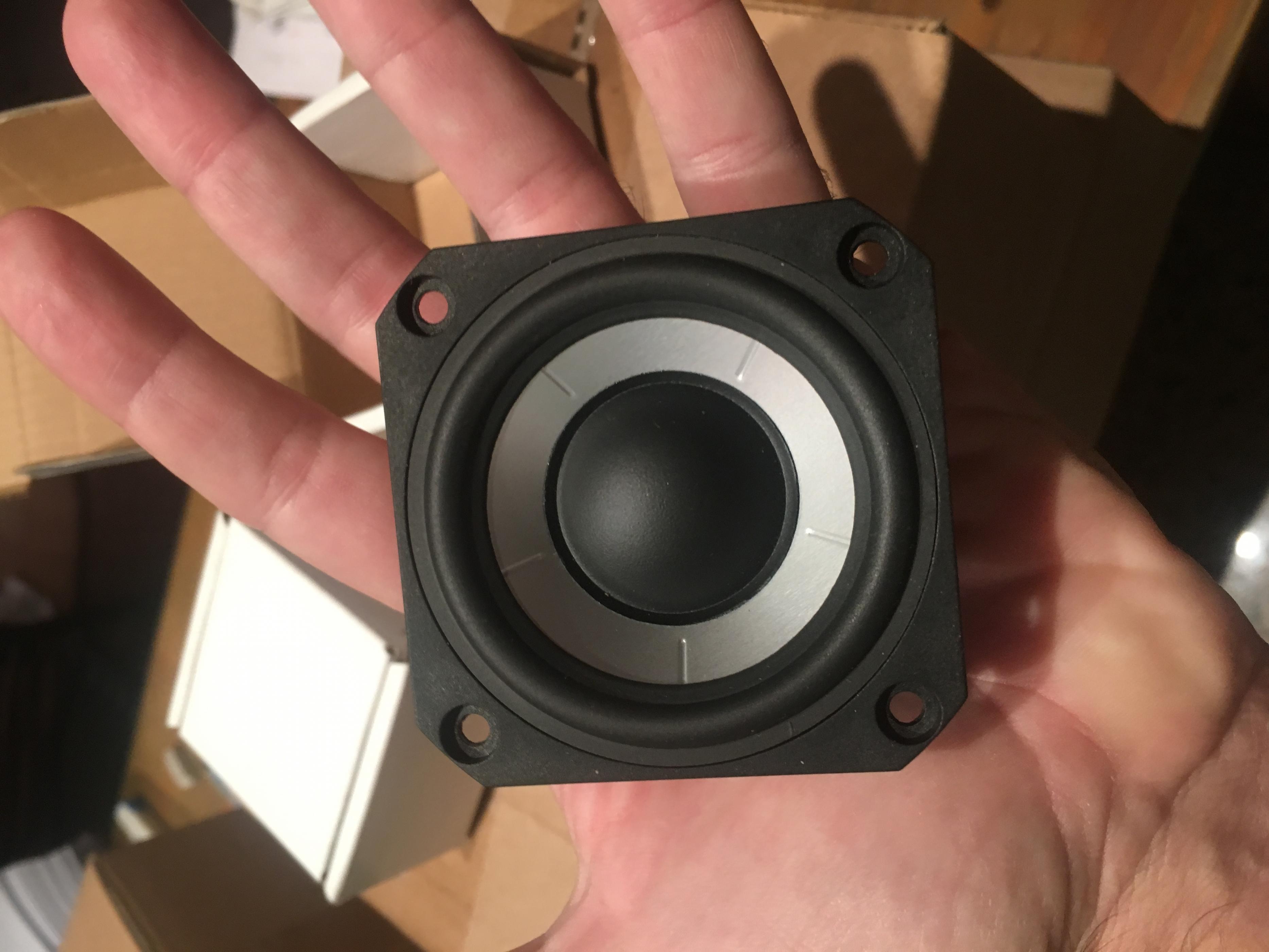

Looks like Santa forgot something and came in with a late delivery!
And it looks like the SBA WFW will be in action sometime in the near future!
Don't know when exactly as we are about to start our 3-week vacation here (Chinese New Year) and I doubt I'll stay around the house much!

PS. It's very nice of SBA to already install a gasket on all the drivers. Nice touch!
PPS. That 2.5" is tiny!

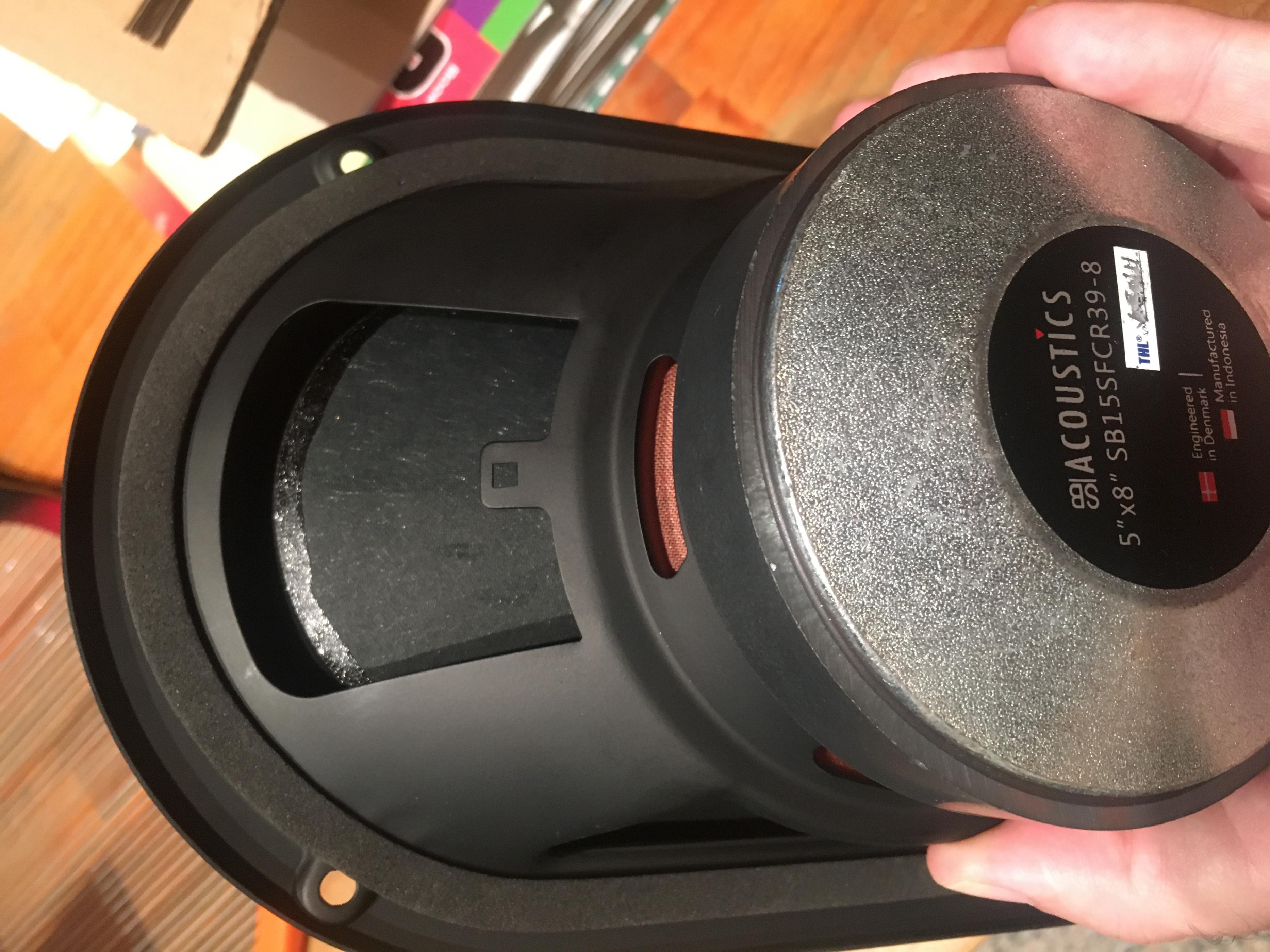

Great toys there perceval, have a best vacation and we look forward follow your thread : )

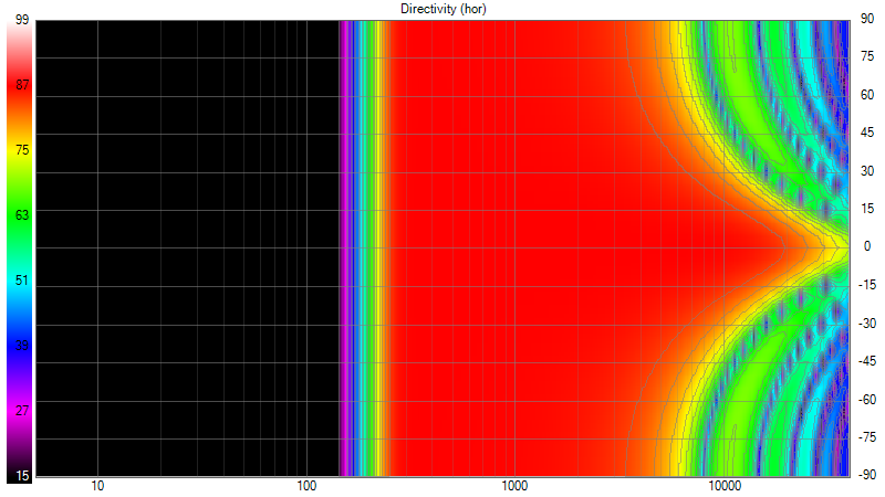

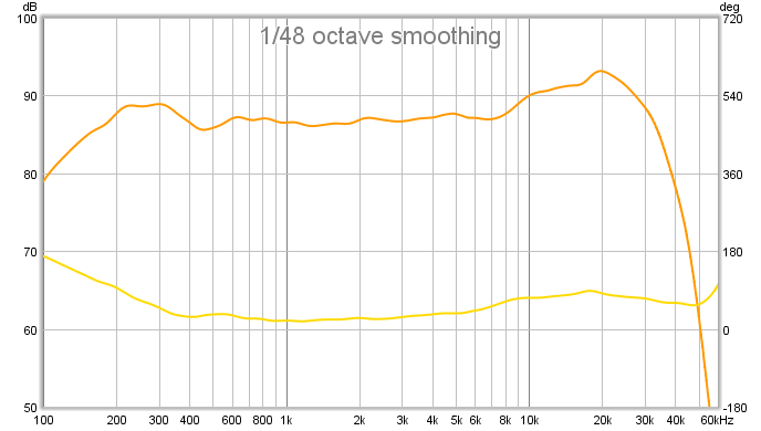

Agree SB65 is tiny, then again size help it covers 30kHz or some and be kind of omni spreader in theoretical you get 180º coverage up to about 4,6kHz area, 90º coverage at 6,5kHz, and 60º coverage at 9kHz, so it should play a good omni like coverage inside your living room as your saxophone will do : )
Guess on wall and using DSP for that build it should be possible make wonders if SPL target is within recommended 83-86dB range.

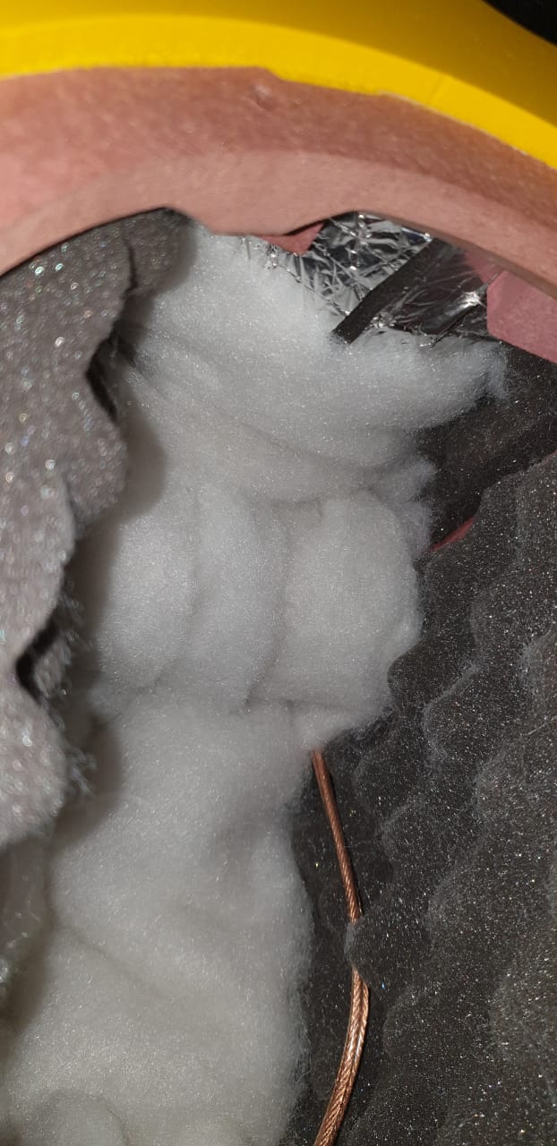

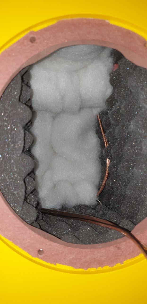

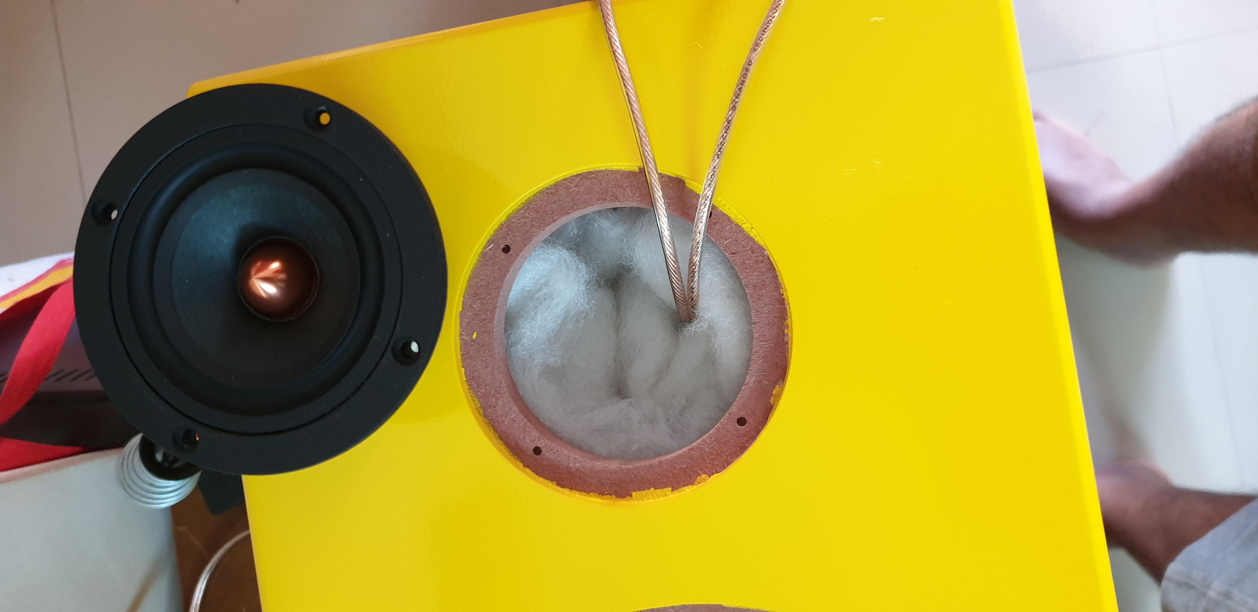

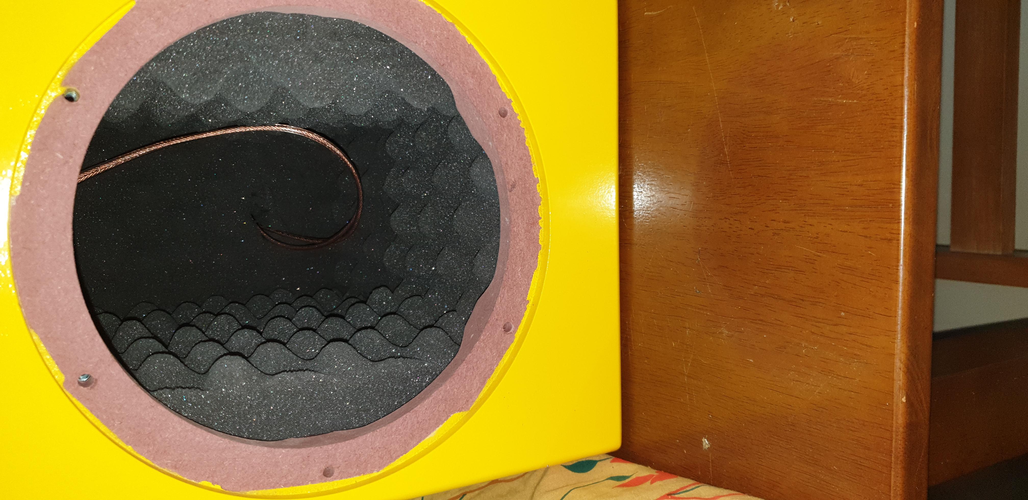

Don't worry about it - just use a good average density amount and stick it in all the nooks and crannies around the Dagger, etc but leave some breathing room directly around the basket. Stuffing is easily adjusted by taking woofer off. But if I were to guess, I would say an average density to completely fill inside except for 3in behind woofer, so maybe 20 to 22L of stuffing in its expanded volume. But, just put some in and test it - chances are you will be fine. I would show photo but never take a photo of the stuffing before driver is screwed on.

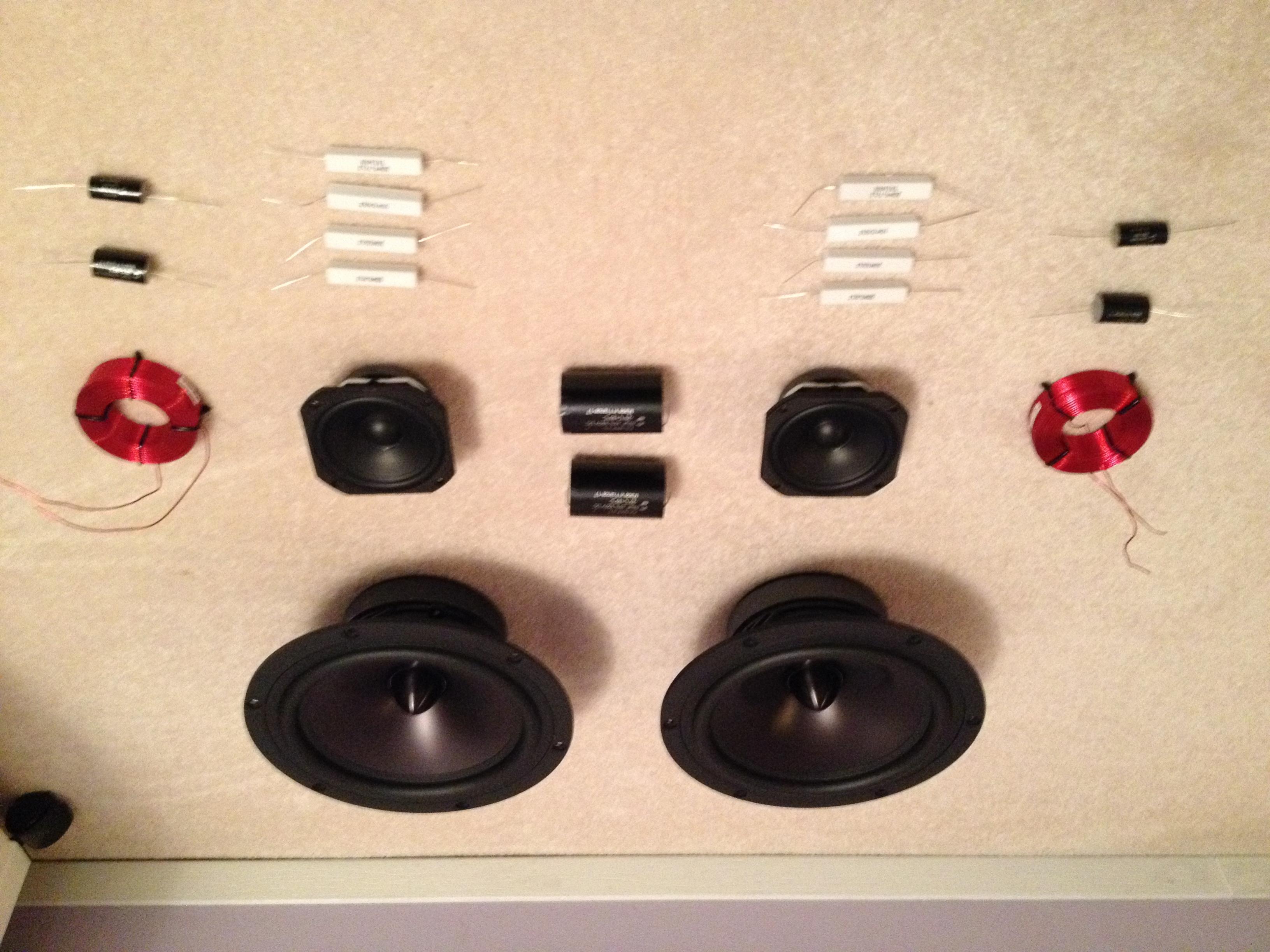

Hi guys, just wanted to say that I've decided to join the WAW club and build these speakers! I'd like to thank xrk971 for making the designs available. I've looked at dozens of diy speaker designs and this one really stood out. I like the idea of getting the perfect time alignment of a single full range driver without the limited low/top end and excessive beaming.
In Canada the Scan Speak 10F is very expensive, so I went with the lower cost TC9FD. I got some nice crossover components to go with it though! I lowered the value of R1 to 2.2 ohms to compensate for the lower sensitivity of the TC9FD (even that might be too much attenuation). Other minor differences include 3.9mH inductors, 0.5 ohm resistors for R5, 4.3 uF caps for C3, and 62 uF for C2. Hopefully these changes won't alter the response too drastically.
Hopefully I'll get these speakers up and running soon enough, so I too can enjoy transient perfect sound!

Nice to see another one of these speakers in the works.
TC9FD is a fine driver for this speaker - you won’t be disappointed. The real star of this speaker is really the RS225-8. There really isn’t a replacement for it, even in a much higher price bracket. It has a smooth broad coverage that is very tight and deliberate while not being harsh.
I am listening to mine right now with a 50w SE Class A MOAMOFO. Playing Metallica’s “One” at present and I have to say, it’s one of the best presentations of this song I have heard.
