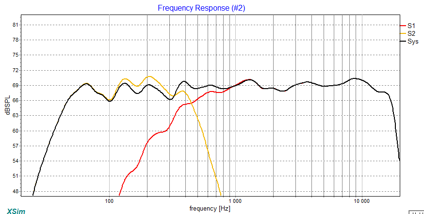

Thanks, wxn! As I recall, you are running SB23 woofers and TG9FD. But this is possible because you are using active crossover. And are you still running the Harsch XO?

Thanks guys.
I'm currently driving them with a 12 WPC Class-D amp, but I am currently building an Amp Camp Amp for them. Should make them plenty loud enough for my needs, but who knows, I might get something more powerful in the future.
The pipe just bridges the front and back panels inside to isolate the TC9FD from the main enclosure, and it's open to free air at the back like a port tube. It's located behind the TC9FD and exits through a hole in the back panel.
I did that instead of the three sided pyramid enclosure because the TC9FD I'm using has a much higher QTs than the ScanSpeak driver XRK uses.
Yes I am! Got it dialed in once and forgot about it, only doing occasional global eq corrections to optimize for listening position - the benefits of DSP

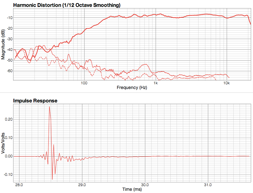

OK, i have now in my possession a pair of rs225 and tc9fd for the project. Initially, i ordered the b80 but decided to send them back unheard, because my experience with the TB w3-881sjf really got possession of my soul, so to speak, and wanted to try a driver as smooth as possible, because i new it (TB) would not cut it for serious neutral speakers, although it has it's vertues. Also, for the price, not a big risk...
So i recently i put my little toe in the water and let the music play on the rs225 in free air....just to get a taste. I'm very impressed with the speed and detail. This is pretty much my first seriuous speaker build, so i don't have experience, but if the characteristics translate into the closed box, i would be satisfied. Probably the big magnet and stiff alu cone helps with bass. in any case, i have to wait for the enclosure for serious evaluation.
I put the tc9fd in a little bass reflex i made without any filter, also to give a taste, and was immediately surprised how easy to listen it was. Much more smooth than the TB and bass was full, though not as tight, but just well balanced and voices sounds very realistic. The only problem i had with it was the «detail» or «speed»: it sounded a bit dull, unexciting and uninvolving, though my iphone didn't detect distortion above 0,3% or so, for what it's worth. i also put a high pass to simulate the fast driver setup, and saw almost no difference, as opposed to the TB which gets better with each reduction of excursion (this one is UBER detailed with a 2nd order high pass around 500hz).
BUT, i noticed how stiff the rubber surround was (especially for a paper cone) with the tc9fd and decided to run them a few hours.
Now after around 30 hours, at normal listening level, it still sounds pretty much the same unfiltered, but with a high pass 1st order, it sounds like alleviated from a burden a little, and instruments start to come to life, which is promising.
So more to come...
And my recommendation for any tc9fd owners is let them run in without filter before evaluation, if you find them uninvolving and dull and a bit rough...

Just wanted to precise what i'm hearing from tc9fd VS w3-881sjf : by «smooth», i mean flat response with minimum dips and spikes...that is what i aim for. Both are are unaggressive to listen to, the TB has an ease to present the music and there is a very good definition to music ( especially the high spectrum), ...not straining at all, but it's like there is something missing,it can be spectacular sometimes when cross with a 2nd order, but when you hear voices they are more real with the tc9fd, probably due to the response. inside the little bass reflex, all alone, i couldn't fault it much (tc9fd) and is good as is and would make a good cheap speaker by itself ,except the lack of «detail», which is now better with a high pass at 500Hz, as i burnt them in.
Jenghis,
The bass is lean compared to what more precisely...other 8 inches in sealed cabinets...? Are you damping the cabinet because it resonates?
many things can explain lack of bass extension. i'm far from an expert, but i would look at the cabinet to see if i can brace further, if it sounds boxy. Also, i would say the source of music makes a huge impact on bass extension. Cheap dacs with cheap psus and digital portion like clocking can make the sound «lean». Also, it could be an illusion: i noticed that when bass gets tighter, ther is apparence of less of it.
Alternatively, bass reflex would most certainly boost bass output, in general.
