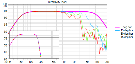

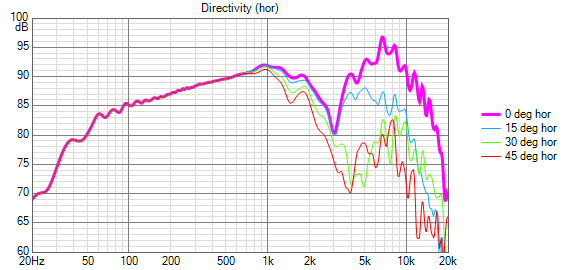

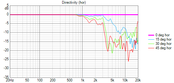

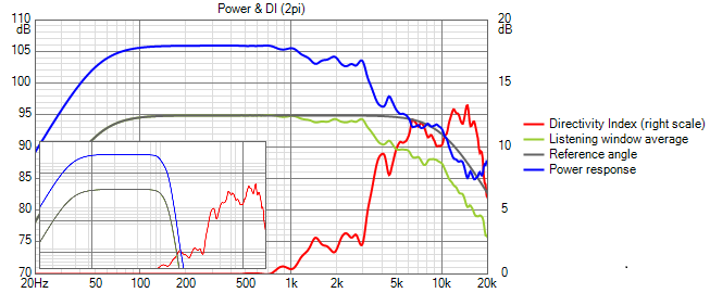

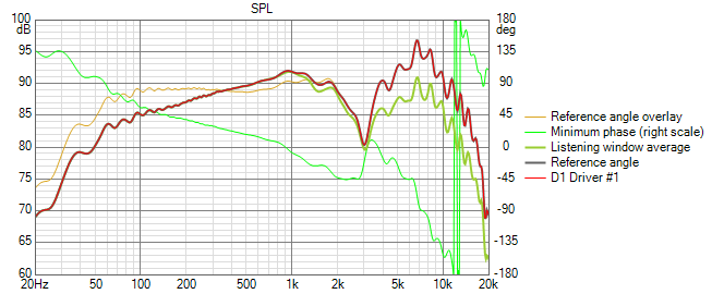

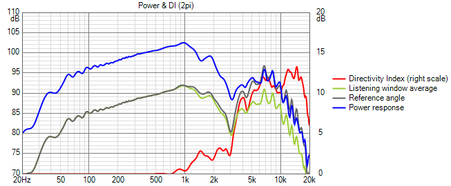

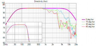

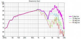

Well then here is some visual realistic model from VituixCAD to help what objective data you did listen to provided position was exactly on axis
Technical below use the four axis one can download from Dayton audio, then low end was EQed to cover a sealed 52Hz BW2 high pass filter seen as orange curve, and then estimated bafflestep and difraction was added to orange curve so red is final sum without any room modes, text at right covers colour of curves.
Same as above normalized.
I'm sorry Byrtt, I am having a hard time following what you are trying to show with the graphs? Are you saying that listening to the RS225 by iteself lacks realism because of the rising response which causes timing artifacts? Nice graphs btw. Looks like you are using VituixCAD for all your frequency response plotting needs lately...

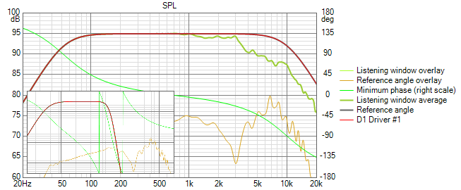

First take a look at on axis response in my previos post over its wide band, well i don't know why some has touted that response to be any smooth or good as a reproducer over a wide band pass so why should it ever sound realistic used in that wide mode, now eat all the curves in all the three graphs and one will notice it doesn't matter if one sit near field or at listening position because we have huge distortions relative to optimal that set in because of the wide band used for a relative huge diameter ALU cone transducer, we should though remember that simulation lack any roommodes from pidesd's home but the rest is a realistic estimation for his simple setup there and guess if he goes near field within 1 meter or so on axis we can ignore the room model is missing. Regarding time artifacts there is one huge happening at about 3kHz area where ampitude drops out causing the minimum phase to take a sharp hit >45º and that one will ruin or manipulate natural harmonics time lineup belonging to deeper basetones (read ruin/manipulate a realistic or natural reproduced sound). Then comes the huge Le value factor that cause time artifact when used wide band, know its absolutely normal for woofers to have huge Le value and nothing wrong with that but also most woofers are engineer or expected to have a pass band only in lows so that relative high Le value don't mean so much. The time artifacts of high Le value are not talked about or published much anywhere and not shure myself can explain/understand subject as deep as a pro would in remember myself is nothing but a interested hobby diy'er, but so far for me it looks be a time artifact because we use a voltage source to feed a current load, had the phase timing for that current load been flat we have had real relative higher sound resolution or realism or naturals or whatever we call that, but that current phase angle is not flat and the worse Le the worse that current phase angle is, could talk more about Le subject but so far to get at a end : ) can't we just say if high Le was really any good why do mids and tweeters then adopt those high Le numbers.
Now in below if we try same model exercise but this time EQ RS225 flat as a pancake covering a BW2 bandpass from 52Hz to 10kHz curves reveal if we low cut at say 1kHz 8th order LR its bandpass will look almost a perfect woofer reference class as seen into the smaller overlaid graphs in lower left corner, so Dayton probably did a exelent smooth design when used in low end of audio band.
If you guys are interested in subjective sonics from near field on axis position the EQed 52Hz to 10kHz band pass i could share a IR convolution file or one could pre convolute a audio track and share for listening test, also the Le factor can be time convoluted and included but that one takes a heck of a time and need a precise impedance curve taken from enclosure in situation for RS225.
I agree the RS225-8 isn’t going to sound pretty raw. It’s got serious breakup modes as most woofers have. Put it through the recommend XO and notice the response. This is on axis (red curve), it blends with the full range (green curve) to produce the blended blue curve.
All this has +/-2.5deg of phase variation from 200Hz to 15kHz. This is what allows it to sound realistic with great time accuracy and the imaging is very clear.
