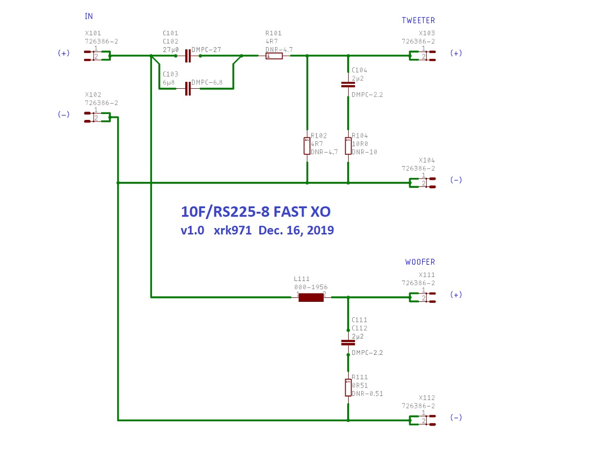

Like OntMax, I'm considering building a pair with 2xRS225-8s, Several yeas ago I won 4x 10F/4424s and hope these will work. If I drive the 225s in parallel, is it 'simply' a matter of doubling and halving the component values in your crossover design? Nothing's that simple, but would I end up in a position to make relatively small changes in values get to a very good result?
Yes that is what I am doing. 2.0mh main coil. 8.8uf and .47+.47 r's in parallel (I wonder if .235 ohms is even audible)

Has anyone done a XO for a 3FE25 & RS225? I'm currently playing with a 3FE25 (full range) and RS225 (crossed @ 200Hz) in a tower - it started out as a RS Duet, sort of (RS28A + SEOS-8 & RS225). Tower is approx. 1.6 cu.ft. tuned @ 30Hz via a down-fired 3" precision port.
It’s the same xo - just adjust the padding resistors to attenuate the higher 91dB sensitivity more.
Make R1 bigger and R2 smaller but keep sum equal to 10ohms.
Maybe circa 6.8R and 2.7R. Or 8.2R and 2.2R? Measurements will show proper setting or your ear will tell you it’s too bright. Don’t do it so much that it gets the life squeezed out of it though.

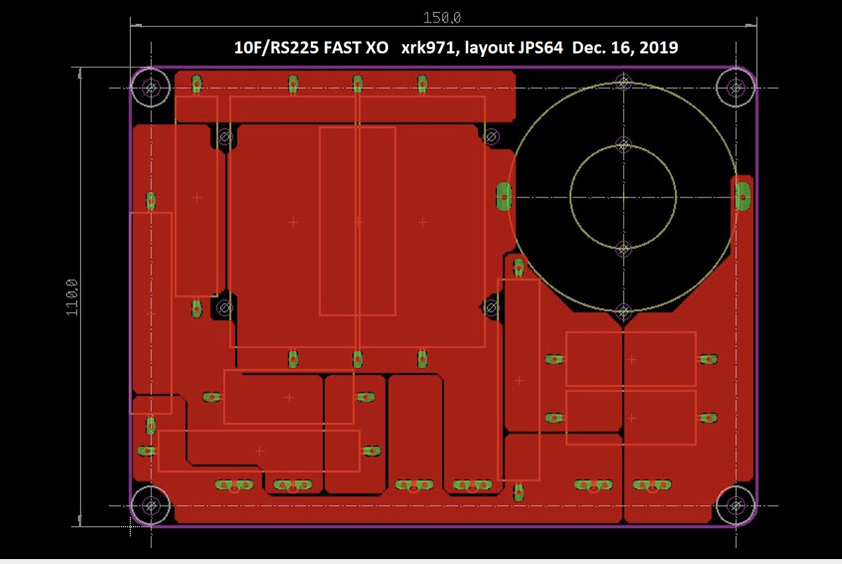

The 10F/RS225 FAST XO PCB is taking shape nicelly thanks to JPS64's superb layout skills.
Thank you, JPS64!![worship :worship: :worship:](https://files.diyaudio.com/forums/images/smilies/worship.gif)
Preliminary layout (will add holes for optional flying leads plus standard spade connectors):
