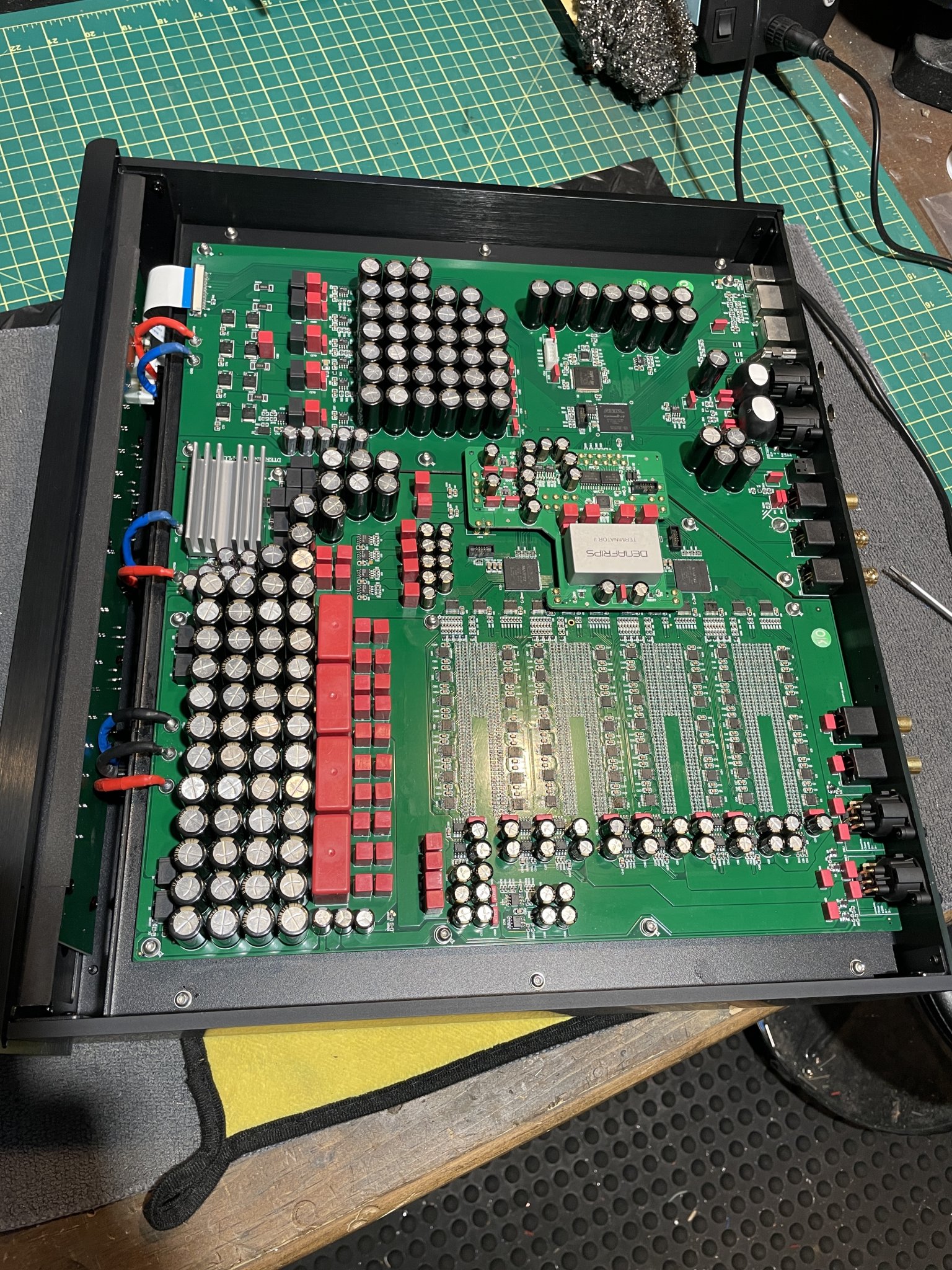

Wow. There's lotsa 'lytics in there.Here is a photo of my DAC. Notice they used polyester WIMA .1uF as power IC bypass. What do you think of this, if I understand it right, especially for a high speed circuit, maybe NP0 could have been the better choice? Any thoughts on this? Notice below the ladders and power ICs.

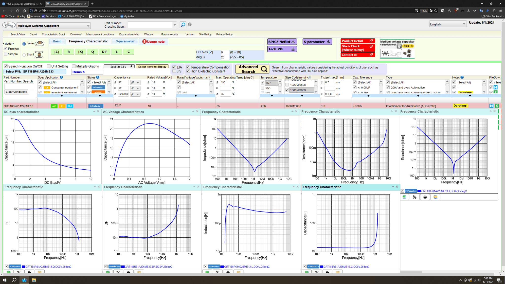

I've seen many class 2 ceramic capacitor datasheets that don't say anything about the nonlinearity, that actually hardly contain any data at all besides case sizes and ordering codes. If you are lucky, you may then still find information about the nonlinearity and about the performance in general somewhere on the manufacturer's website.
For the higher capacitance values, it's not unusual for the capacitance to drop to one fifth of the original value when you apply the nominal working voltage. That's bad enough to be an issue even when you only want to decouple a supply.
Yes. That's why you need to measure the nonlinearity. Even from the same manufacturer lower voltage class2 ceramic capacitors may actually have more capacitance left than higher voltage caps with same dielectric at same DC.I've seen many class 2 ceramic capacitor datasheets that don't say anything about the nonlinearity, that actually hardly contain any data at all besides case sizes and ordering codes.
Again, Murata's online SimSurfing tool is worth playing with. Here's a screenshot of some graphs for a random 22uF 10V X5R 0603 cap...I'd rather select a manufacturer that does specify it.

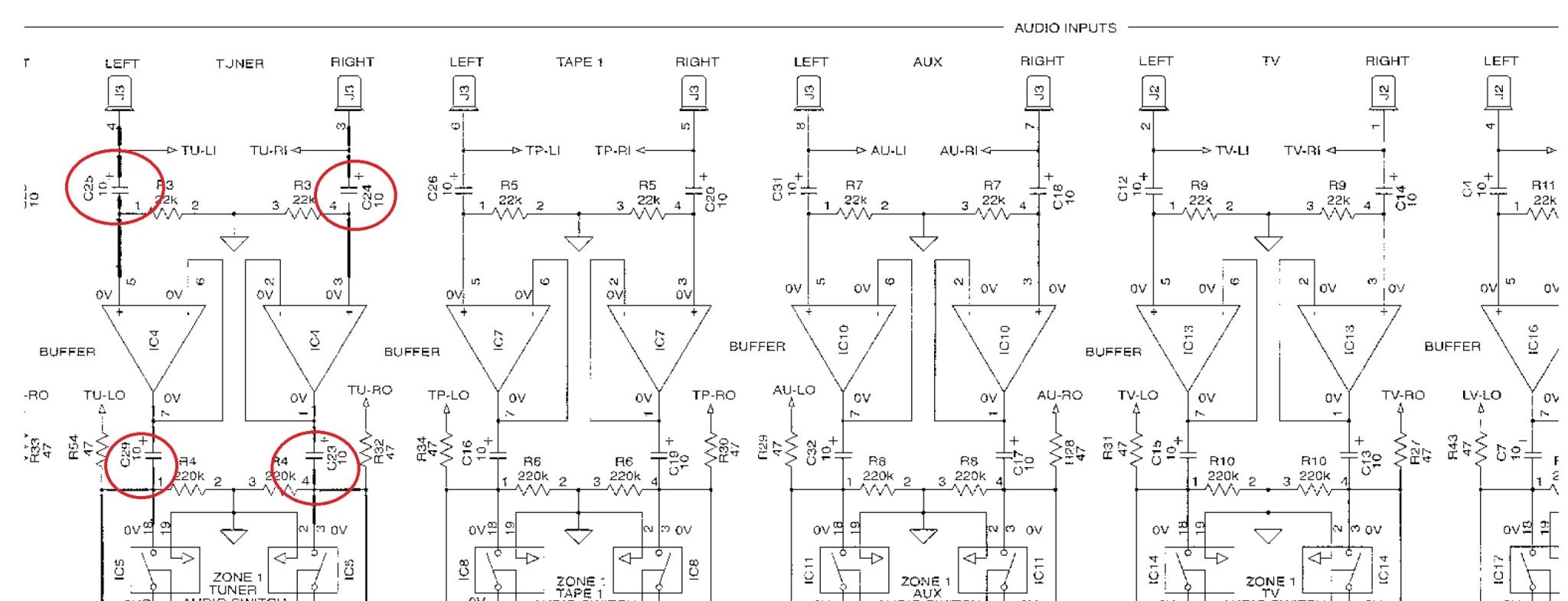

Leave the 10 uF capacitors in. They give the best THD values. You could increase the 22k resistors to 100k. That is healthier for the frequency response.Considering replacing electrolytics on input with 10uf ceramics. What do you think of that, improvement in sound, further degradation from electrolytic? Suspect lytics are drifting as each other one in this preamp was. Here is a snip from the schematic.
