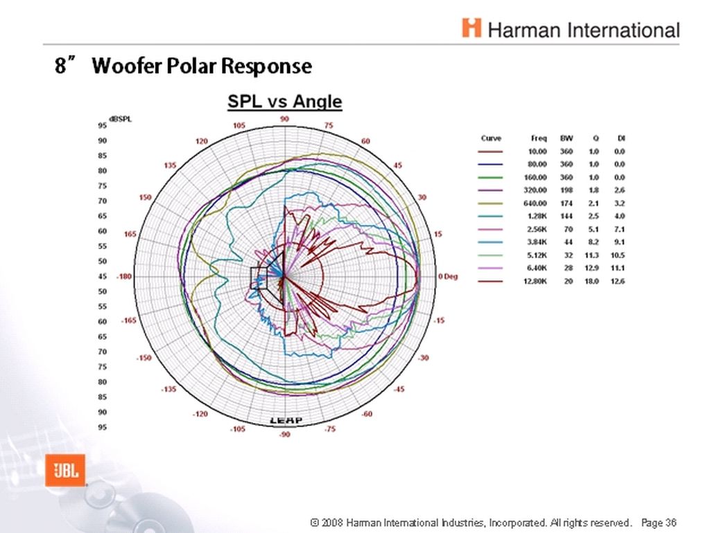

can you expand on this. what do you mean? A 12 inch is better or worse then a 8inch?
If you try to cross a 12" driver at 1200Hz you are going to have a poor off axis polar response.
Yes, aside from cone break up (resonances) of larger cones at the higher frequency's, Their polar pattern or frequency dispersion pattern gets more narrower for the higher frequency's as the dia meter is in increased.
This is a picture of such a pattern for an 8" woofer.
At 1.2Khz the angle of dispersion is already less as about -5db for +/- 60 degrees off of the center.
The First Blue line.
Its beam width is about +/- 30 degrees or less more about 22.5 degrees for an equal 90db and gets narrower as the frequency goes up.
As at each octave higher this beam width is approximately halved.

the 1.2k polar response is not that bad. Perhaps you forgot to substract the small red 10 hz response?
No, its not for an 8" but for a 12"woofer the 2.56k purple curve will be more what the 1.2k curve would look like.
No, I didn't miss the 10hz curve as I was using the color code anyhow.
Even though 12" is 33% more than 8" woofer it is actually almost double.
The effective diameter of an 8" woofer is about 6" to 7" were a 12" woofer's effective diameter is about 10" to as much as 11.25" on some drivers.
