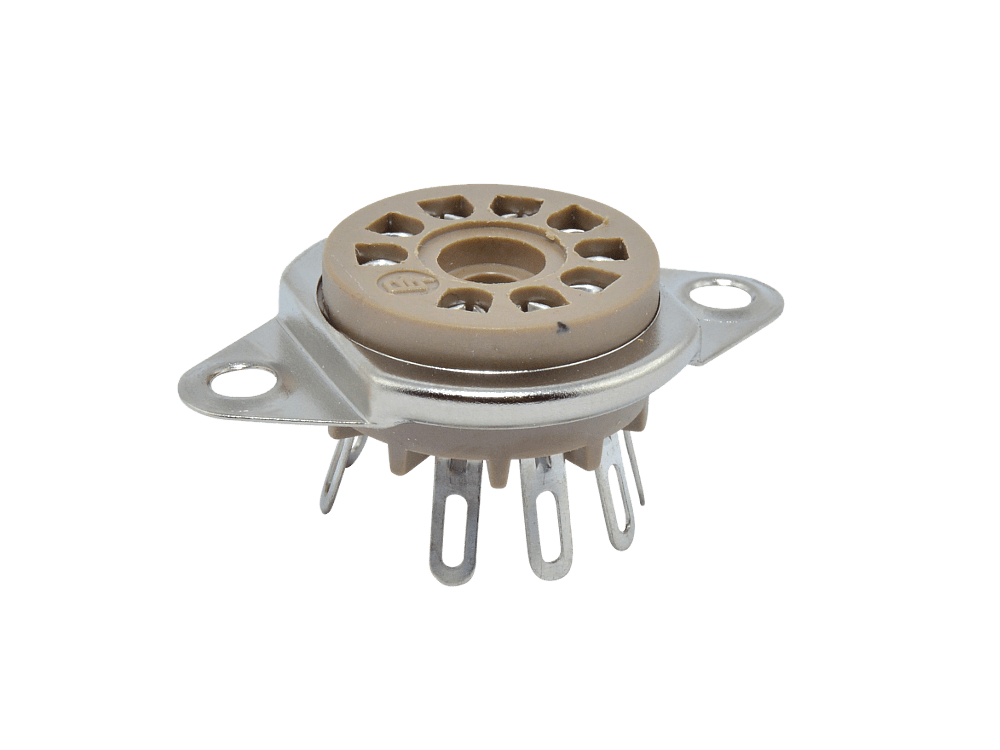

The first picture is of the sockets I want to mount on the top of my enclosure.

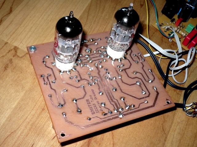

The second one is how the tubes are mounted now.
Out of option is just to raise the PCB to the top of my enclosure. Hence, the wiring from pcb to sockets question.
I did preliminary wiring with non twisted wires but i got quite a lot of hum/buzz.
My thoughts are:
twist and group the wires
i.e.
pin 1 and pin 6 (both anodes)
pin 2 and pin 7 (grids)
pin 3 and pin 8 (cathodes)
pin 4,5 and pin 9 (heaters and common)
each are a separate groups of twisted wires going from pcb to noval socket.
Do I need to have shielded cables?
Also only the tubes will protrude out of the chassis top. All cabling is inside.
Thank You.
The usual method is like in the first photo, with the board mounted on the underside of the top panel,
sockets up, with tubes protruding through holes in the top panel. No extension wires needed.

Bad idea. There's a reason why most do it the way they do, because it works.

Your Noval socket is meant for point to point wiring. Yours is a PCB. Just punch or drill holes in the top panel , and mount the PCB with standoffs. Simple. You said that you don't want to rework the entire enclosure. Can we see a picture of the enclosure?
One technique I have done is to attach a piece of sheet metal on the top panel covering the Noval sockets, then punch properly spaced holes for your PCB. In my project, I added sheet metal covering the entire top panel, of an amp, and then punched all the holes where I wanted. I suck at chassis work, but it wasn't that difficult.

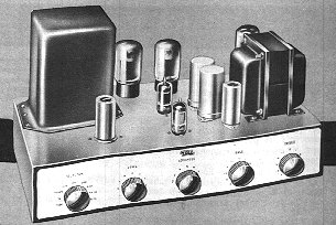

Here are some pictures that might be helpful. I used the chassis and output transformer from an Eico HF-20. The sockets are all chassis mount, but it will work for punched or drilled holes for your PCB.
Original Eico HF-20
Modified monoblock amp. Sheet metal (clear coated brass in this case) screwed at the four corners. Holes were punched with the top plate attached, through both the brass and the top panel of the amp.
If you only need to cover the Noval holes, you could have the sheet metal cut just to that size.
Original Eico HF-20
