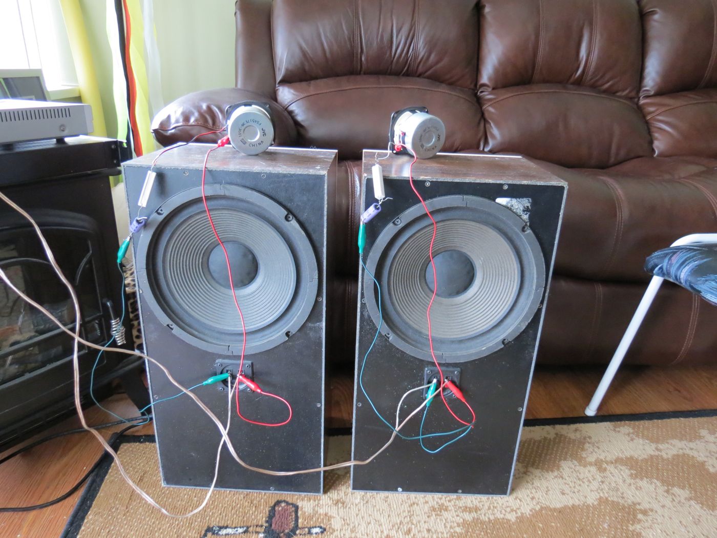

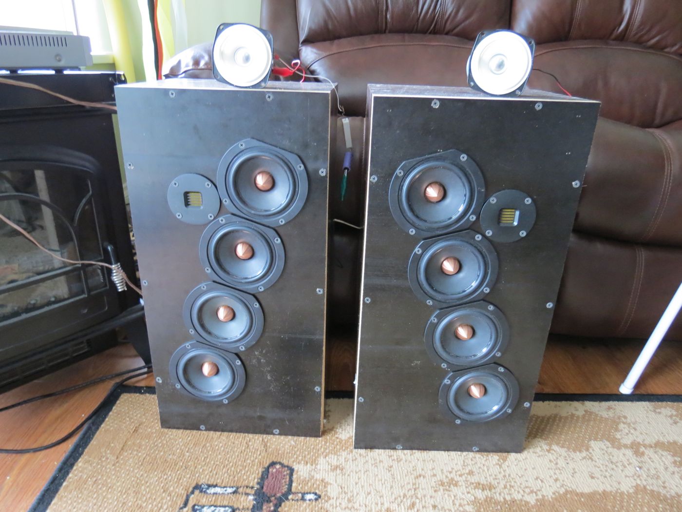

Front and rear.
They started as a 2 way sealed
Then 2.5 way sealed to improve the lower bass.
then 3.5 way sealed to add more mid
then 3.5 way with PR to add more bass
They got better every step of the way and are listenable but there's something about the bass that doesn't work. Not deep enough and it sounds like it's being shot out of a hollow log.

Hi Cal,
Here's a link on PR's.
The Subwoofer DIY Page - Passive Radiator Systems
You may need to add some mass to the 10". Looking at the spec's on the WR125's, the Qts may be a little high (.64) for use in a vented or PR, but they could be tuned down to around 55 hz at best. But maybe more realistically, closer to 60 hz. The total mass of the passive would probably need to be around 60-90 grams (this includes the Mms of the 10").
Some passives come with a stack of weights that can be adjusted. I've seen other diy'ers apply caulking to the cone, starting around the dust cap. You may or may not want to sacrifice the 10" for the sake of experimentation.
Dave, I really appreciate your input and if this just needed some tweeking, I'd be right on it. At this point we're not very close.
You'll note the different stages of the unit with a noticeable improvement each time. By the time you get to this stage and you're not getting close to what you need, you start looking in another direction. I don't think there's anything that can be done at this point.
As always it's nice to bring this to the table for you guys to chew on but this time, I have to hang my head in shame. It's just not going to be the Belle of the ball this year.
