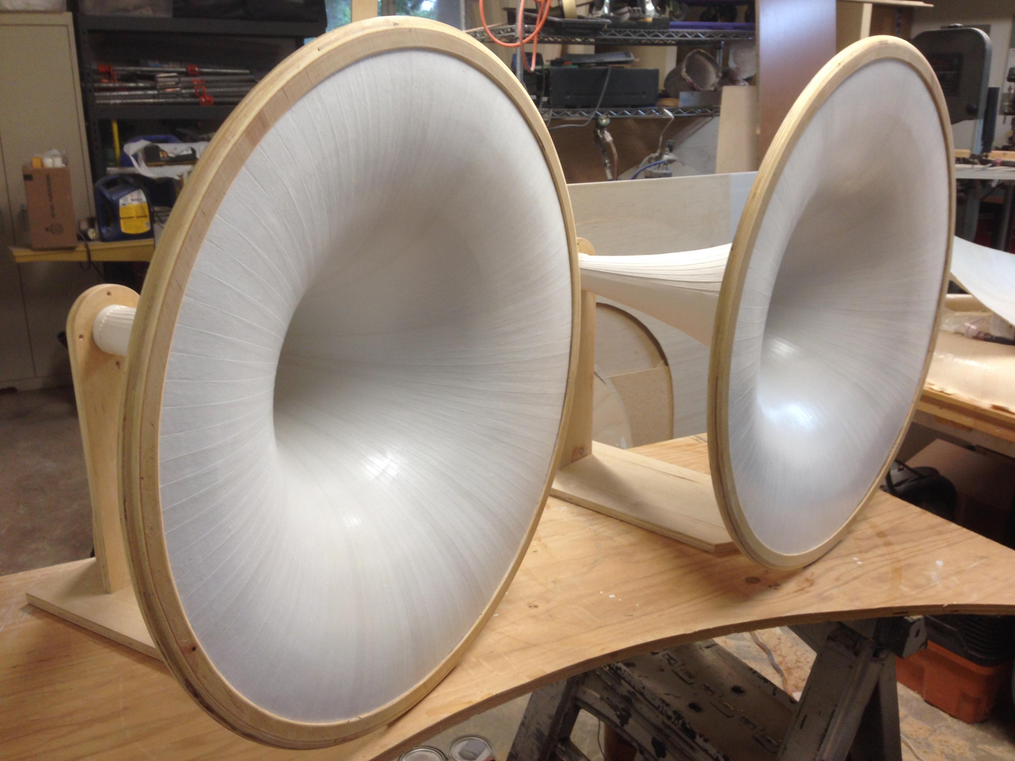

Regarding the length of the mid bass horn: I fabricate paper mache horns that require a longer mid bass section to keep things time aligned. I cross my paper horns at 450 hz, so the power and warmth of the mid bass is present, but the clarity of the high frequency paper mache horn steals the show.
That's a awfully small horn for bass.![]()
Which horn ate you referring to?
the 20 by 20 mouth wooden horn, most of my 500 hz upper midrange horns have a bigger mouth than that
Ahh, well it's not a "bass" horn, it only plays down to 130hz flat or so, drops off sharply from there, but does 130hz to about 800hz very well.
