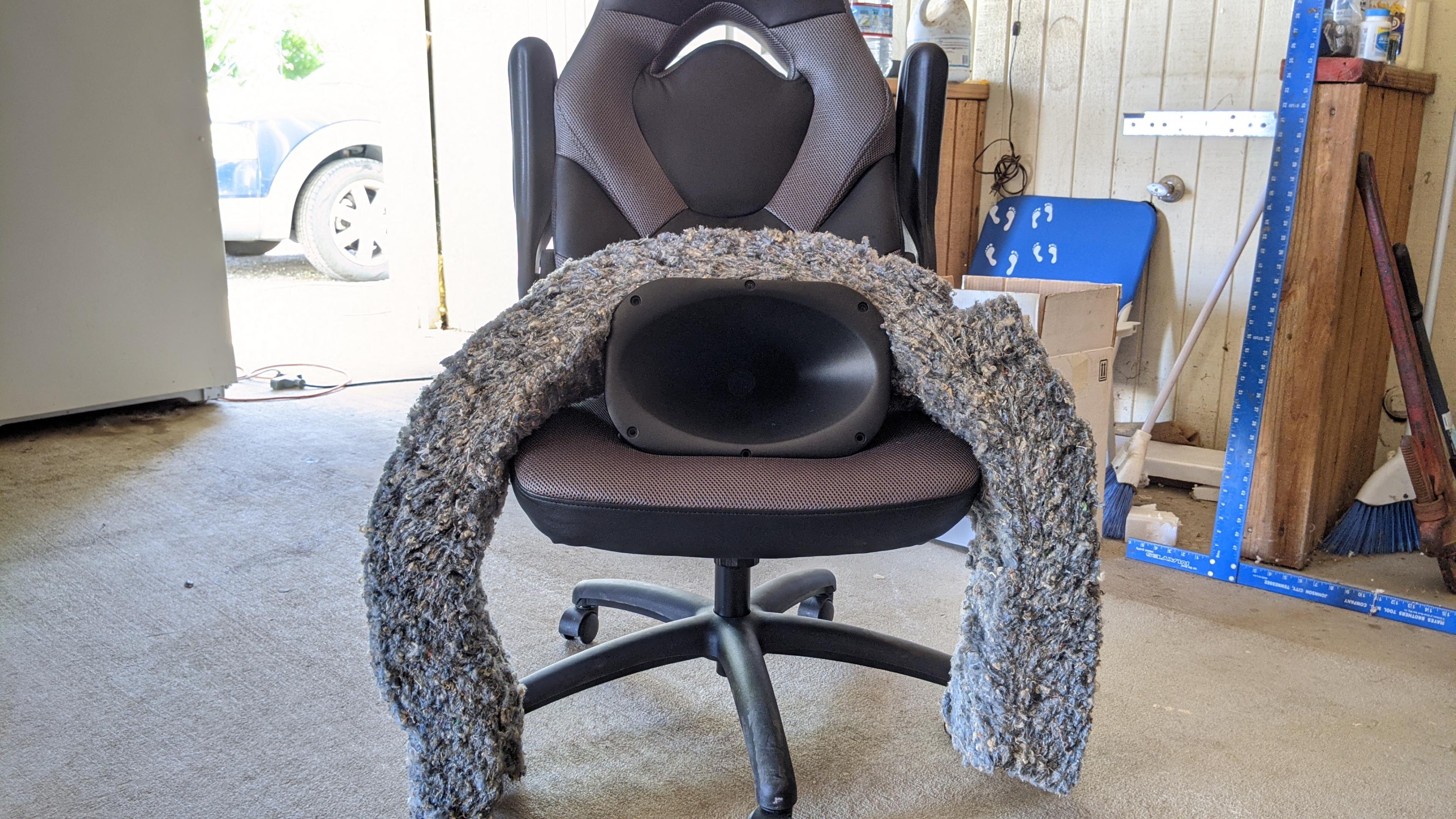

I tried both today in the setup pictured below. Both eq'd nearly flat to 20khz.
The 18 Sound does edge the Radian in the high treble despite the measurements looking nearly identical. More detail and separation in cymbals, acoustic guitar, etc. You can hear cleaner reverb tails.
Not a massive difference but appreciable if you still have some hearing left above 10khz
Otherwise they're pretty much interchangeable.
I wouldn't be too motivated to change horns since you already have the XT1464. I've never tried one but the design is similar overall.
I prefer the Radian over the Faital 146R for the same reason I prefer the 18 Sound over the Radian. More high treble clarity.
Listening to treble only content on any device is not advisable for extended periods of time. Almost sounds like something is broken. The same phasey distortion sound was present with no horns, a dome tweeter, and a full-range.
