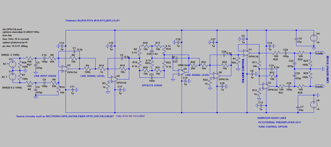

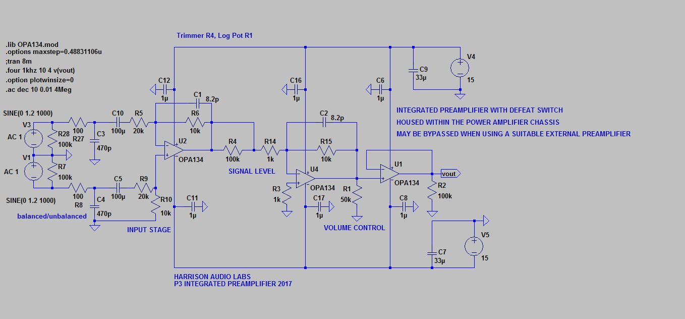

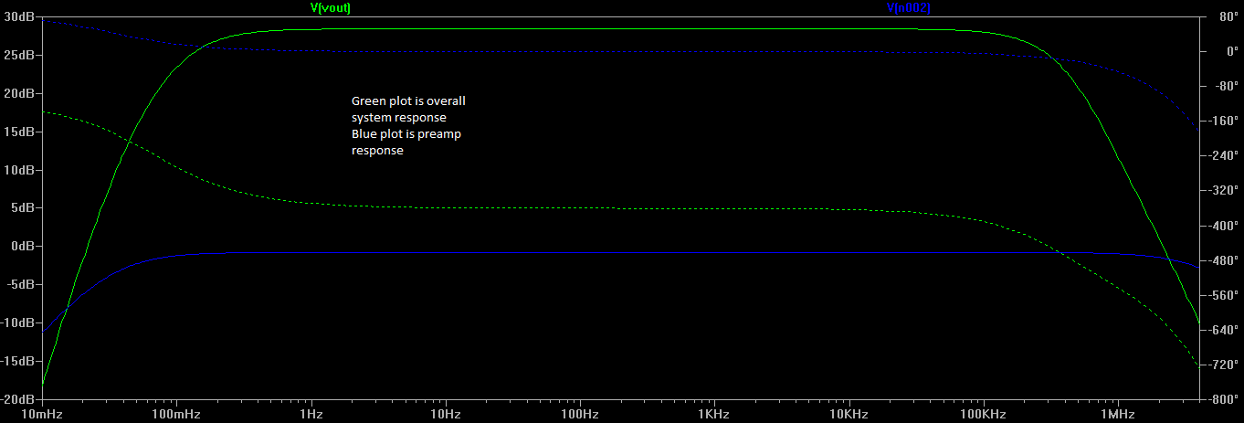

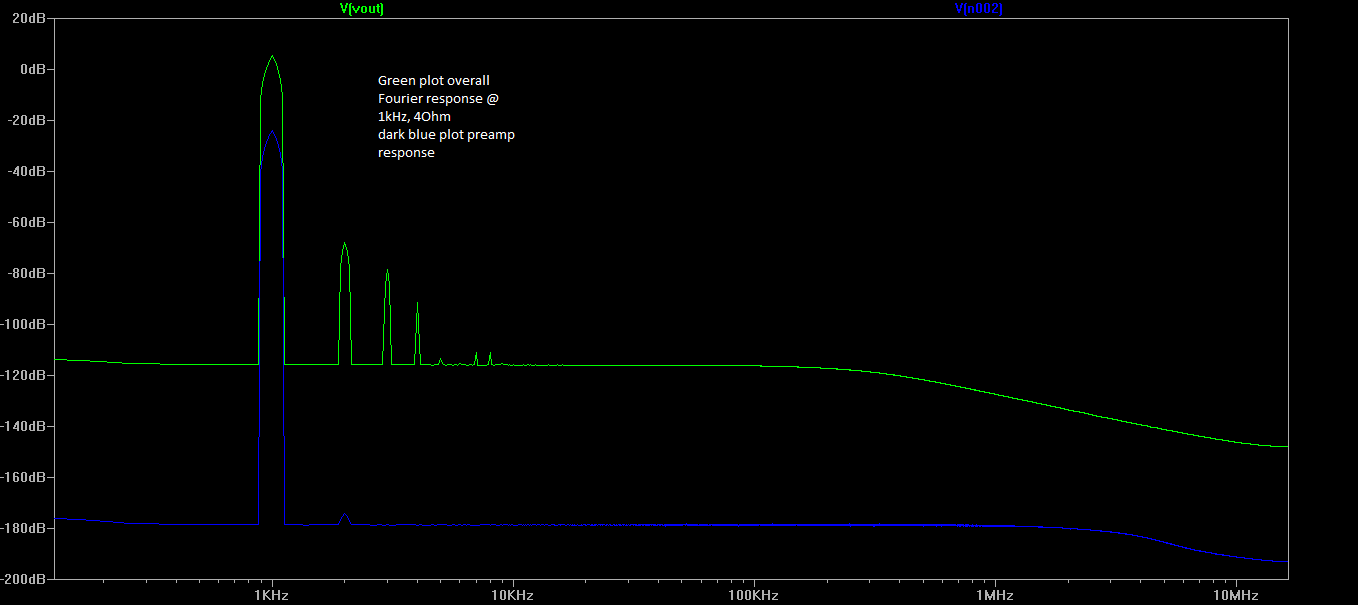

Some simulations of 1diffqc with integrated preamp

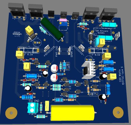

The 1DIFFQC type S amplifier. What are the tradeoffs in the pursuit of lower THD numbers, can you ever have it all? What has adding one more decimal place from 0.04% to 0.001% done to the overall sound signature? One thing that is clear is that the type S has better tolerance for crossover distortion and thus can be biased lower that 100mA, what this means and whether we moved meat from one section and put it in another section or we just added overall heft is something to watch out for.
THD
0.004% 1watt
0.001% full power
