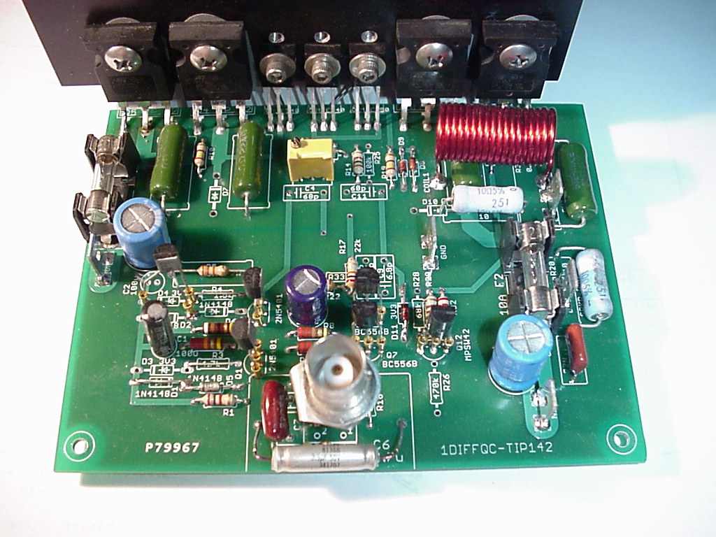

Build guide
C6,R20,R27,R30,R31,R33 are mounted on the bottom of the PCB.
R33 is a ground lift resistor that could be around 7.5 Ohms, I would first use 0 ohms and if hum was encountered would then go fancy with the ground lift.
Heres you could do it.
1. Test all your components for defects including PCB
2. Stuff PCB starting with small components working your way to large components i.e. output transistors
3. Examine assembled unit for any solder issues or bent pins shorting others
4. Attach assembled unit to PCB isolating the transistors from heat sink.(Test this)
5. Ensure bias trim pot is set for maximum resistance
6. Attach bulbs on positive and negative rails
7. Do a jig then power up, if bulbs light up, wash rinse repeat, you may have done this in poor light
8. If all goes well, set bias, attach scopes and torture amplifier, if it holds up
9. Plug in your speakers (some use speaker protection)
10. Plug in the "I like to move it move from Madagascar" CD (I now have a newer song to be revealed later)
11. MOVE IT !!!!!!!!!!
12. WE LIKE TO............

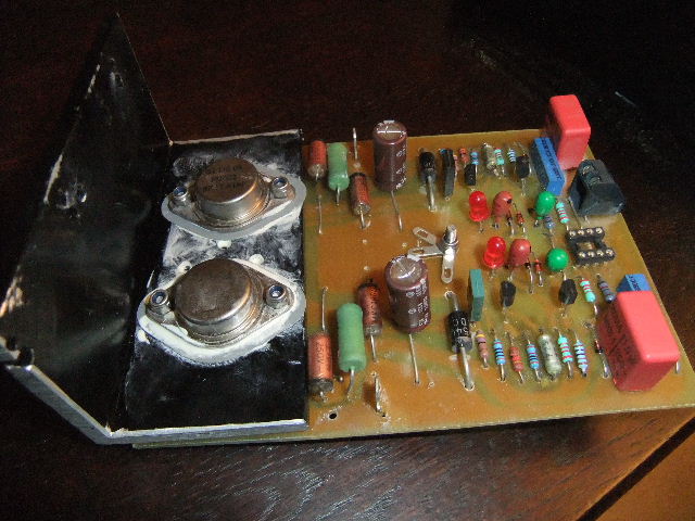

Why not put the right valu for the bias into your guide list (pkt. 8)??
I have almost finished my 1DFFQC. I set the bias on one channel from very simpel power 2x35 v DC yesterday. No serious listenings, only from a crappy loadspeaker from the garbish. Had to put a 510 ohm resistor to R 14. I did it from the component side(lazyness) and not the soldering side. With 1 Kohm I did not get the bias as low as 21 mV.

Somethings happened to the pictures
Eivind Stillingen

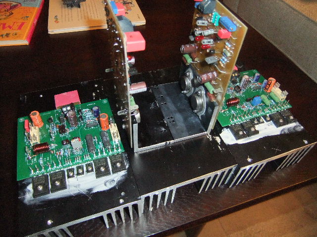

Well Harrison......I'm impressed :)
I finally had time to complete the boards today, have mocked up the parts on a peice of board and ran it on my system for a few hours tonight! wow the bass is powerful, and clean!
1DIFFQC pictures by Dagwood72 - Photobucket
Very nice. :cheers: . Thanks for making a difference, by taking a risk and joining us. Thanks for making your mark in improving the state of the art. Do keep us up to date. Nice tubes you got there ;) . We wanna hear more :)
Hello Everybody,, A quick update 1-on the first channel that I builded I used TIP142 transistors I enjoyed the sound very much my supply was at 37-+ volts. Then I try Changing my outputs and I used another suppy 45-+ The outputs are now MJH6284
Now this amp has come alive The bass takes you to the center of the earth and the highs put you on cloud 9. You,ll end up listening to your whole collection of music again.

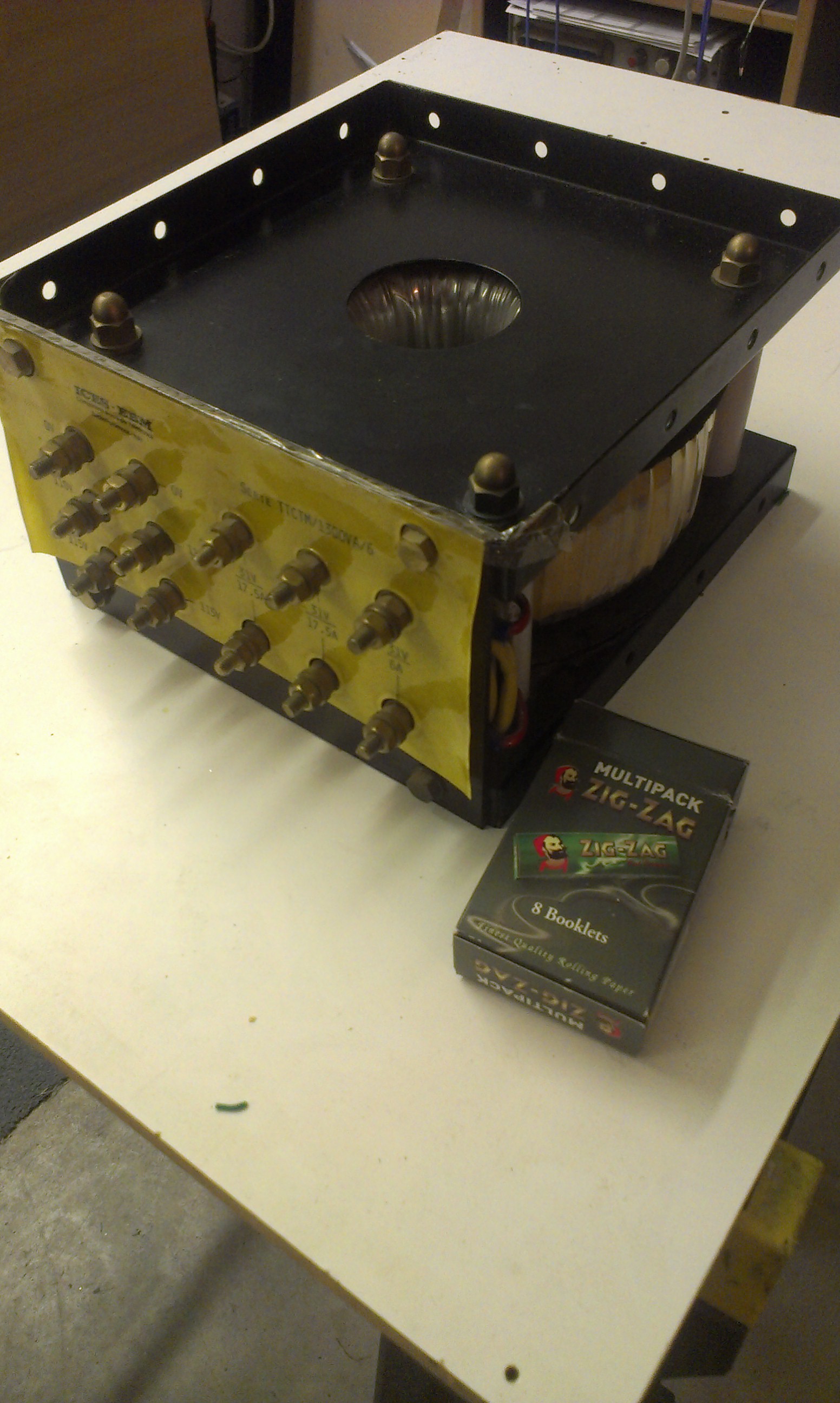

My transformer has arrived from Trade Me ( NZ E-bay ), it's a bit bigger than I thought it would be:eek:
1300Va
Output 1, 31volts @ 17.5 A
Output 2, 31volts @ 17.5 A
Output 3, 31volts @ 6 A
13.8 Kg's
No loss of power here :D....but will need a soft start for this puppy!

What is the no load input VA? Maybe 500 VA or more.
