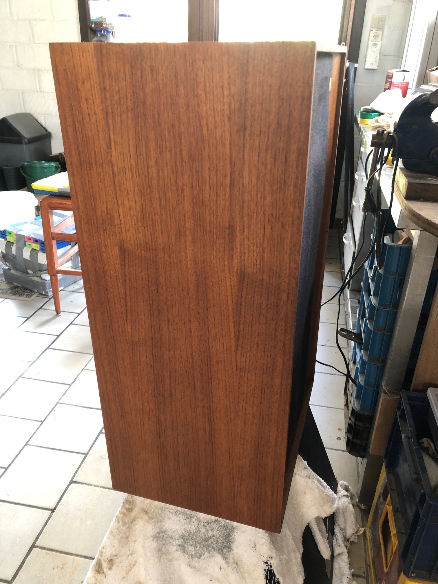

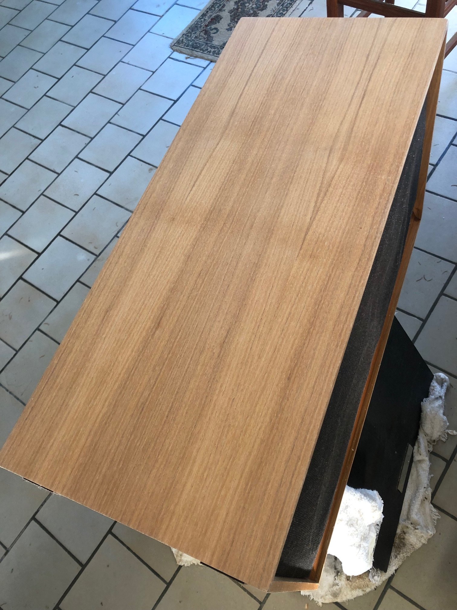

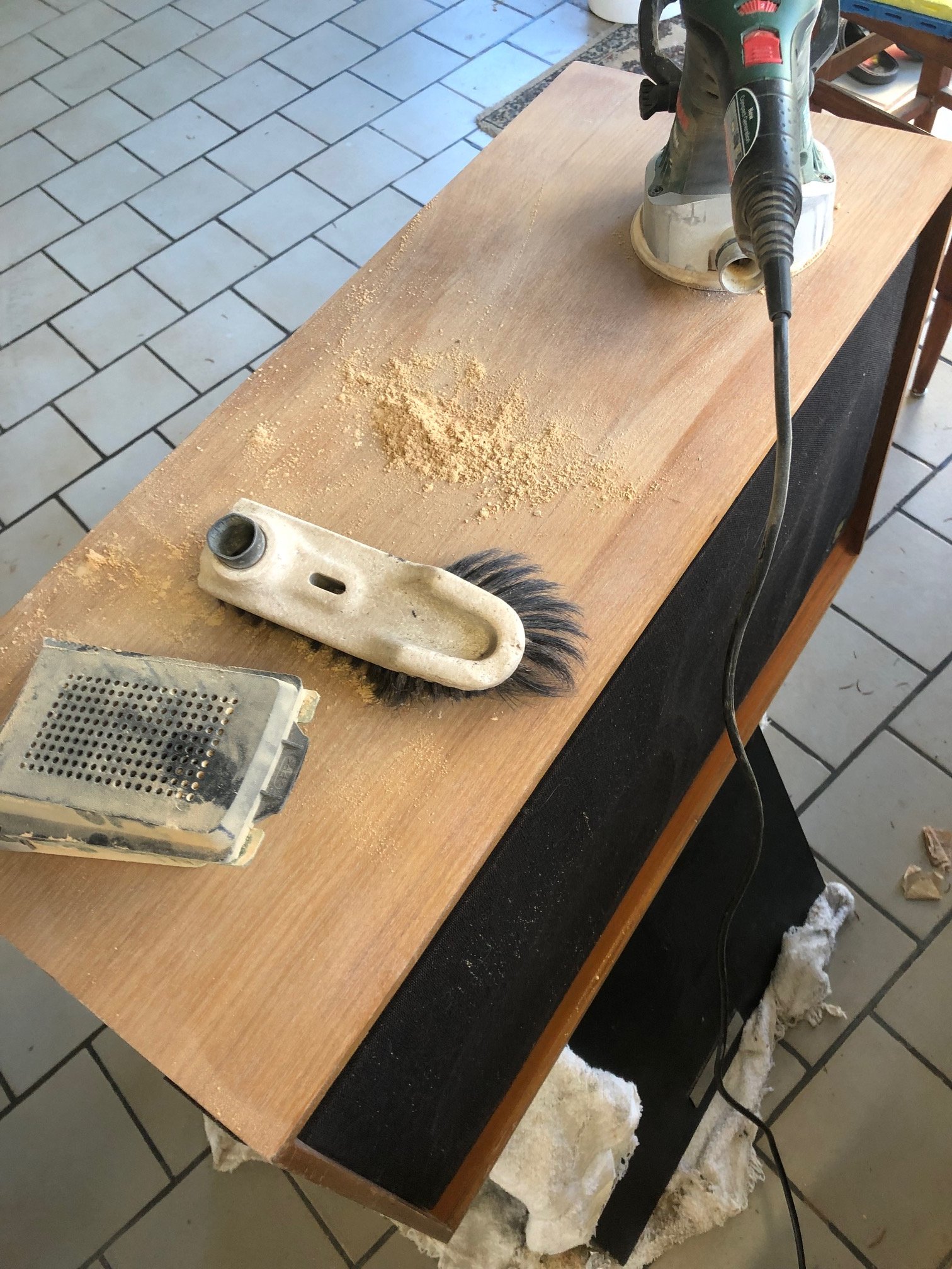

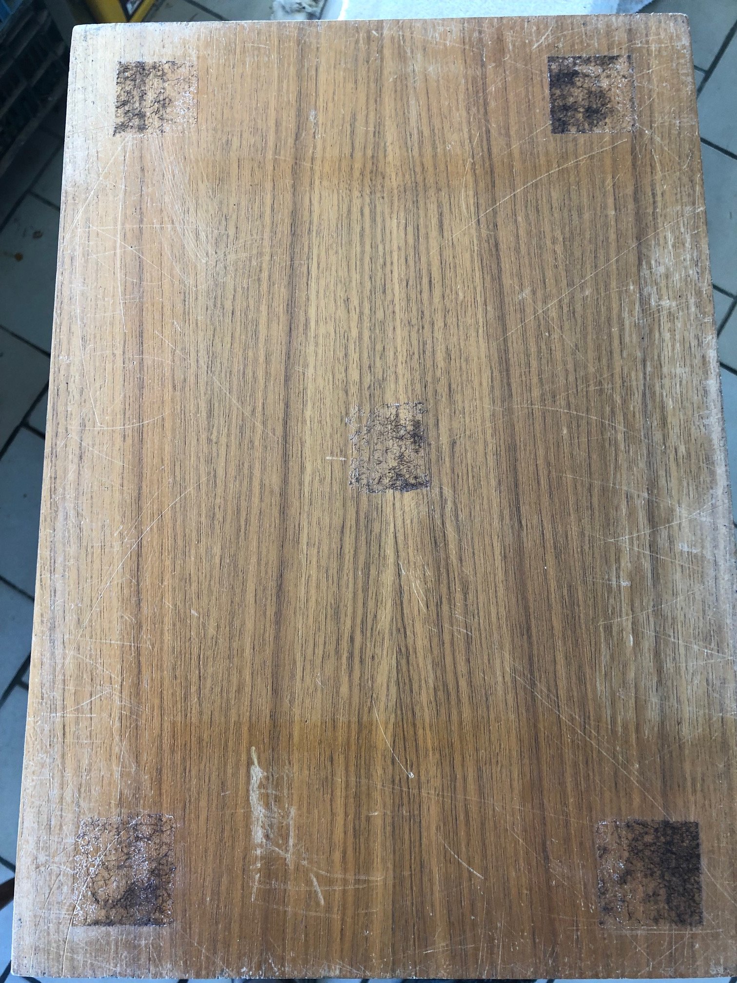

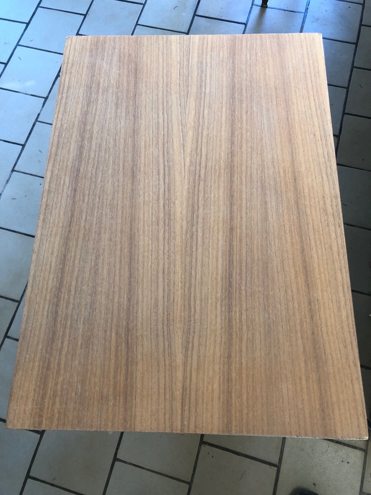

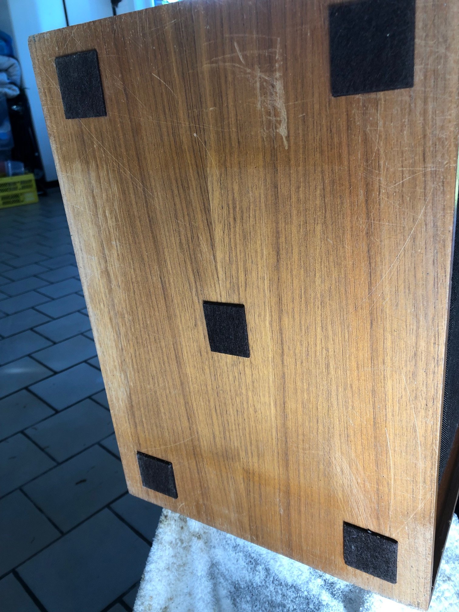

I am currently working on a 'repaint job' of the Concerto's, but afterwards I will do some further research myself.
(swap both speakers , to see if the error is not coming from the amplifier, or turn the B139 by 180 degrees, or install a 'new' B139).

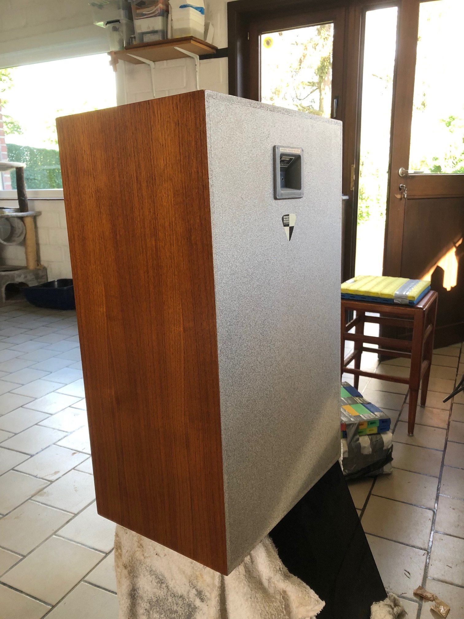

But that's for later. First clean-up of the cabinets. One is already done (see pictures)

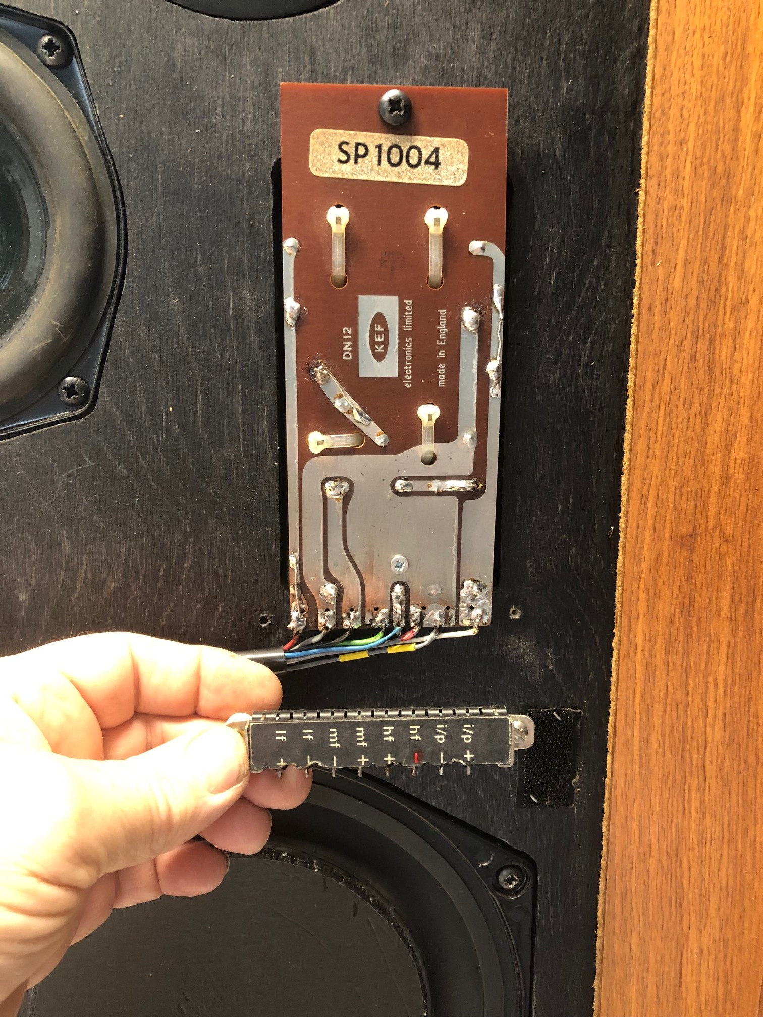

I am still looking for the Phoenix PCB terminal block - PTS 1,5/8-7,5-H - 1703091 (https://www.mouser.be/ProductDetail/Phoenix-Contact/1703091/?qs=YjJcVSlHJPXSs4ICjVsssQ==) or 1988163.
But I think the 1988163 gives a better contact :
https://www.mouser.be/ProductDetail/Phoenix-Contact/1988163?qs=gjk32EaArKI3WGAgzgNDtQ==
In the meantime I soldered the wires directly from the PCB to ensure a good connection.
