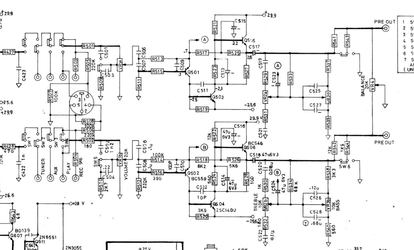

I have 2 NAD 3020s and a 3120 here, all with a feint 100 Hz hum on the right channel. The 3020's restored and the 3120 untouched but in truly excellent original condition. Not even a ‘welcome hum’. I don’t have a scope right now so I’ve been using what methods I can.You're right, there are too many variations in the story of this faint right channel hum to be consistent and credible evidence of a fault in the amplifiers. I think you should plan your test methodology better and use that oscilloscope correctly so that others can follow what you may report here. A typical 20-50 MHz bench oscilloscope should be be able to outperform your hearing through speakers many times over, though you'll need something like at least 10W, 4-10 Ohm resistors as dummy loads, for serious testing. The resistors could well become very hot even with only a few watts output but amplifiers driving nothing don't make for realistic test results so you need something in a linear resistance form that can shed the heat there. You can buy high power, metalclad resistors cheaply but they also require heatsinks - the expensive part.

I think the points you have made are clear enough but there are at least 2 problems getting to your goal, as explained. First, you need to define this barely noticeable hum by magnitude and waveform appearance. Then check this against the amplifier specifications and see if there really is a problem or you've just been been expecting too much from these pretty basic NAD products? If you can hear hum, you definitely will be able to see it on a decent 'scope and be able to estimate the magnitude.
Personally, I think the hum appearing only in the right channel of all 3 amps is against the odds unless they all have a common design or component flaw which is only in the one and same channel of each. I suggest it shows the signs of a hum problem in a common input source to all 3 amps instead. Apparently, that's not the case but have you actually tried swapping the links (use short RCA leads if you have nothing else suitable) from pre to power output stages to narrow down the location?
Then if you can't shift the problem from one channel to the other by any other means, the problem must therefore be in the same channel output power amplifier section of every amp. That should lead to focusing on reasons why just one power amp. should be noisier than the other.
