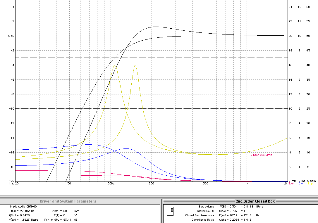

Now that the CHN-40 are spare I thought of using them in a 2 way, using them for high frequency duty. This is new to me as I have never made a crossover, please correct me if wrong but the CHN-40 would need to be in its own sealed part of the box. What size woofer would be a good match, low bass is not a problem, sealed box for both okay.
How would I size the volume for the CHN-40 and the woofer to work out the crossover. Sorry for so many questions, big leaning curve compared to single drive unit box and very easy to get wrong.

For such a small driver it goes quite low. One could just use the sealed butterworth (5 litres) and bring sub(s) up to it with a complentary 2nd order woofer XO.
Increasing the slope of the HP would require some active intervention, a passive will be problematic due to the resonace peak.
Or one could move the XO as high as you’d like (given a woofer that reaches high enuff to meet the midTweeter)

Hmm, with a ~ 4 cm VC dia. = 34400/pi/4 = ~2737 Hz and 42.19 Hz Fs, then theoretical first XO polar matching point = ~ (42.19*2737)^0.5 = 340 Hz and we ideally want it rolled off at least to -24 dB/slope order, so 4 octaves away = (340*2^4) = 5440 Hz 1st order, (340*2^2) = 1360 Hz 2nd order, (340*2^2.828) = 2414 Hz 3rd order, (340*2^1) = 680 Hz 4th order
So whether 300-340 Hz, good to go with all except the ideal 1st order 🙁
