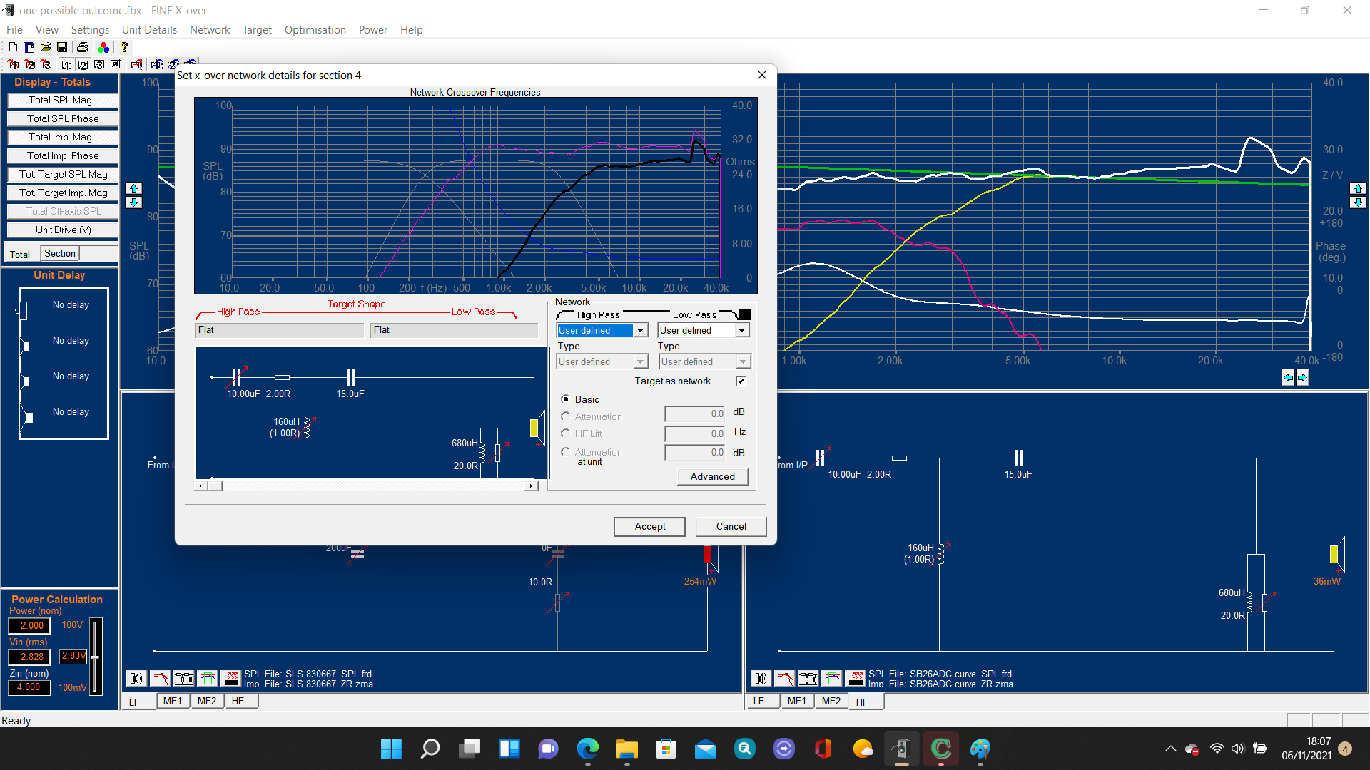

I can't tell what the final cross-over is for these drivers, any one know?

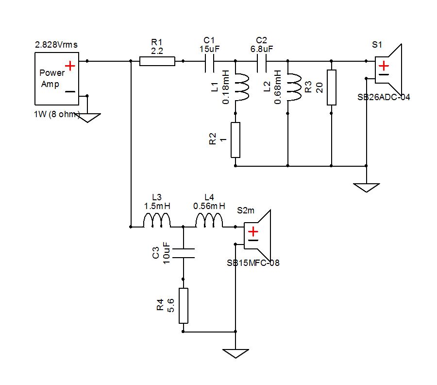

AFAIK the project evolved into this speaker:
Non Commercial 2 Way Standmount Speaker Project

Blatent error there, surely? Tweeter capacitors in the wrong order. A Child of Ten can see that.

Capacitors could be the wrong way round, i agree as typically that's how it works out with tweeter Xovers.
Who knows , it could be a subtlety with this design. Ideally it would be nice to see graphs and a phase switch to see null.
Maybe Dissi knows if it is a simple error or not ?
I followed the link and have seen the graphs now.
The capacitors may be fitted that way in an attempt to knock the 2K bump down a bit more.

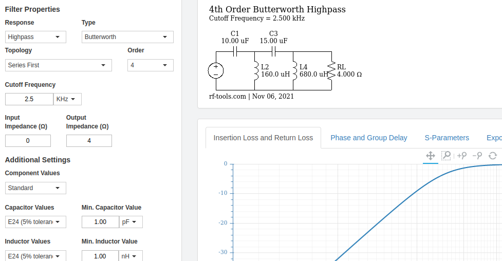

Reverse order of capacitors isn't necessarily an error, even Zaph did that in his ZRT design. As you say it's a mean to prevent a huge impedance peak below the crossover frequency. But one has to be very careful, since the impedance quickly goes too low without a significant series resistor. 🙂
I did try it in a sim and it makes it worse at the 2K point.
System7 has spotted the obvious mistake, swap the cap positions in the given circuit.
TBH, I would trust my good friend Dissi far more than speaker genius Mr.Zaph or speaker genius Mr. Troels Gravesen.
My speaker design is based in unforgiving Mathematics rather than Audio Voo-Doo and Snake Oil. I say this with Irony. 🙂
RF Tools | LC Filter Design Tool
I rest my case.
I rest my case.

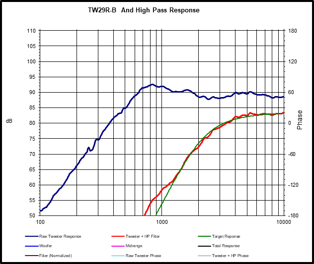

It doesn't look too bad to me. I happened to have some measurements of the sister 26CAC tweeter (basically identical) taken for a commercial project a year ago. It was a compact MTM, but baffle width isn't far off (6mm difference), so notwithstanding some changes in diffraction & loading mostly in the 1KHz - 2KHz region, it should be vaguely near.
Blue = raw on-baffle. Red with the above 4th order electrical high pass, level padding & damping resistor. Green indicates a nominal 4th order Bessel slope, 83.5dB, 2.25KHz nominal, which it's tracking in this instance quite well. Impedance isn't as well-damped at Fs as I'd prefer. Electrical transfer function looks reasonable also. Case rests, as they say, since this is based on hard data, notwithstanding some modest variation.

I also opened up my logbook. On the two occasions I have used the SB acoustics tweeter it has always been smaller value first, but the logbook shows they got to being equal a few times as iterations were tried, and on one occasion larger first was tried.
Basically they are all variations, and even if a design uses textbook LR, Bessel, Butterworth, Chebyshev, M derived whatever, i can guarantee that once i we start tuning or playing with a design the original alignment to a textbook filter goes.
Your filter designer is nice, I like it.
It works with fixed impedance, which we are not typically dealing with here on the majority of occasions, which you fully understand.
I imagine you have old textbooks with graphs and tables of how to work filter for 600 ohm or 50 ohm applications. 🙂

That's interesting -first time I've seen a screenshot from Fine X-over. The PCD7 sim I posted above was using the measured driver impedance, same as yours; the image Steve added looks to be a pure electrical filter assuming a fixed load, but no doubt he'll confirm.
Either way, agreed: there doesn't look to be anything wrong with the electrical topology of the linked high-pass as far as I can make out.
I should add, lest anyone notices: the acoustic transfer function graph I posted above has 'T29R' as a header, but the FR and impedance data used is from the 26CAC, as stated. I'd had PCD7 open for a different project this afternoon & forgot to change the tweeter title. Sorry for any confusion.

Does this x-over work roughly the same with SB26STAC-C000-4 tweeter?
Seems to be the same tweeter, but with a fabric dome.
Sort of. So is the original tweeter referenced on this thread actually. The SB26STC-04 is an OEM fabric dome & basically the same as the 26STAC. With the filter under discussion ( https://www.diyaudio.com/forums/mul...2-standmount-speaker-project.html#post5826477 ) it works in a similar way, with roughly 4th order Bessel acoustic slope at roughly 2.25KHz. SPL is about 2.5dB - 3dB higher so would require some adjustment to the level padding. The values could stand a tweak too as the responses aren't precisely the same, but they're in the ballpark. You'd probably lose the R2 shunt, drop L2 a little & increase the value of R1 to trim output level as desired. That's looking at it purely independently, & based on a very quick & dirty sim though, so in practice you'd likely need to make further adjustments to get the system response & phasing where you want it based on the on-baffle measurements.
