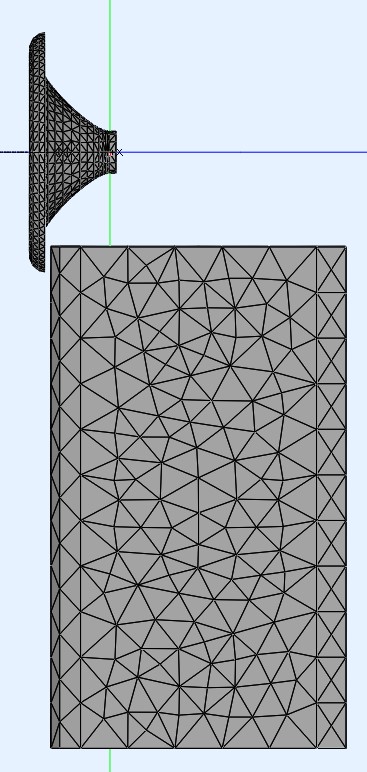

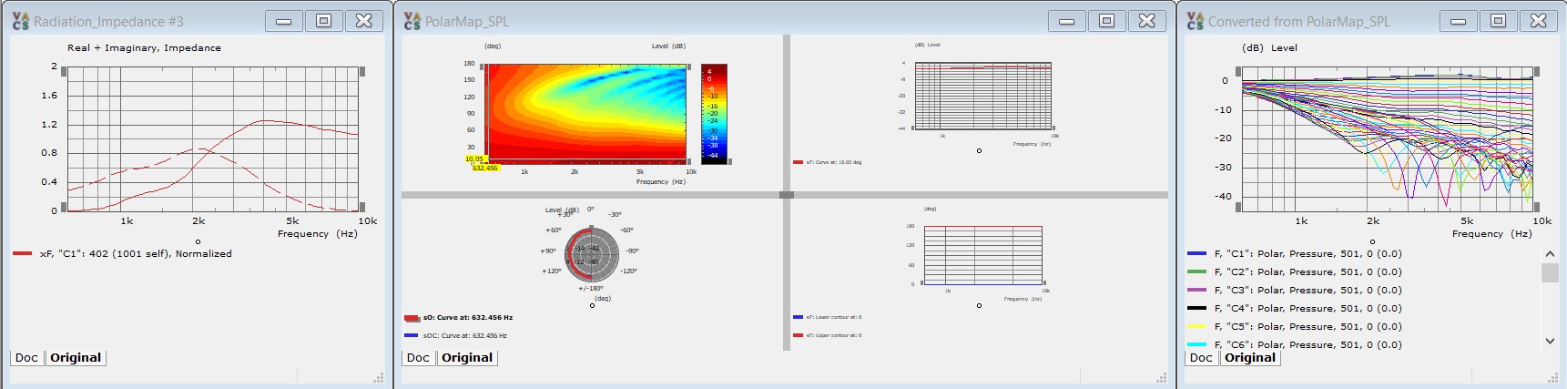

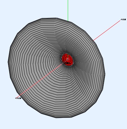

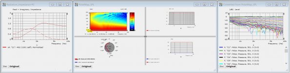

To simulate the effect of a woofer cabinet below a freestanding horn I need to mesh the horn in 3D rather than using circsym. I've hit a bit of a snag as the rollback horns are not simulating exactly the same as in circysm and the effect of the interface seems to be more significant than before. Simulating the whole thing as an exterior works with circsym but produces garbage results with a mesh. The subdomain modelling is supposed to give the same result as a single domain. It looks like a mouth reflection would in the radiation impedance and there is a ripple in the polar. Sometimes I can clean up the Radiation impedance but the polar ripple always remains even if it is suppressed.
The is the circysm result which is clean is attached below.
Using the interfaces from Ath selecting the last slice and offsetting the interface to clear the front gave the best results with the least ripple.
This is a high density 5mm mesh and interface, the extra density made very little difference to the result. This was on a full size guide the previous was a scaled down version for testing.

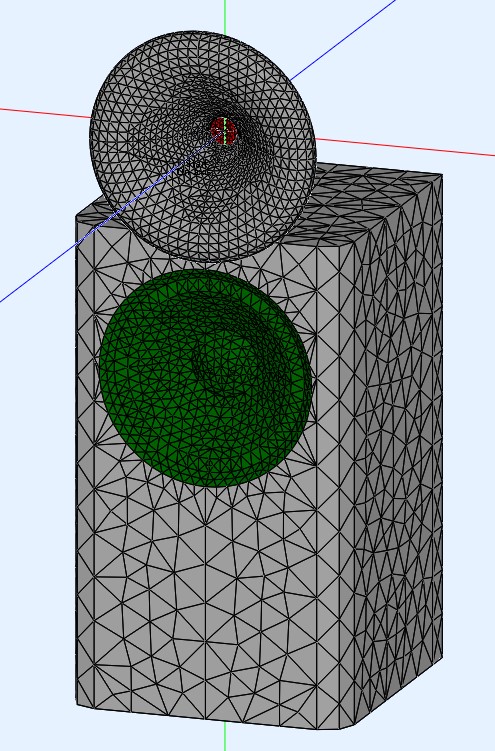

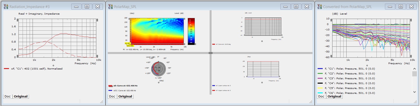

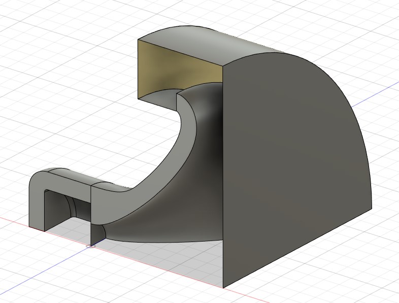

Yesterday I thought I would start playing with Akabak, the videos I posted links to before gave me confidence that I could click my way through it all given that I know what I want to do.
It was easy enough and I soon had something ready to go. I wanted to try and use Fusion to generate the profile and interface so that I could use a different junction and enclose more of the air around the rollback in the interior domain.

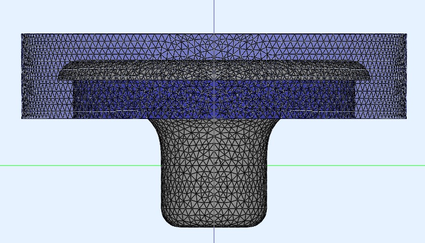

I tried Gmsh 4.7.1 which has the curvature options mentioned in one of the videos. It didn't make much difference on an Ath guide. It still used too few triangles at the throat. I resorted to brute force and ran the whole thing at 5mm resolution. That came out to 6500 elements and took 10 hours to solve
In hindsight that was not the first sim that I should have run with Akabak but it did solve and produce good results so I got away with it
It did reduce the ripple a little more from the previous attempt but with way too much solve time for it to be useful. Results attached below Top line is ABEC with the Halo and bottom is Akabak with Fusion Interface.

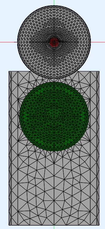

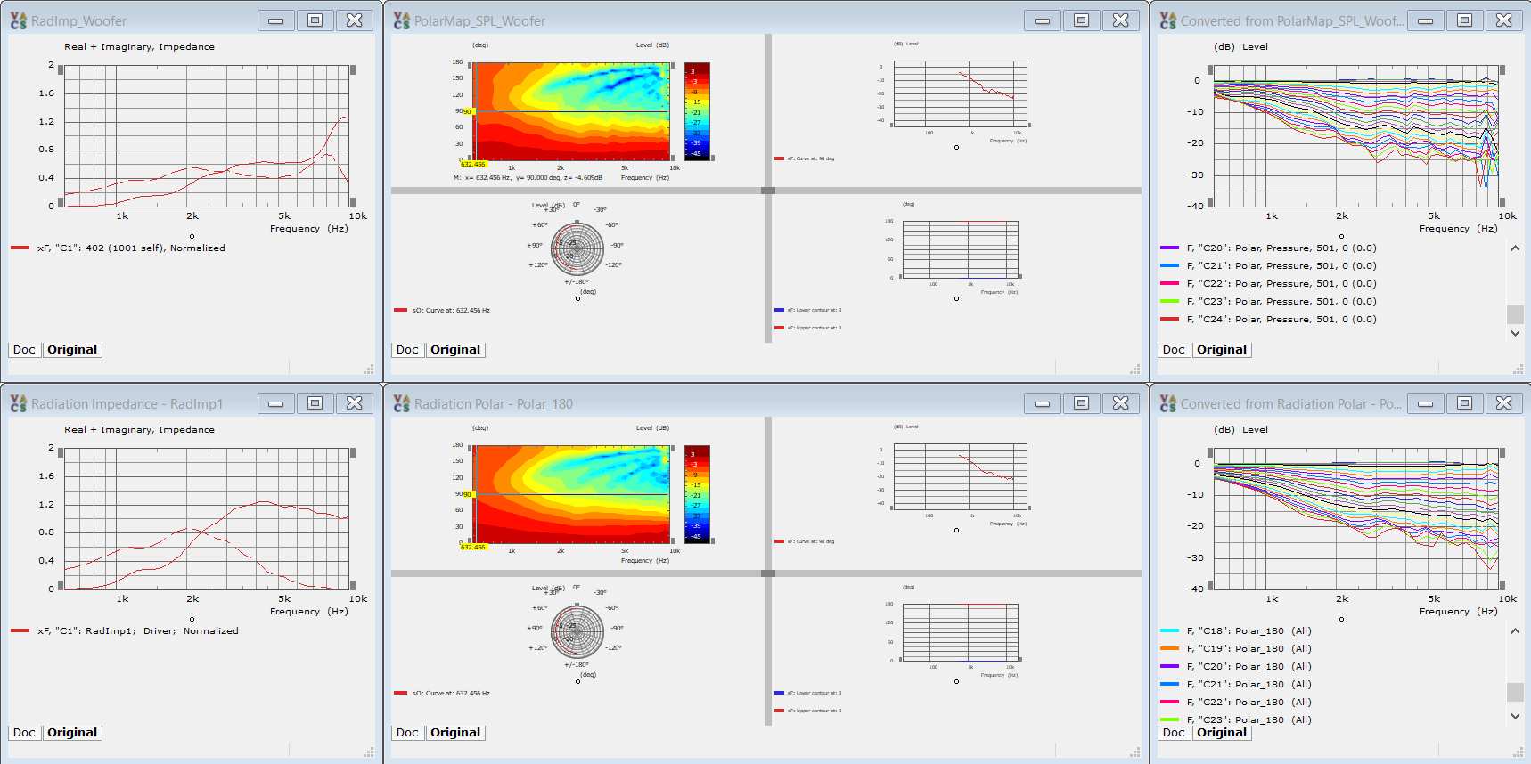

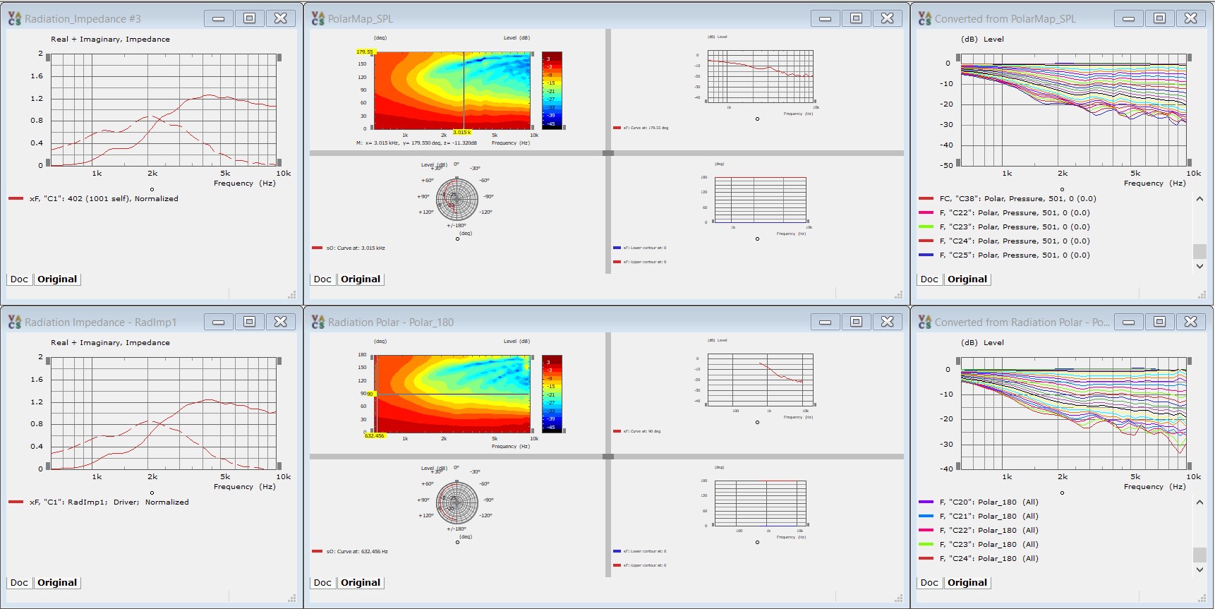

Now for a result that I find quite exciting. What happens to a freestanding guide when you put a woofer box underneath it. The good news is not much
No real effort was made to make the box super low diffraction. This is the same size woofer and waveguide as in the previous cabinet simulations. It seems you can put the guide in front of the box very close to the woofer and have a good result. This to me seems like a good option. I can also see some aesthetic design options here too.
Comparison results attached below, top line is with woofer cabinet, bottom is without. Something weird happens to the radiation impedance high up but otherwise seems normal.
