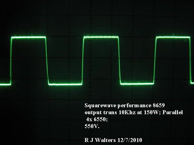

Alot of you will be hard pushed to get this result form other sim parallel p-p o/p transformers; in pic. performance of the Sowter 8659 2.2KA-A ;150W lump ,20Hz-75Khz f3dB: custom speck'd. The Zobel in my case arrives mathematically at 2n2 1K5 for each half and the result is shown in pic. It isn't that critical. The important data is knowing the self resonance freq and this can be empirically found..
Hint; one can crib the same Zobel analysis for switchmode BEFORE 1st stage phase compensation and global nfb step cap are fitted. One does one before the other and one is lost.
The same waveform is obtained throughout the KT90-KT88-6550 group. THD dependant on circuit but I get around 0.1% at 150W 1Khz using the Williamson slam diff driver technique.
