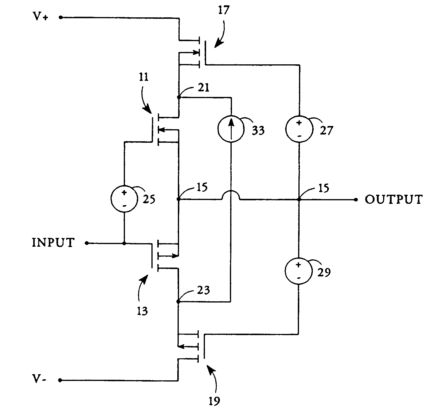

No, no, read the patent from Nelson Pass link in post #65.
It is not low power but low voltage Class A.
I read the patent #65 but I'm lost when i comes to calculate the total efficiency.
To me it is still very much a question of how much current You want to pass through the output stage when idling.
To keep the efficiency up and the heat generated down the amplifier in the patent uses six power supplies, two of them floating and a secondary power-amplifier to drive the mid-point of the floating power supplies.
To me two Class-D amplifiers driving Vcc+ and Vcc- respectively looks like a more attractive option. I guess You would need two additional power supplies for the input stage and VAS of the Class-A amplifier.
High power Class-D stereo amplifiers are not that expensive off the shelf so the thing could be built without going bankrupt in the process.

Thank you to point this patent, I did not know about it, but I knew I am not doing anything new here. Just a hobby.
Do you know any built amplifier of that kind?
Technics produced an amplifier which used it. I always thought the design
very clever, and years later patented a circuit which did a similar thing but
in a different way, thus the citation.
That was patent #5343166, and Pass Labs did not build it as a product.
The diagram on the first page:
Thank you Nelson, you are very kind.
I will try to make working prototype, I modified Class D amp(bought on ebay) moving FB after output inductor, and for Class A I will use my CFA amp.
Damir
Damir
Why do You want to move the FB pick-up point? You don't need very low distortion in this context. Stability is as important as ever and moving the FB to after the inductor might jeopardize stability.
Will You use an additional floating power supply for the CFA driven by the Class-D amplifier?
You need the linear and switching amplifiers to have matched gain magnitude and phase for all frequencies and load conditions. Class-D with pre-filter feedback has a load-dependent frequency response and it seems sensible to achieve the matching between the linear and switching amplifiers by making the class-D response better rather than the linear part worse.
I find the approach risky. I would not assume that a commercial class-D amplifier responds nicely to mowing the feedback pick-up point.
To low pass filter the input to the CFA so that it matches the high frequency response of the class-D amplifier would not change to stability of either amplifier. You must of course make sure that the gain of the two amplifiers matches.
Another work around, assuming this is for audio use and not for delivering 20kHz at 200 Watts, would be to simply add some extra margin to Vcc+ and Vcc-. This would sacrifice some efficiency.
Which brings to mind another question. Isn't the low frequency response almost as important as the high? Does the Class-D amplifier be DC-coupled from input to output?
