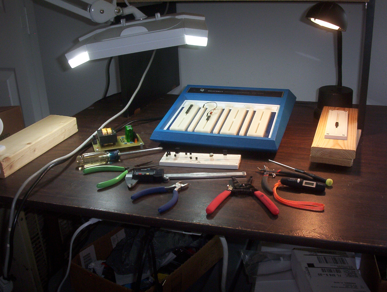

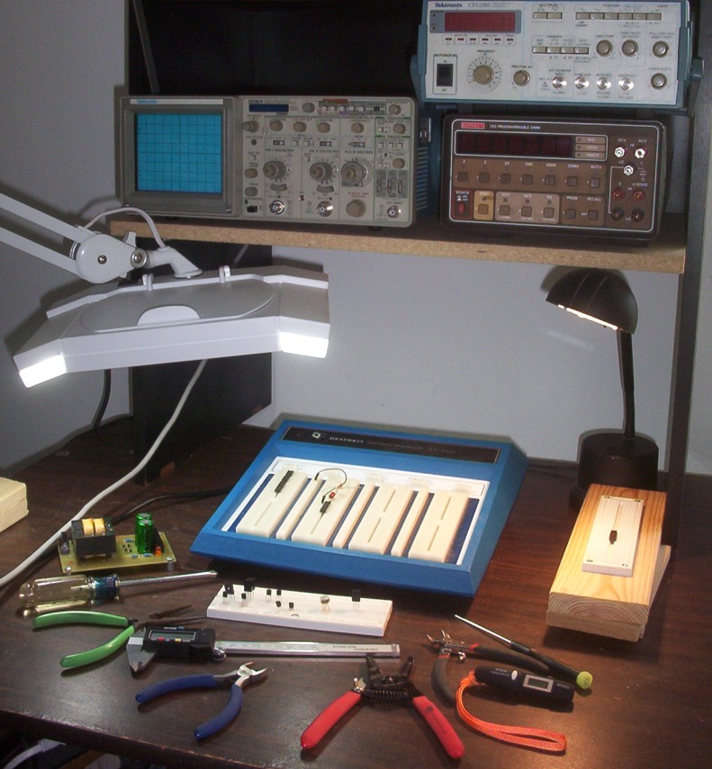

Because I can see and read the color codes on the resistors easier than I can see the resistor values on the SMT resistors.😀 Just wait till you get older...😉
Sounds like all you need is a big magnifying glass and some tweezers. In all seriousness though 0805 and larger resistors are IMHO just as easy to solder as through holes.
Can you send me some color coded ones or tell me where I can get them on Ebay.
I have a dental chair type magnifying glass with 2 lights and I prefer forceps to tweezers for my geezers shaky hanks.😱

Amazon.com - Ultra-Efficient 108 LED Magnifier Lamp - Large 7" x 6" Lens 5-Diopter
I had ordered the LED one but they shipped me one with florescent bulbs, it is okay, they refunded me a good amount to avoid shipping 3 times. I still use LED lamps in addition to the ones seen. The glass is not great but it works. Shop for it on ebay or amazon I only paid about 40 dollars, but it has been a while. Good luck with that.
I think that might be an answer for the resistors for me. Like I said I am going to use the digital display to verify the caps and axial lead resistors before I mount them on the boards. Makes life simpler. 😱 for my well used eyes. I still have 20 20 with corrective lens. Can drive at night without problems still. But one day...😉
