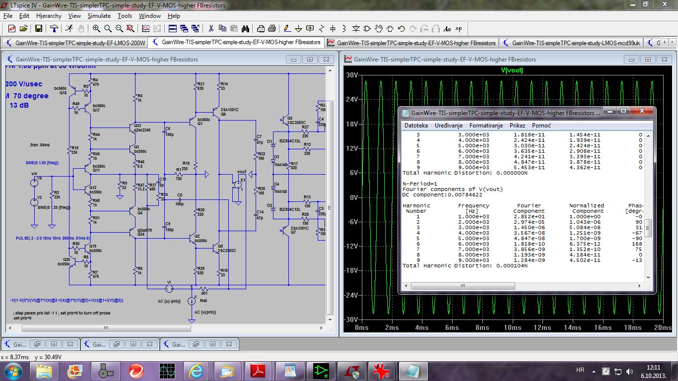

Out of curiosity i simulated this version front end....
Without the 220pf input capacitor the circuit burst in oscillations...
I realy don't know how you simulated that. Here is LTspice simulation front end only, no input cap.
The circuit post2.
Also , there s quite discretanpcies with 94db OLG ,
with 28dB CLG this allow theoricaly 66db distorsion
reduction once the loop is closed but with the claimed
ratios of sub ppm at 1KHz this would require a circuit
that is capable of 0.01% distorsion when open loop ,
quite unexpected and frankly not possible with a two
stages topology as this one , moreover with output levels
being on the 20-30V range and a mosfet output stage that
will inherently produce 0.2 to 0.5% THD with only said 66dB
available loop gain to reduce by , well , 110dB..???😕
The circuit post2.
You can freely present here your better circuit, it's open thread for everyone.
I am CFA beginner.
I am CFA beginner.
I m afraid you missed the point , wich is not to present
a "better circuit" but to highlight what seems to me as
quite paradoxal.
There s no substancial modifications compared to Manso s
original schematic set apart a lateral mosfet output stage that
is not more linear than his triple EF , yet , distorsion is significantly
lower despite similar loop gain and a worse OS linearity wise ,
hence the OLG linearity requirements are thoses of a closed loop
amplifier if such THD ratios are to be reached when loop is closed ,
wich lead me to question the methodology since no one will negate
that such ratios cant be extracted from a two stages design unless
thoses two stages produces 0.01% THD when open loop and this cant
be the case with two basic serialized common emitters amplifiers ,
be it CFA or whatever other acronym.

You are forgetting TPOIC used here(or what acronim to give for including OPS in the TPC).
With shunt or Miller + shunt compensation distortion is much higher. With triple BJT OPS I hav't got stable this TPOIC compensation.

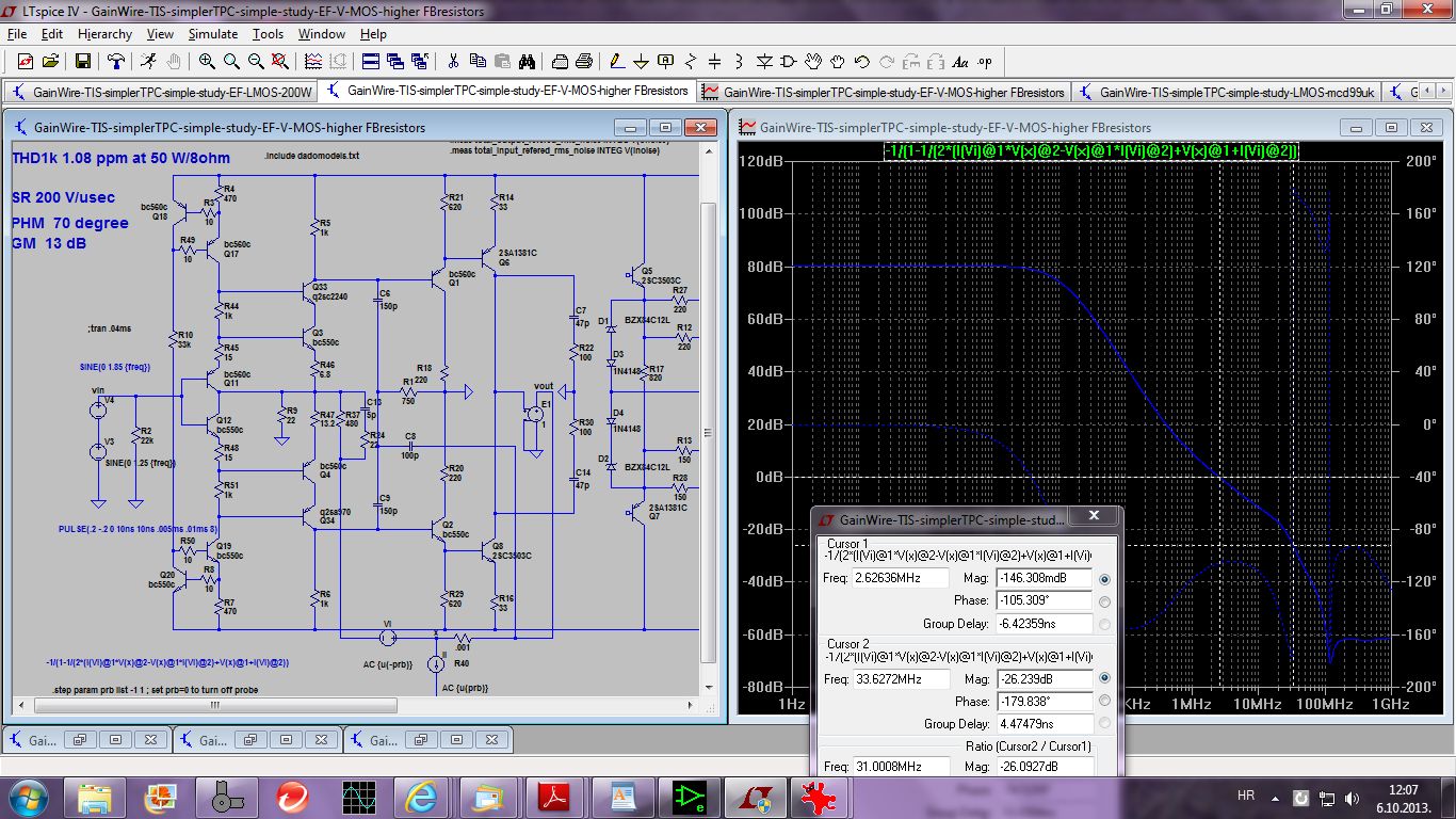

Amplifier gain
Dear Damir,
congratulation to your current CFA design. 🙂
Would it be possible for you to add some simulations with a little bit more practical gain for a 200W@8R amplifier? E.g.: Gain 30 ~ 680R/22R
Or alternatively: please add your current asc file(s).
Thx, Toni
Dear Damir,
Thx, Toni
Here are two versions, 220/10 ohm and 470/22 ohm feedback.
Tell me why 30 is more practical gain?
BR Damir

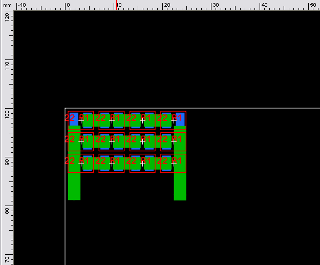

Dave, 22 pieces of 1w metal film is a huge lump of resistors. How could that contribute to the (in)stability margins I don't know. The only experience I have with CFAs is the CFA op-amps for video use at my work years ago. Those were SO-8 SMD devices. In the layouts, we had to cut out the GND plane underneath the inverted input node and all that of its potential, also cutout the plane underneath the output node, and keep all nodes at a minimum possible physical size, in order to avoid peaking and maintain good stability.
MagixBox's idea of a separate riser PCB may work better in terms of physical size. 23 or 24 pieces of 2512 SMD resistors can be populated on both sides of a PCB in a 16x24 mm^2 area, but 14W total dissipation out of that small area is perhaps too much?
Dave, 22 pieces of 1w metal film is a ...lump...
Need a bit of a lump to dissipate 14W, whatever way.
MagixBox's idea of a separate riser PCB may work better in terms of physical size. 23 or 24 pieces of 2512 SMD resistors can be populated on both sides of a PCB in a 16x24 mm^2 area...
The earlier thread discussed a sub-board and addressed your stability concerns with a variety of proposed shields, planes, cut-outs in planes etc.
Interested to read your practical experience after the hypothetical proposals.
Probably no sub-board for me.
I haven't decided yet but it does seem like SMT resistors would fit more neatly.
Best wishes
David
This wont change the fact that there will be at most 66dB loop gain
around the output stage.
That you end with 40db global NFB and 26db local
NFB around the VAS/OS will still be 66dB , unless
you re counting thoses 26dB two fold , for the local
loop and another time for the global loop......
