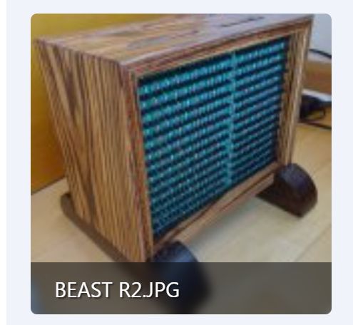

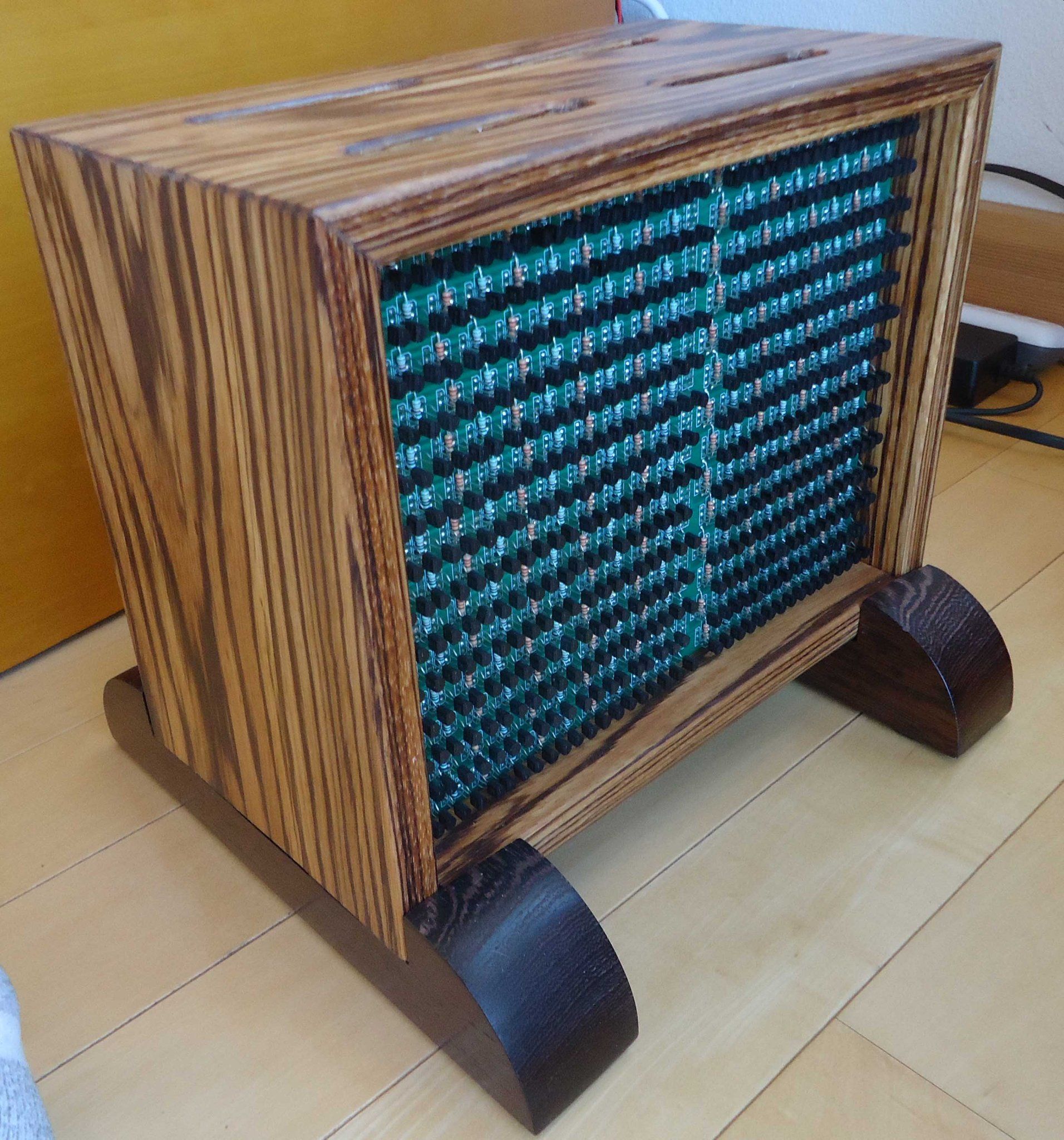

Speculations about Pass JFET Beast R2 disclosed in another thread.
It looks like only 1 resistor per JFET cell. That causes me to think that one JFET is the current source and the other JFET is the buffer. It is a single-ended buffer.
My guess is that all JFETs are J113.
Wild guess is 7mA idle current per buffer cell.
If I counted correctly, there are 560 JFETs on each PCB.
My guess is around 22 watts per channel just before clipping of the current source.

After re-visiting the photo, it looks like 448 JFETs / PCB.
Revised watts/channel estimate now 17.8 watts/channel assuming 7mA / JFET pair.

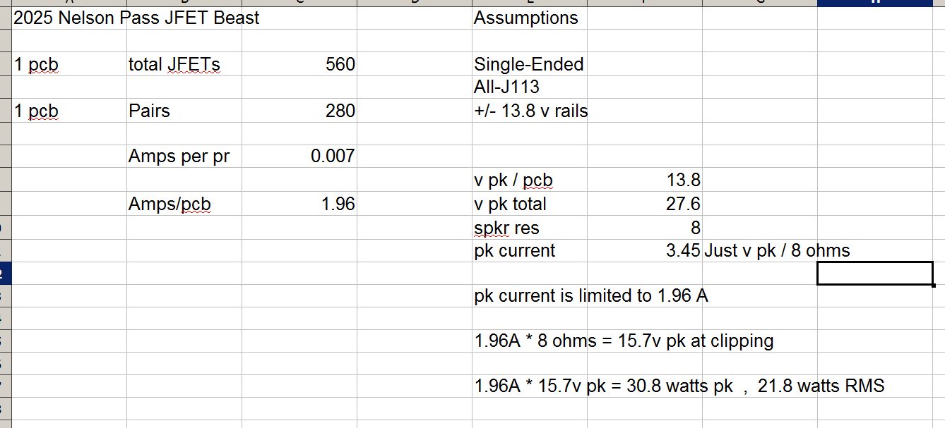

I get a different numerical result
- 560/2 = 280 cells
- Each cell is a source follower with a constant current source load
- 0.007 amperes DC per constant current source (assumed!)
- 1.96 amperes constant current for the array of 280 parallel cells
- If peak output current is 1.96 amps, sine wave RMS output current is at most (1.96 / sqrt(2)) = 1.386 amperes
- RMS power into 8 ohm load is (1.386 * 1.386 * 8) = 15.37 watts

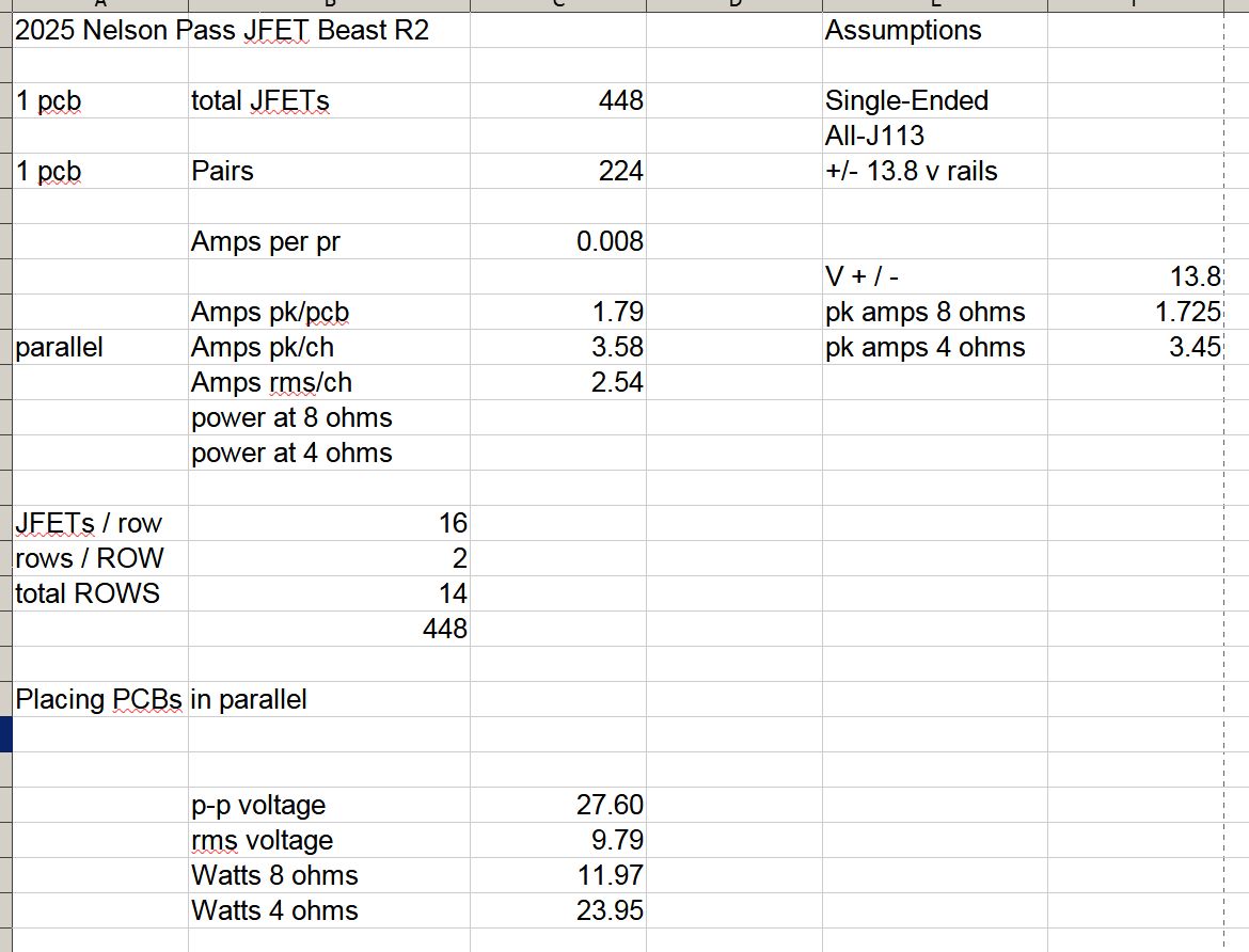

I recounted the votes. Its 448 JFETs per pcb. There are 2 PCBs per channel. Somebody double check my JFET count from the picture.
I also just found that I entered power formula incorrectly.
I revised my calculations.
Assuming + / - 13.8v rails
224 buffer cells per pcb
At 8 mA idle per buffer cell, total pcb idle current is 1.79 amps
2 pcbs in parallel yields 3.58 amps idle
13.8 v / 4 ohms yields 3.45 amps pk
A pair of these Beast R2 pcbs in parallel will just clip at 27.6v p-p which is 9.79 v rms.
9.79^2 / 4 ohms =~ 24 watts RMS per channel
12 watts RMS into 8 ohms
This assumes zero output impedance. Realistic wattage will be some lower.
Higher idle current will allow full voltage into lower than 4 ohms. If you raise the idle current high enough, you can operate the pcbs in balanced/bridged mode and drive 8 ohm loads. With enough idle current, in balanced/bridged mode, output power would be ~ 48 watts/ch

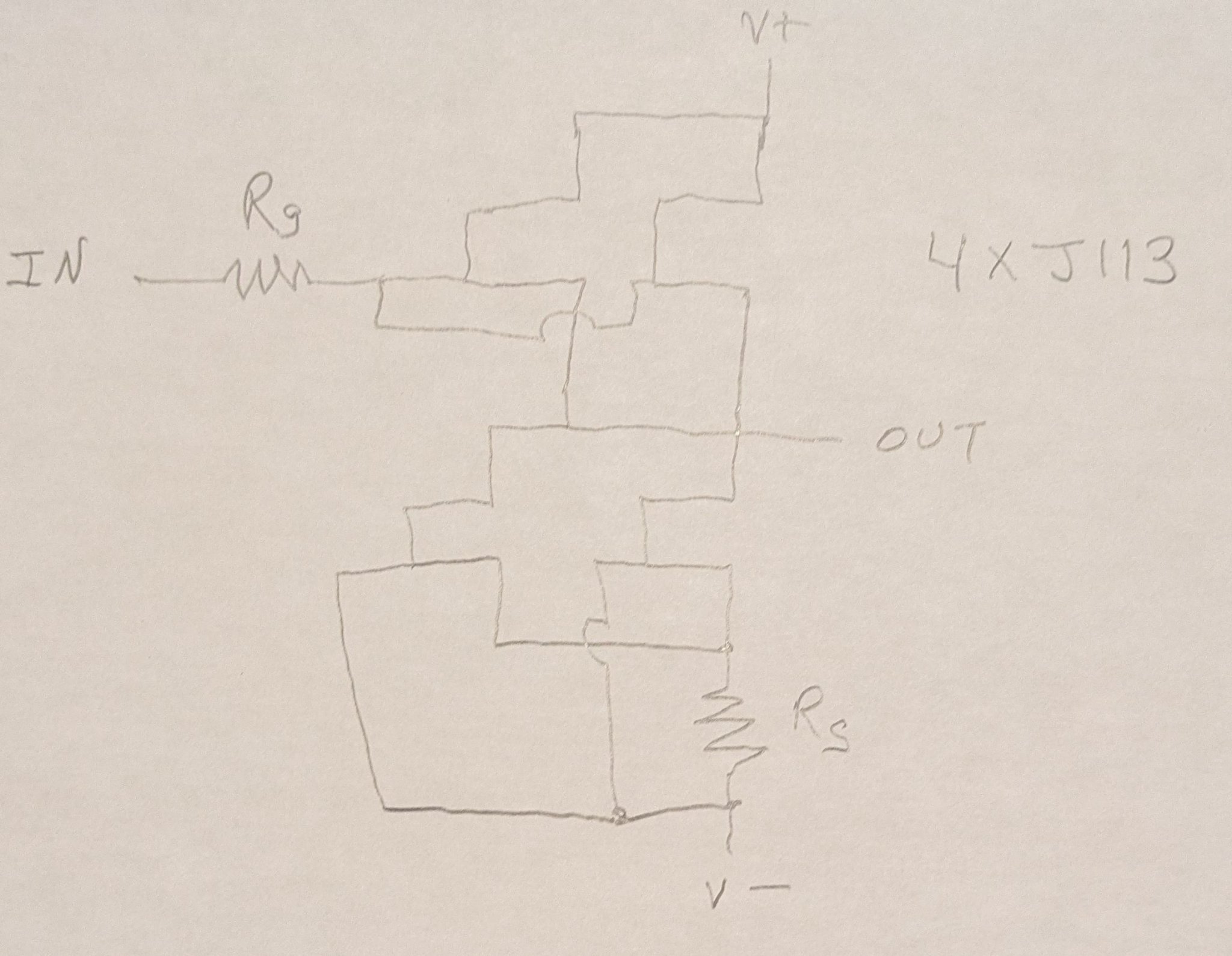

My guess is that this is the basic cell. It is a B1 where the JFETs are parallel doubled. There are 4 of these cells per row of 16 JFETs. 4 gate resistors per row of 16. 4 source resistors per row of 16.
It is a clever design to cut the number of resistors by 50%
I will give this a try with the J113 circlotron.
The value of the source resistor depends on how much Idle current is desired.
