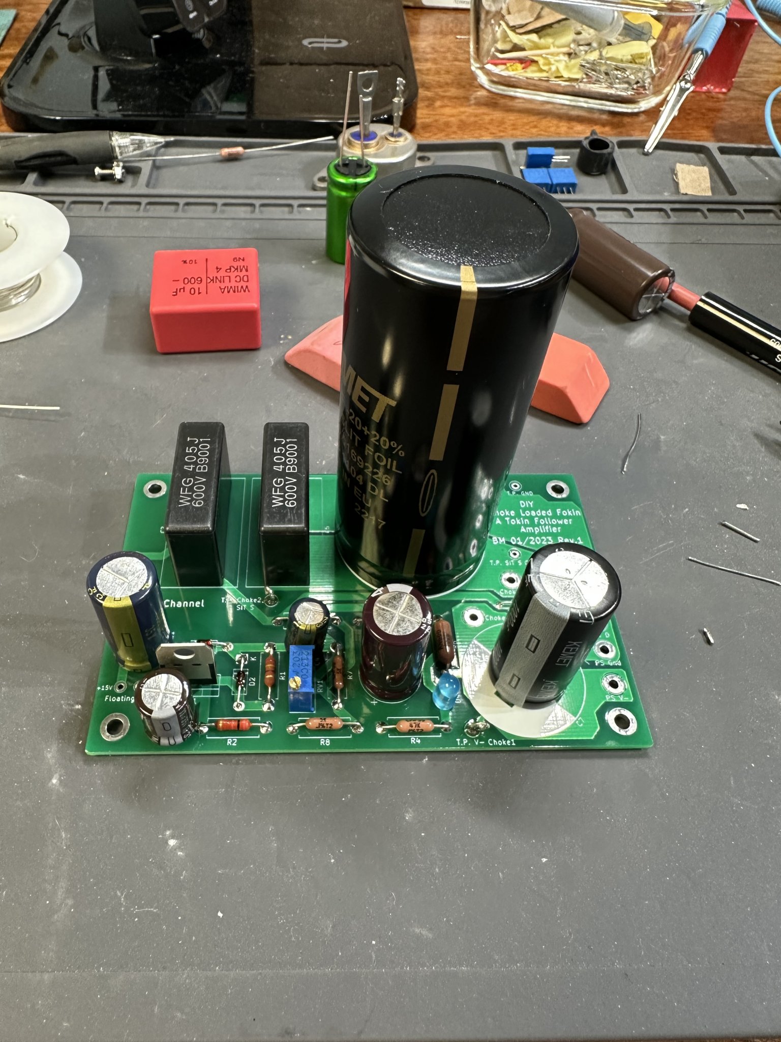

I have had a diyAudio member ask me about missing Gerber files for the left channel board. I am sure most of you know the answer but just to be sure, there is only one board and one Gerber file set for the amplifier board. The board is used for both channels. The "Right Channel" is on the front of the board. Flip the board over and the "Left Channel" is on the back of the board. Of course those are designations only and the boards may be used for whichever channel you choose. I have the "Left Channel" in my right channel monoblock and the "Right Channel" in my left channel monoblock.

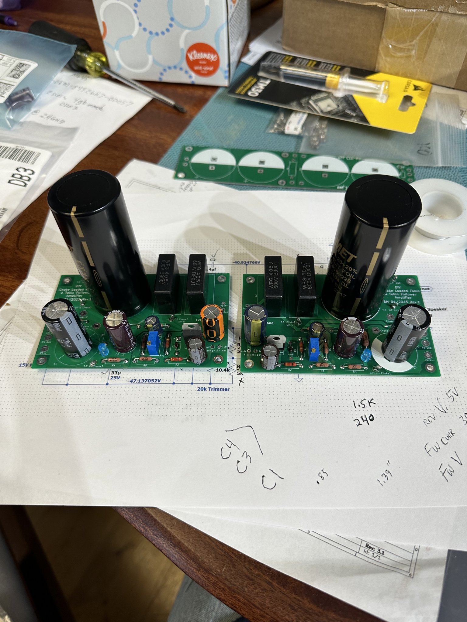

ResisterClone
Joined 2011
Gaining
Reactions: 1 user
Joined 2012
Looking good. I have to get off my butt and write up some building tips.
But meanwhile, I see that you have copied the orientation of the trimmer in the bias supply. I purposely installed it that way so that at full counterclockwise adjustment, the bias voltage is maximum for no current flow. Clockwise adjustment decreases the bias voltage and starts/increases the current flow.
