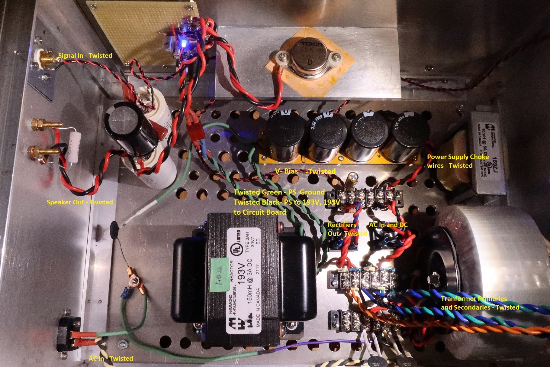

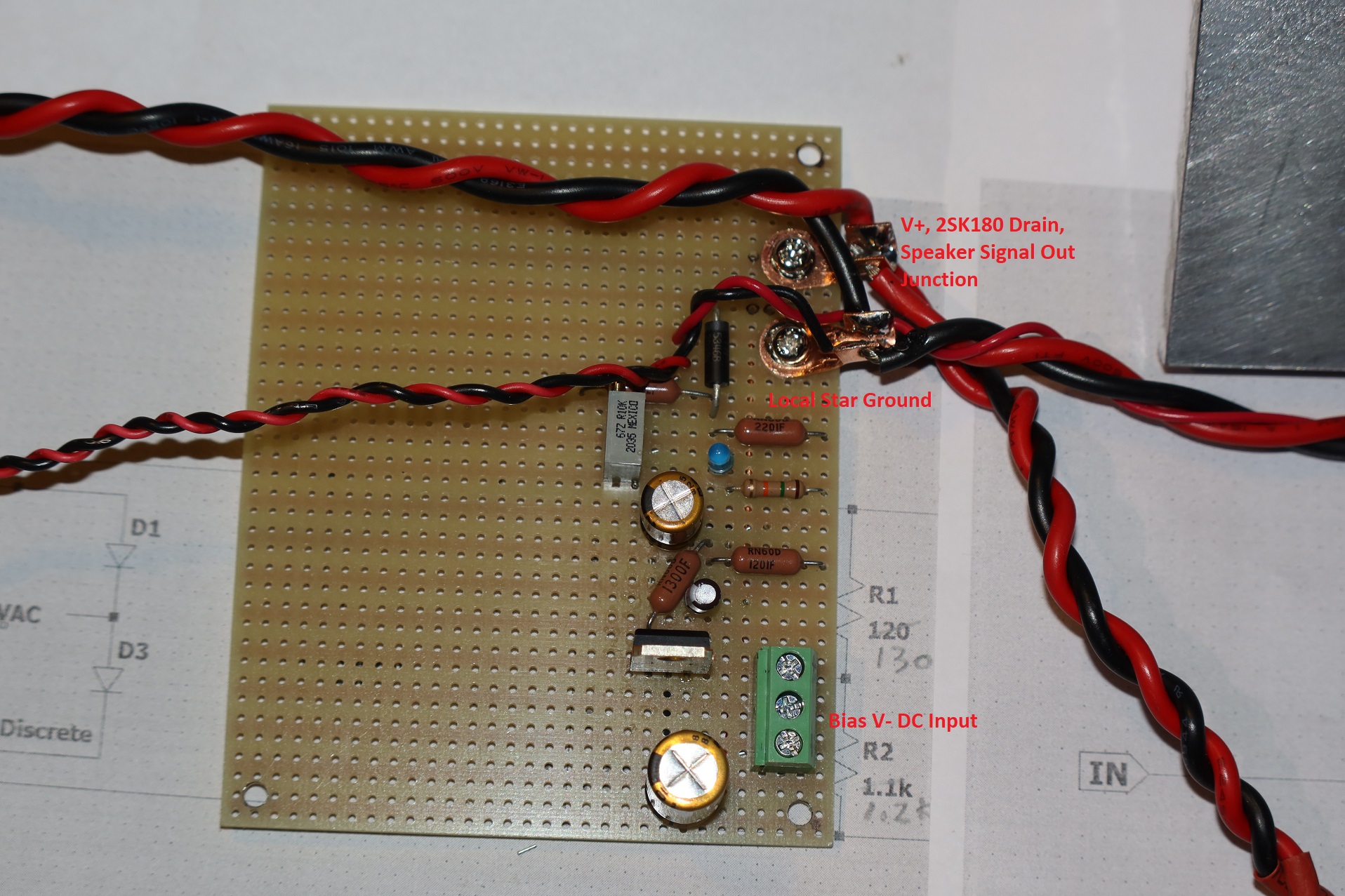

I have now built one preamp and five amplifiers (one shared bipolar supply, one single transformer with dual secondaries and dual unipolar supplies, one dual mono single chassis, and two pairs of monoblocks) and they are all quiet when powering my speakers. It took me a while to figure out what worked for me.
Things that I do to minimize system noise are as follows:
1. Plug everything into one wall AC outlet.
2. Keep all powered components close together and bundle all AC power cords together and much as possible.
3. Use some sort of ground lift device, whether rectifier bridge or thermistor, to connect audio ground to chassis safety ground.
4. Keep AC wires and power tranformers as far away as possible from audio circuitry and wires. For stereo chassis, AC wires are routed down the centreline of the chassis, and power transformer located at the front of the chassis, so transform EMI is located as far as possible from audio signals, especially low level input signals.
5. Rotate tranformers to find orientation of lowest noise.
6. Minimize loop areas of electrical circuits. For outside of the chassis, points 1 and 2 above are done with that in mind. Within the amplifier chassis, twisting all wires that form loops are done.
7. Monoblocks and dual monos are easier to make quiet because cross channel ground loops are not an issue. But as I have mentioned, I have built one amplifier with a shared power supply and with a bit of work I managed to make it quiet powering my speakers too. I followed the hifisonix recommendations.

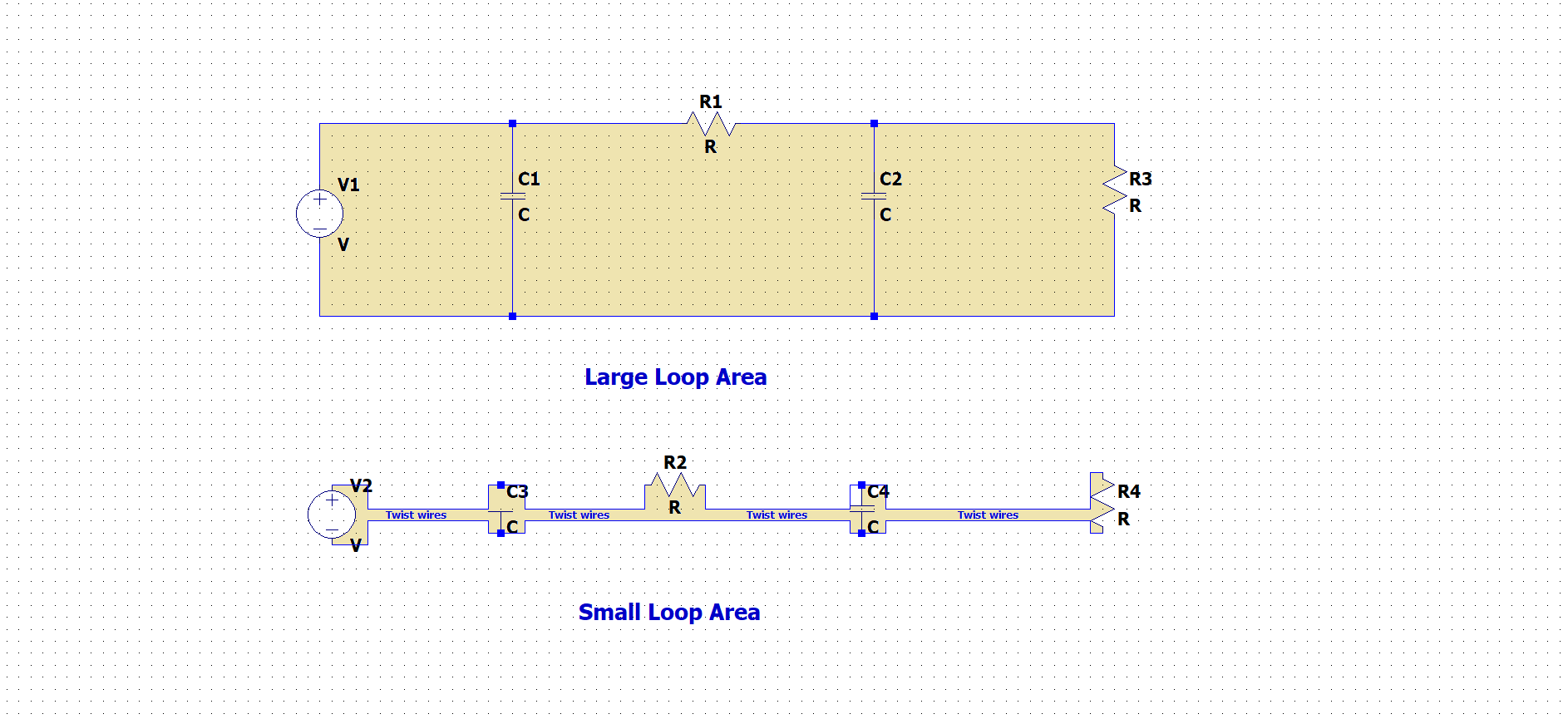

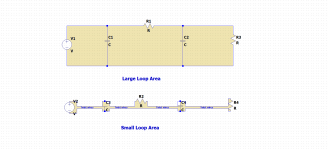

I was unfamiliar with loop areas when I first started out hum busting. Basically electrical circuits are closed cicuits where electrons flow in continuous loops. An amplifier can have multiple loops, and each loop has electrons flowing continuously within that loop. For instance, one loop is the AC power loop. Within the chassis, this loop starts at the IEC jack, continues through the tranformer primaries, and back to the IEC connector. Within this loop would be the fuse, on-off switch, and soft start thermistors or soft start circuitry. Another loop would be the DC power loop, starting at the transformer secondary to the bridge rectifiers, CRC or CLC filters, to amplifier circuit and then returning to the CRC or CLC filters, bridge rectifiers, and transformer secondaries. Yet other loops would be signal input jack to amplifier circuit and back to input jack, and speaker positive connector to audio circuit and back to speaker negative connector.
For each of these loops the aim is the make the loop area physically as small as possible. If wires in a loop are physically separated and components in the loop are physically separated, the wires and components that form the loop create a large loop area. If wires and their returns are twisted together and components within the loop are located as close as possible to each other, then their loop area is minimized. See example below.

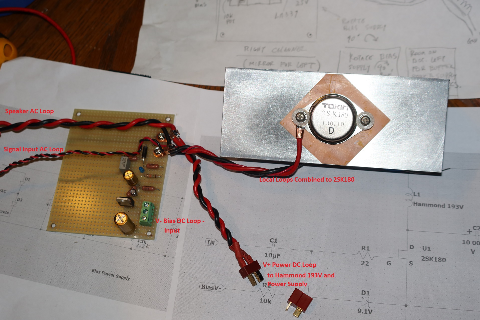

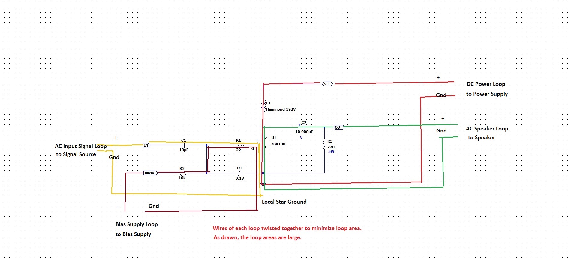

So in each monoblock there were four loops in the audio circuit, in addition to the AC power loops from IEC jack to transformer primaries. Wires in each loop were twisted together. So if you look at the picture of the amplifier internals, all wires are twisted except for the transformer shield wire to chassis ground, power supply ground in series with thermistor to chassis ground, and ground from the IEC jack to chassis ground.
In the speaker loop, I purposely took the speaker negative from the audio circuit board to minimize the loop area. I know that some builders take the speaker negative from the power supply board negative. However that makes the speaker-out loop area large, which is not what I want.
So this is what I do to make my amplifiers as quiet as possible. The sound of silence. Then the sound of music. Peace and quiet when the song ends, and no annoying hum during quiet passages.
